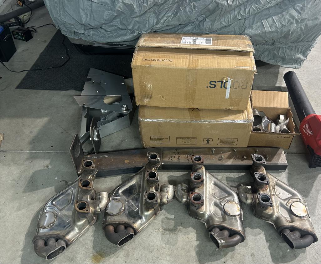

I have been dragging my feet doing these but got a good start this morning. This is a hard process to quote that’s for sure as it is straight up custom. I run this set up on my hot 2.4 with 1.5” sleeves and they work really well. A good solution all the way up to 3.6Attached Image

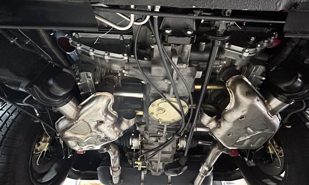

@MB911 - Ben, can you post an installed picture with them hooked up? Do these flow better than your original, large-tube SS heat exchangers? Will they bolt up to a stock banana muffler? Thanks and Happy Thanksgiving, Michael (IMG:style_emoticons/default/beerchug.gif)

Here is the prototypes on my car. Do they glow more I would no probably not. They are unequal length but 1.625 OD just like my old sets. They connect to a stock muffler that’s the idea. Attached Image

@MB911 do the open ports in your pic get a hose from the engine blower fan? Left open? How is the power and heat? Some people live in cold climates...

lol I live in Wisconsin you don’t think it gets cold here? Basically the factory ports are shrunk so a standard hose will fit . I then cut a new opening for the heat valves and it works perfectly. It was 40 degrees the last time I was out driving and toasty in the car no problem

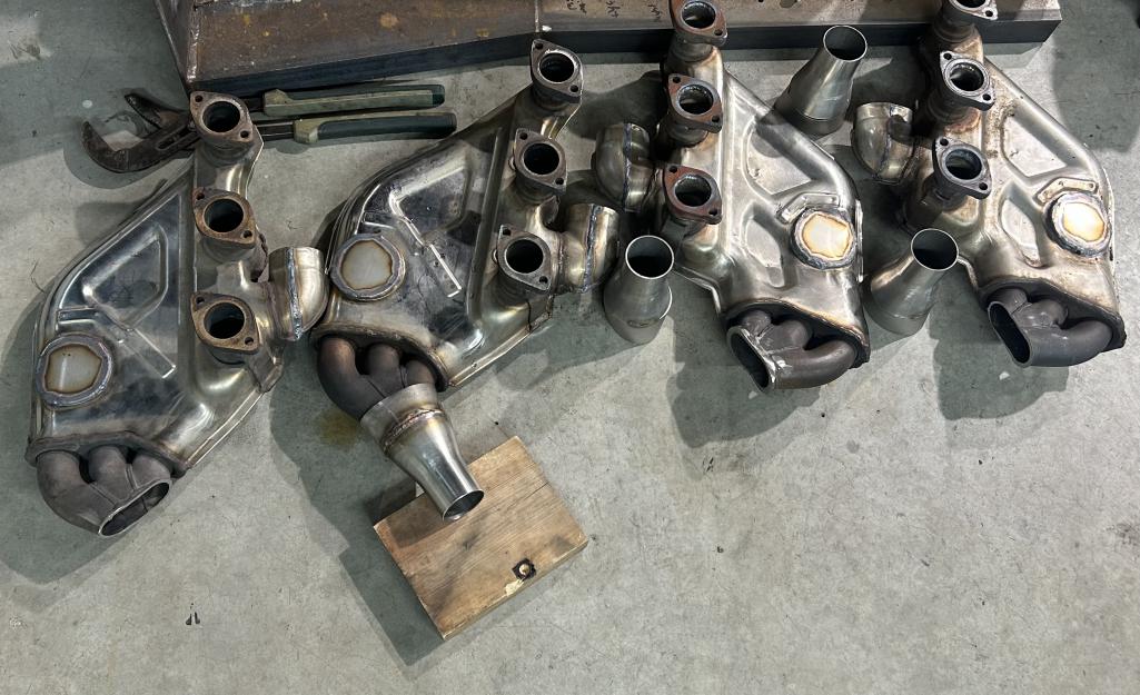

Starting the adapters. Attached Image

Gotcha. Will be adding those ports next.
