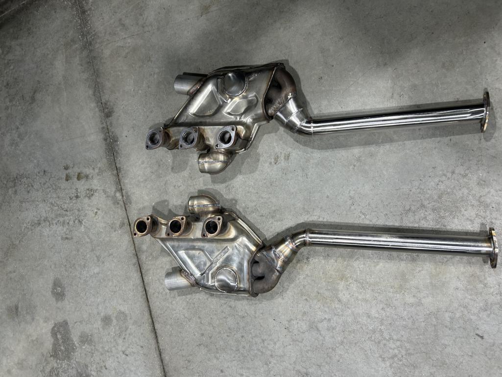

Jesus, those are beautiful Ben. You always knock it out of the park. (IMG:style_emoticons/default/beerchug.gif)

QUOTE(Cairo94507 @ Dec 20 2024, 08:09 AM) *
I am trying. They could use to be glass beaded that would make them look great

Beautiful Ben. Now I wish I had a 3.6L. Best, Mark

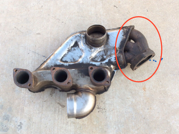

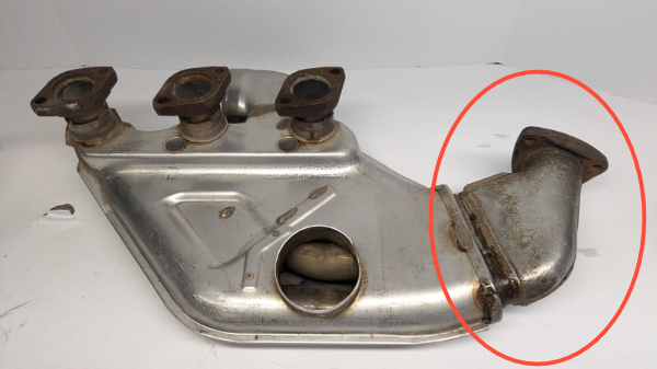

What is the difference between the Gillette and the Bischoff 993 heat exchangers? How can I tell what my '95 3.6 had? (IMG:style_emoticons/default/beerchug.gif)

QUOTE(Cairo94507 @ Dec 21 2024, 10:24 AM) *
@Cairo94507 ,
Bischoff
Gillet
Ken

Thanks for the pics of both styles!
Makes it easy to see why Ben chose to cut the flange off.
It's not a huge angularity change but it does get rid of 10-20 degrees of bend TWICE!
Now, from those pics I'd be prone to want to use the "Gillet" version over the other.
It looks like the individual runners might be straighter at the collector (hard to see this in the pic) and the first added section from Ben might be already there on the Gillet.
To me it looks like the Gillet version would be easier to do...

@saladin - Thank you very much. Ahhh... now I see. Yes, I agree, the Gillette version seems to be the better version. (IMG:style_emoticons/default/beerchug.gif)
