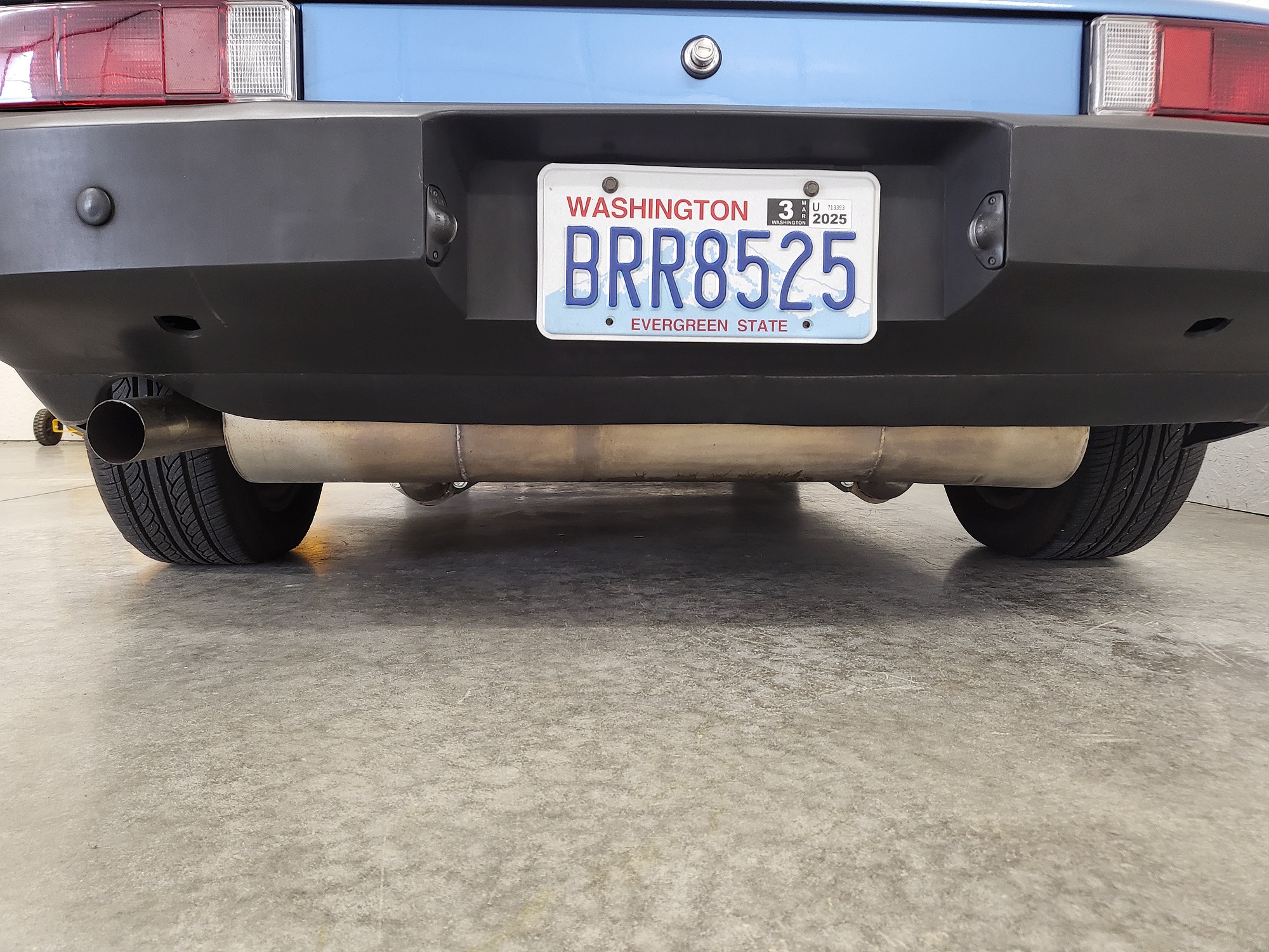

Ben's Quiet Muffler ( I did have to reclock the tip as it was more for 1974-up 911):

Took the 914 out and ran some baseline numbers using a DB meter:
Ben's Quiet Muffler:
Idle outside - 80
Idle inside - 70
30mph - 78 4th gear
60mph - 86 5th gear
70mph - 88 5th gear
All runs were engine warmed up, windows up and maintaining speed. No acceleration or deceleration.

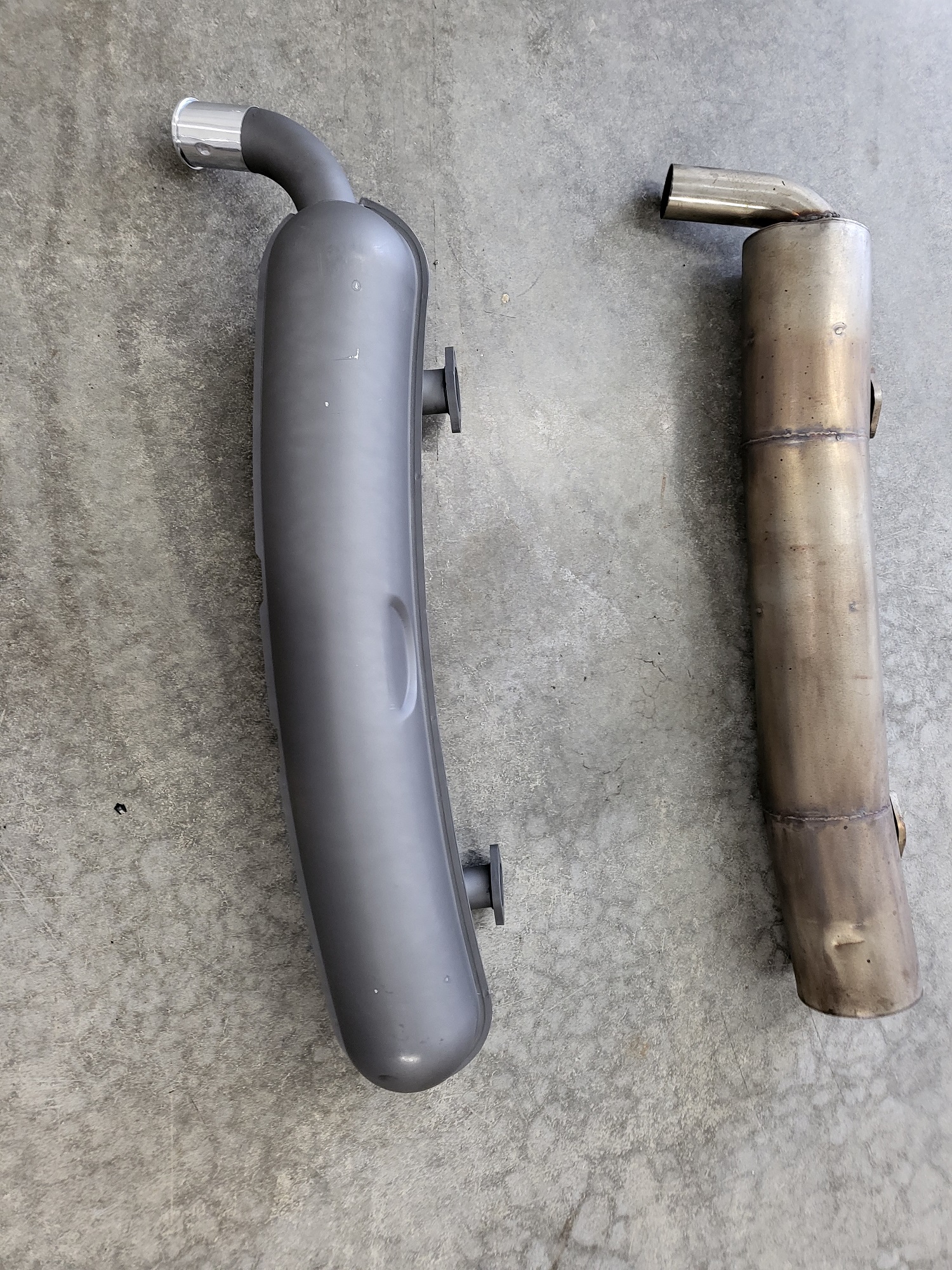

Pulled the SS muffler and prepped to install the new Dansk muffler I've been sitting on for 10 months:

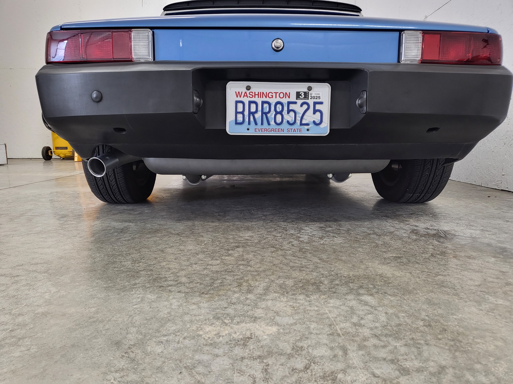

Ran the same tests as close as I could, same stretches of road and highway, windows up, same gears etc.
Dansk muffler results:
Idle outside - 80
Idle inside - 67
30mph - 77 4th gear
60mph - 85 5th gear
70mph - 87 5th gear
As the DB goes, not much of a difference by the numbers. Although I could tell on the freeway the note was toned down a bit.
Was it worth it? Eh, probably not. Not really much of a difference in overall cabin noise and I gained back that 5-6lbs right on the tail of the 914 (Dansk is heavier than SS).
Not sure if I'll swap back to the SS or not. I do like how the Dansk is hidden a little better.
