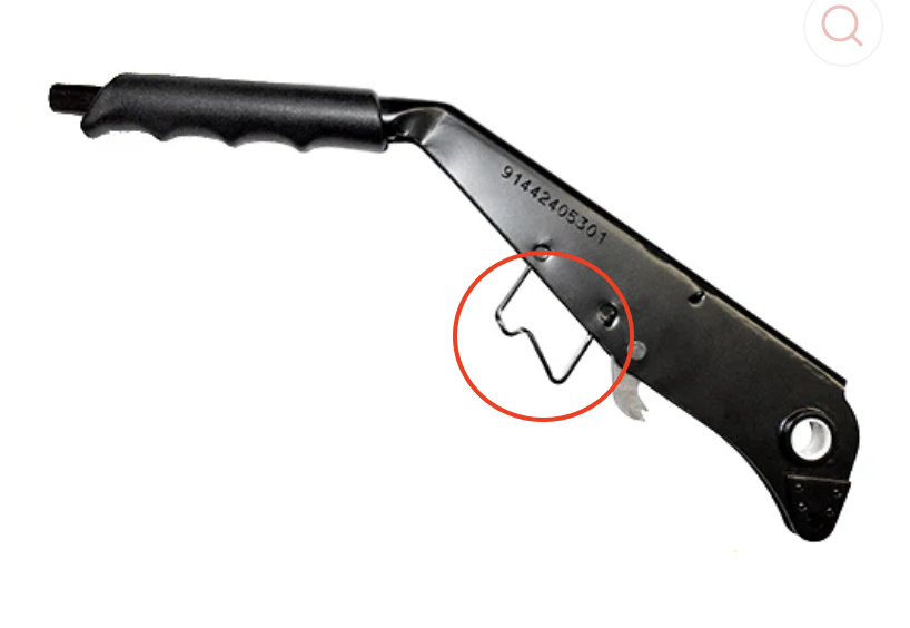

The switch is activated/pressed on by the circled part in this pic.

70-72 have the older style parking brake handle which has a Pivot in the middle to make it easier to get in and out of the car. The part that triggers the parking brake look different. I modified mine with an adjustable screw that triggers the switch.

ahhh, yes -that pic I posted is for later cars - apologies. I now see we're dealing with a 71.
