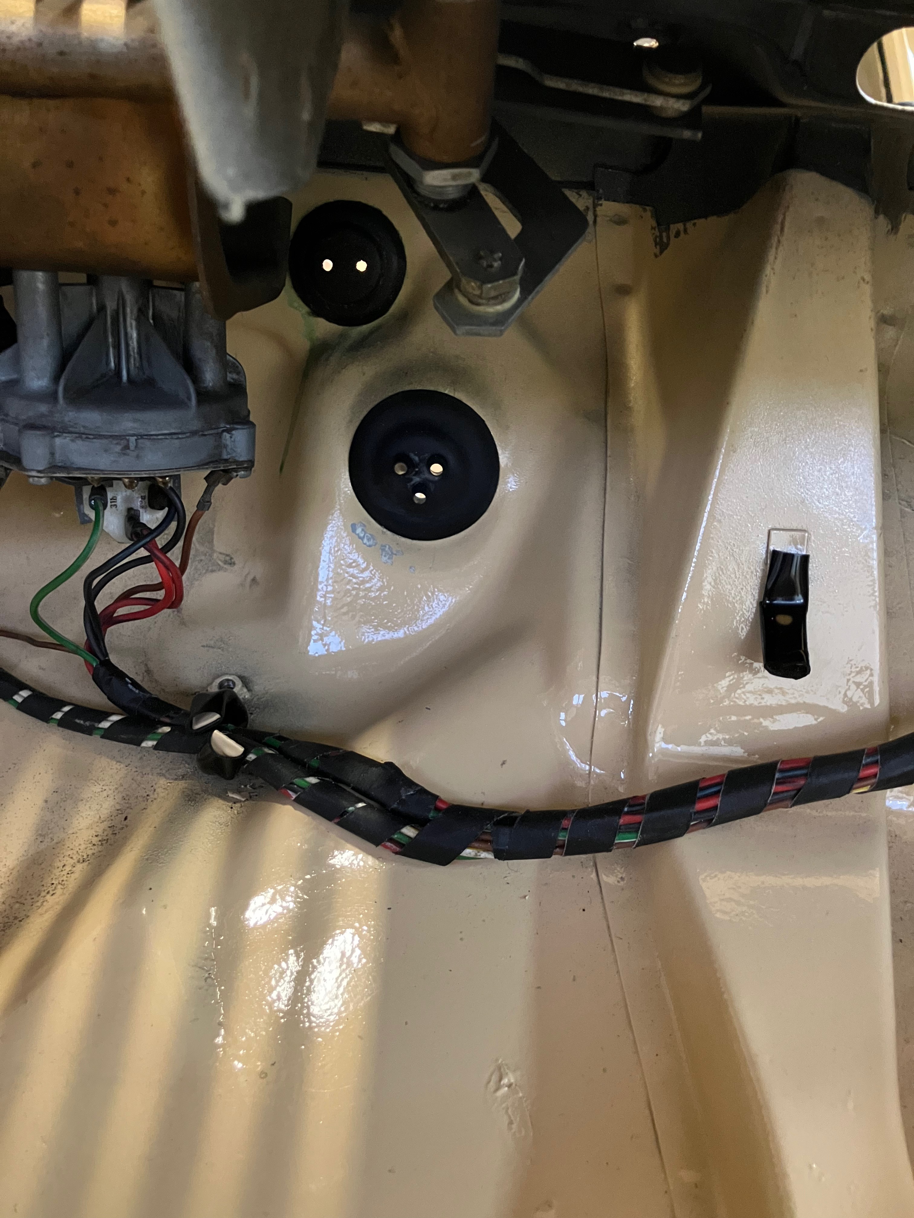

Does anyone have a trick to install the grommet that allows the three "Bowden cable" heater controls to pass through the interior bulk head to the heater control box located in the gas tank area?

SUCCESS!! I am able to put this part of my project to closure. What worked: placing the grommet in boiling water for 10 minutes to soften, silicon lubricant and sheer brute force and determination. With the hood in place, it makes it awkward to gain a good purchase to work the grommet into position but was doable. What didn't work: the suggestion of the dental floss failed as it broke on first pull. Thanks to all who offered assistance and to the 914 World Forum Attached Image
