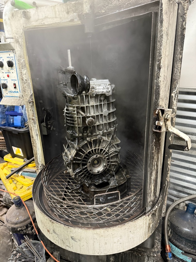

Spoke
post Dec 10 2024, 03:07 PM
Post #34
Jerry
Posts: 7,432
Joined: 29-October 04
From: Allentown, PA
Member No.: 3,031
QUOTE(930cabman @ Dec 10 2024, 12:18 PM) *
Side note, how is progress with your 930?
The transmission is being worked on now. Here it's getting a cleaning.
Going to clean up the harness and send to Dennis (Timmy2) to have a new harness made.
Removing the air injection port to the cat for the emissions system. The pump and valves are long gone.
The internals of the cat have partially melted. Found several molten chunks in the muffler as well.
Port welded up.
Next step for me is to do a bit of welding on the tins then transfer all the parts to Mark's shop for eventual assembly.
