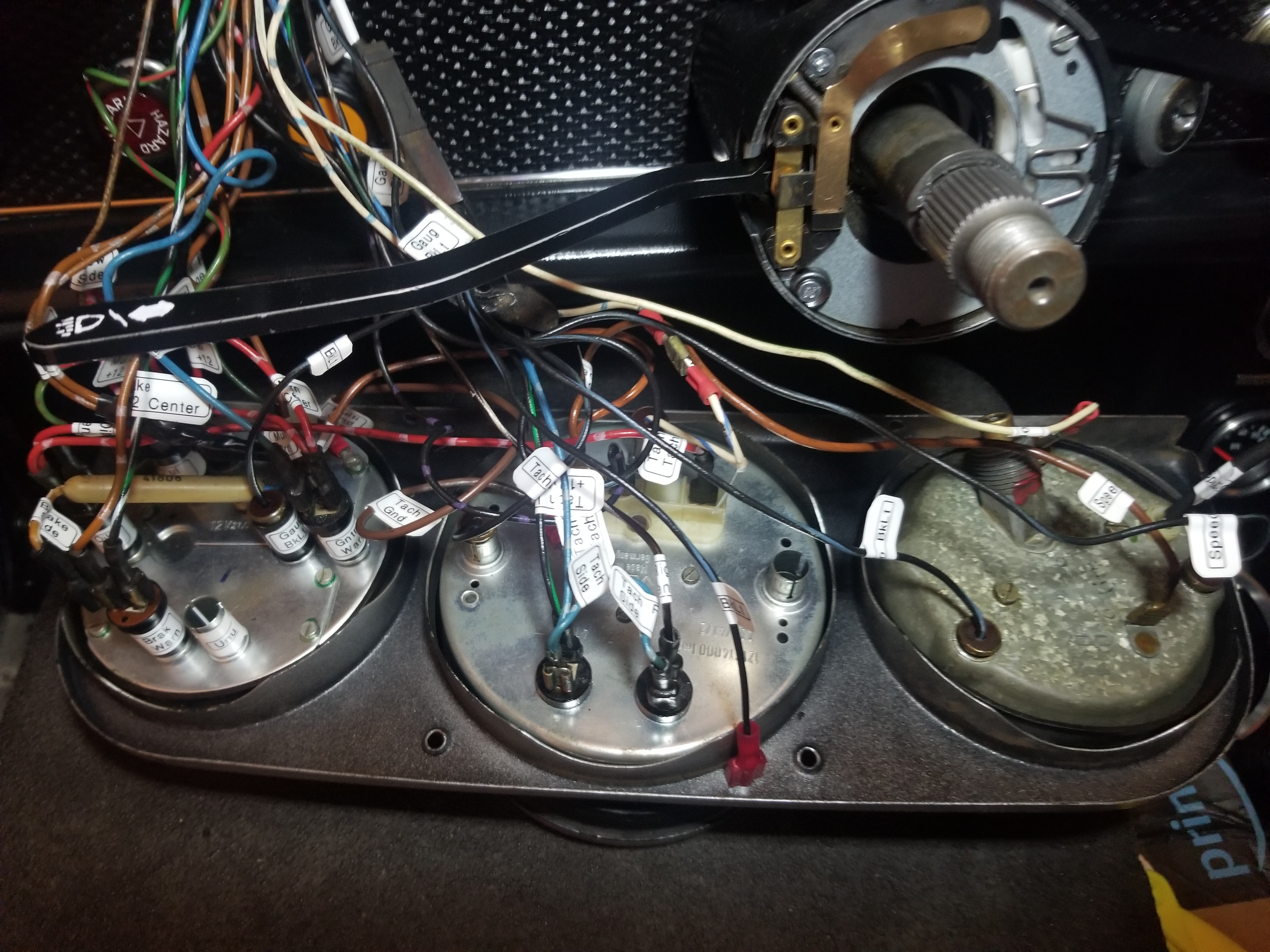

I spent all day labeling gauge wires and burnishing contacts.
That is some neat and tidy labeling. How did you make those?

Brother P-Touch labelmaker.

Better labels.

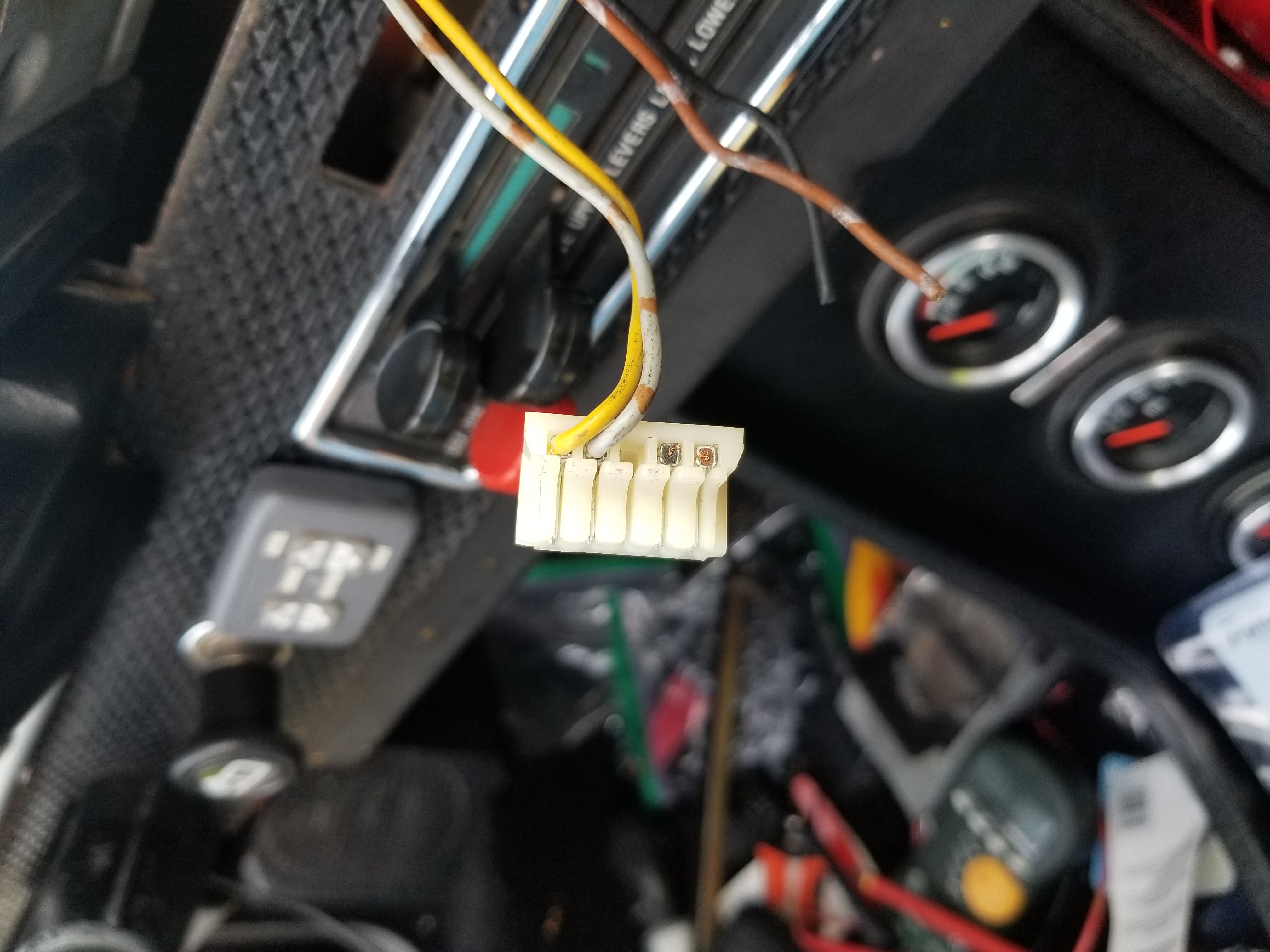

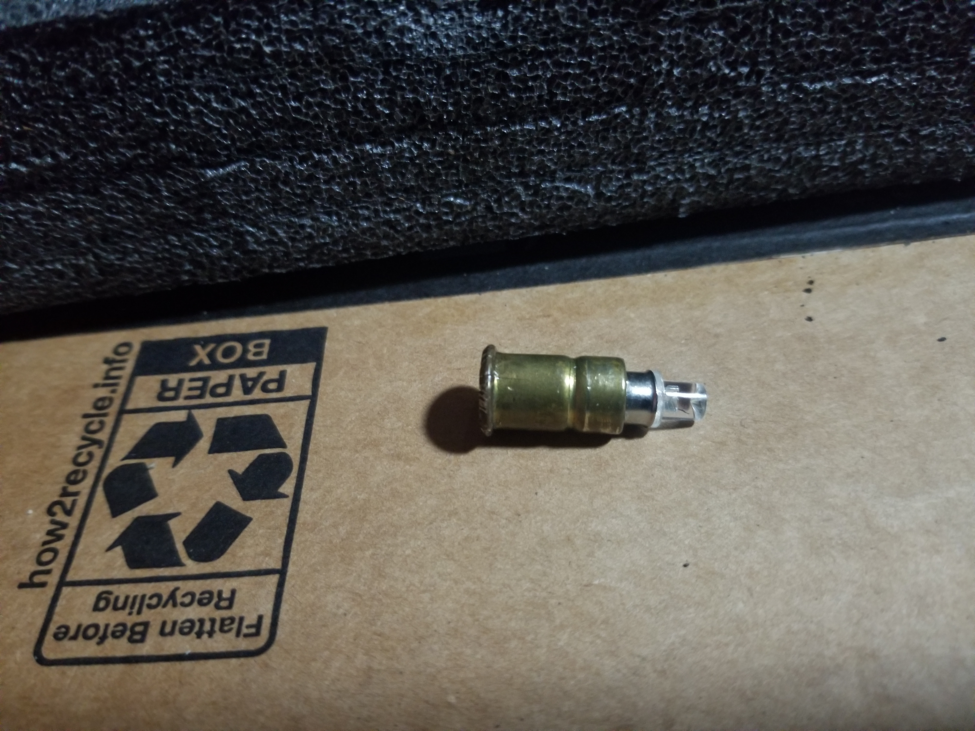

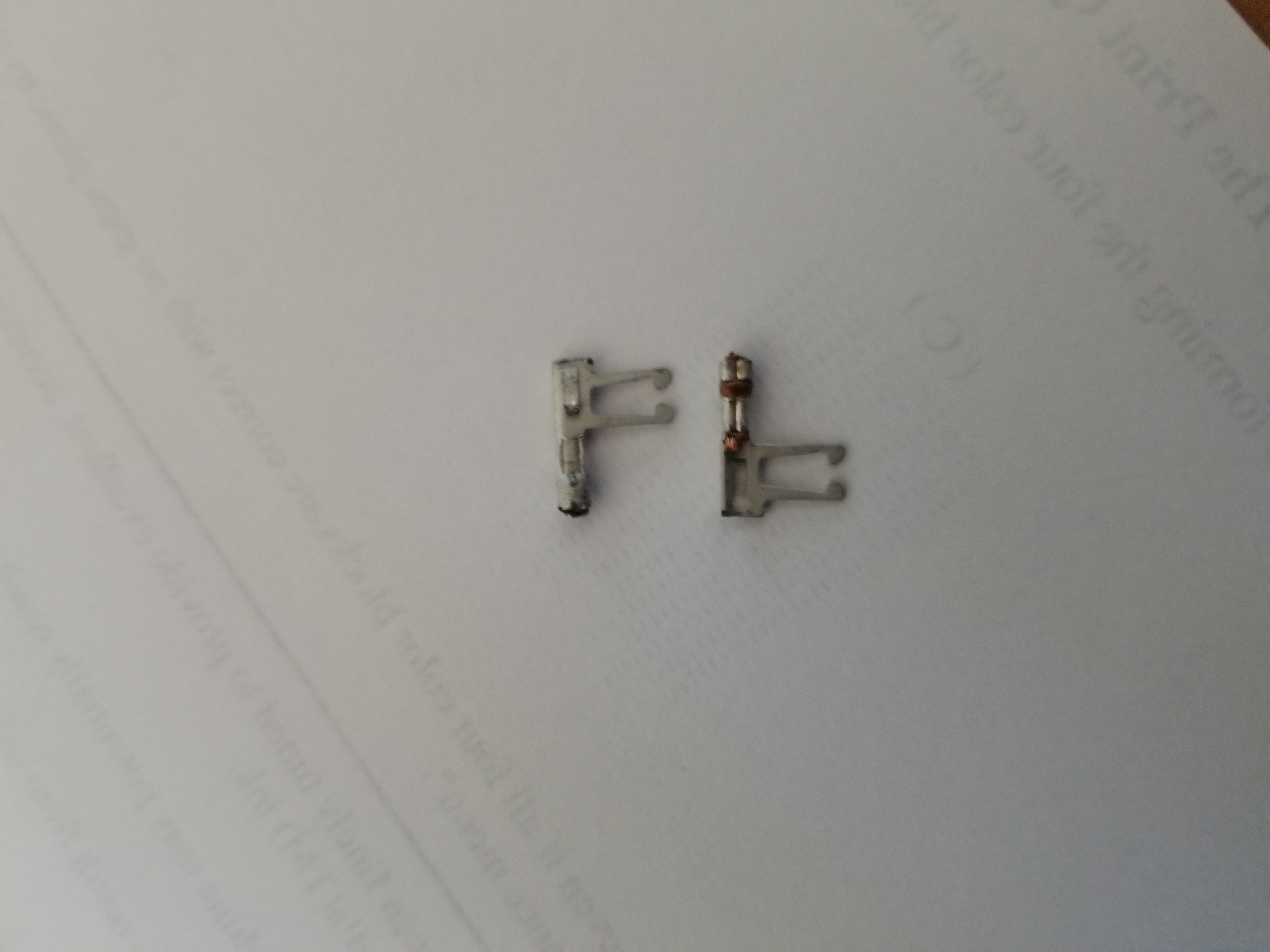

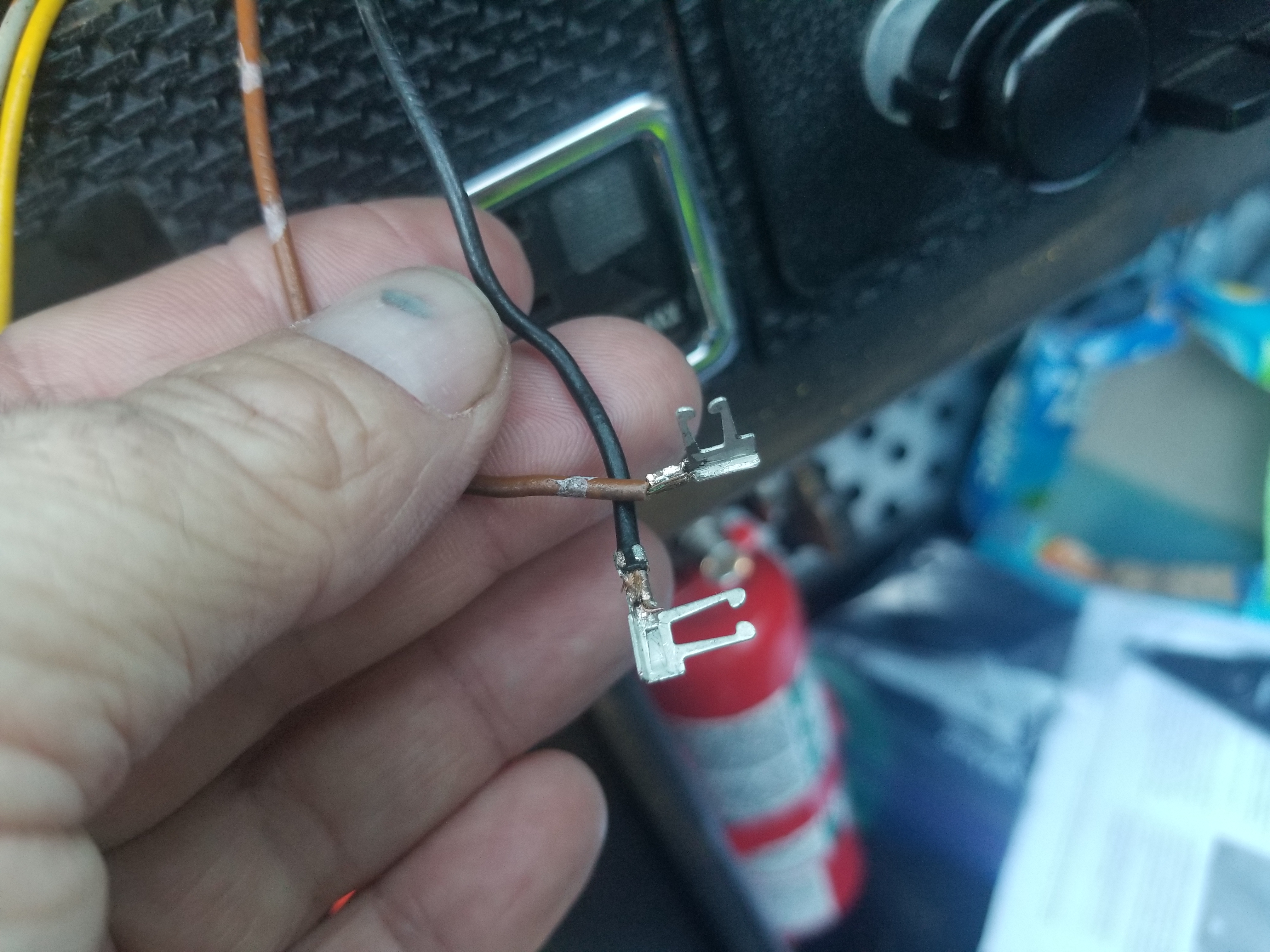

busterphysic
post Jan 8 2025, 10:01 PM
Post #28
Posts: 38
Joined: 2-November 24
From: Santa Rosa, CA
Member No.: 28,444

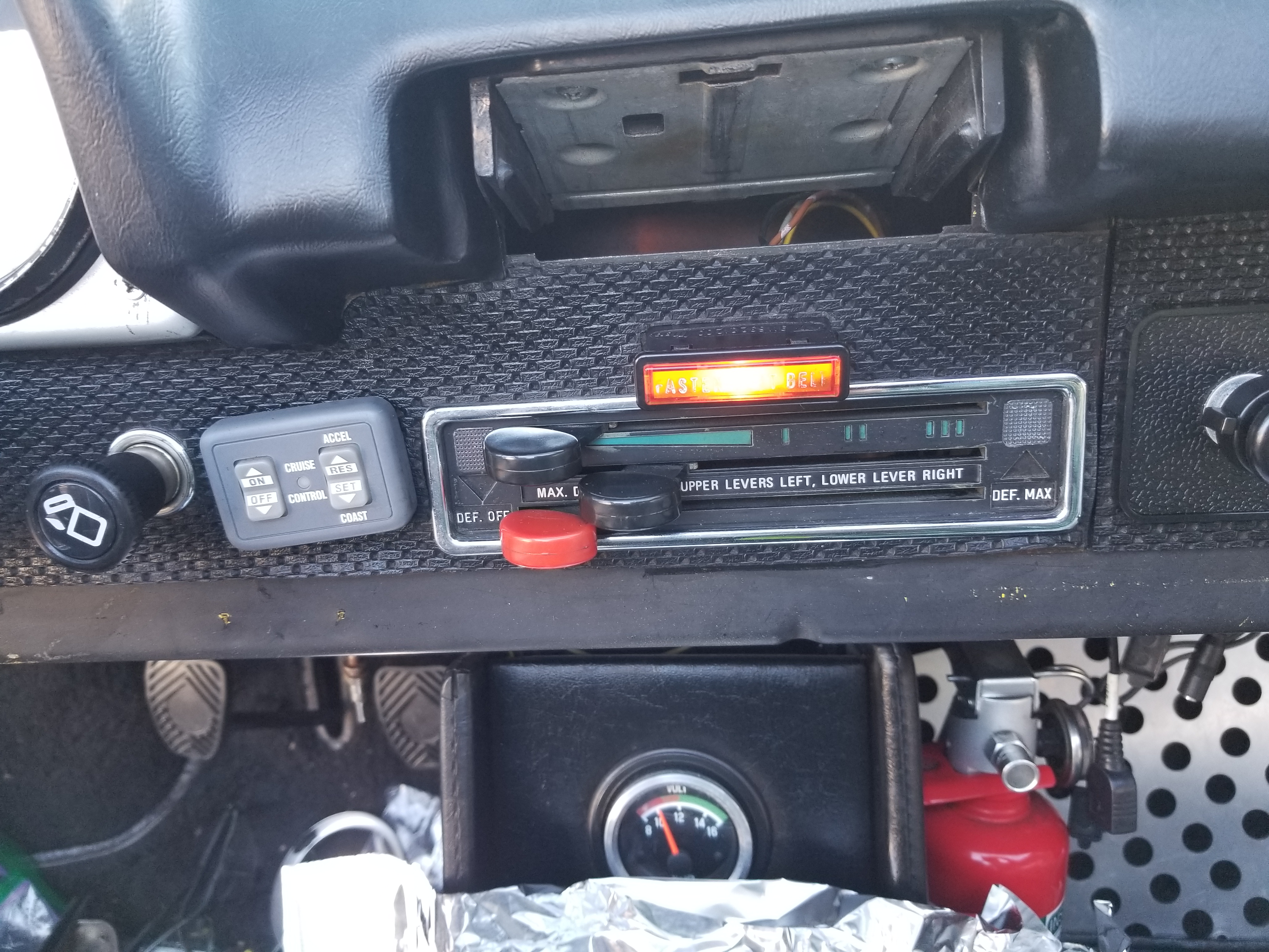

Yay, I got the "Fasten Seatbelts" light working!!!
I needed to repair the wireing harness conector at the light
and swap the seatbelt buckles, passenger for driver.

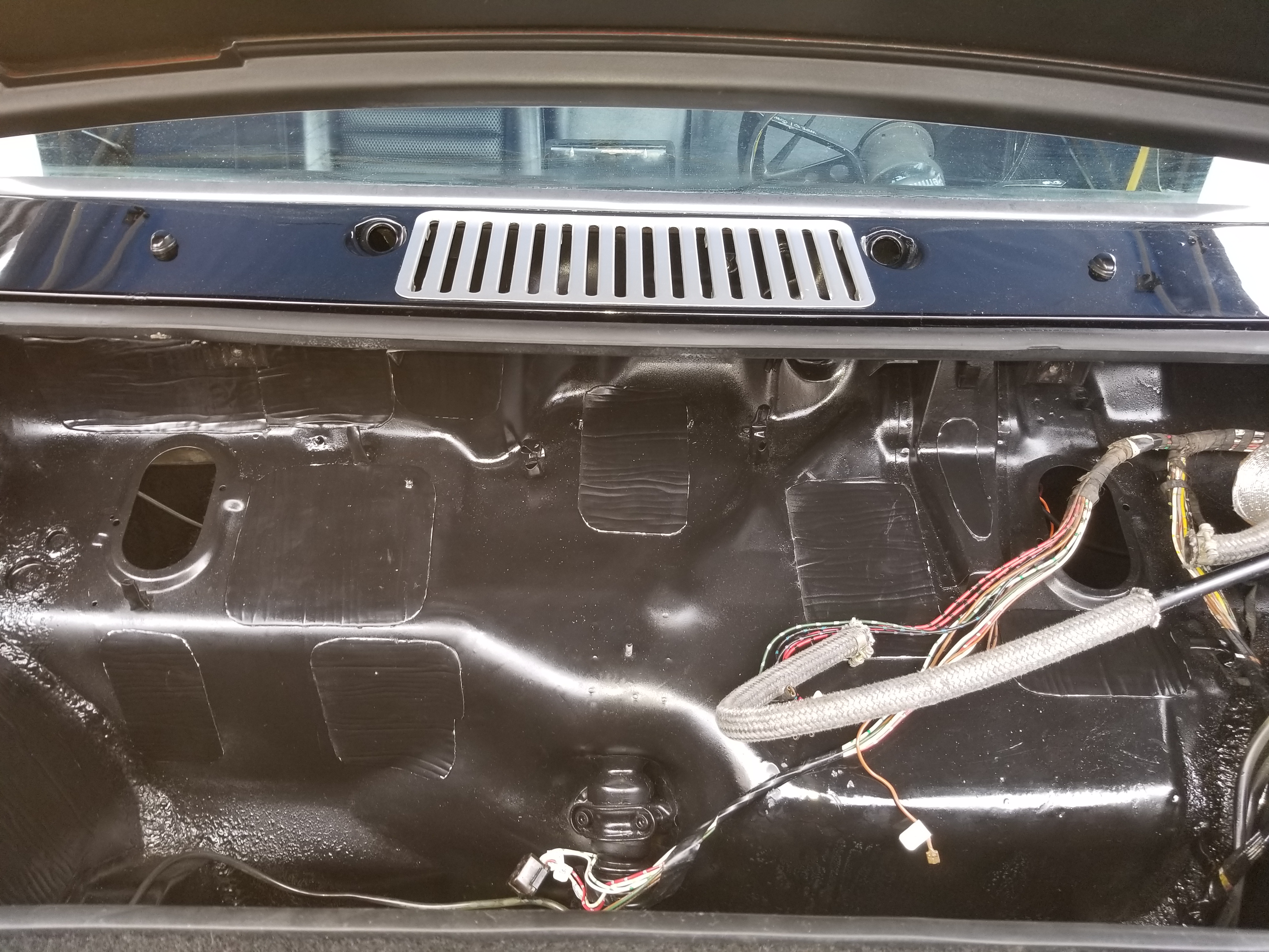

busterphysic
post Feb 11 2025, 05:46 PM
Post #37
Posts: 38
Member No.: 28,444
I put 6 sq-ft of B-Quiet in the fuel compartment.
Now I can start reassembly!Attached Image
VaccaRabite
post Feb 11 2025, 05:59 PM
Post #38
En Garde!
Posts: 13,845
Joined: 15-December 03
From: Dallastown, PA
Member No.: 1,435
Uh-oh.
You may regret the sound deadening in the fuel compartment if you intend to put the air box back into the front to work the HVAC controls. It may not fit with the added width of the sound barrier.
Getting the air box back into its nook is a CHALLENGE with just paint. It may not fit now.
Zach
914sgofast2
post Feb 12 2025, 09:23 PM
Post #39
Posts: 796
Joined: 10-May 13
From: El Dorado Hills, CA
Member No.: 15,855
I did not have any big headaches when I removed and replaced my car's fresh air box. If you remove the bolts from the support legs which connect the cowl area to the unibody underneath the cowl area, you can pull up on the cowl area when installing the fresh air box, and the fresh air box will slide in easily. My 914 is an early 1970 model year. Of course, the gas tank has to out of the car too.

post Feb 14 2025, 12:00 PM
Post #40
Posts: 38
Member No.: 28,444
QUOTE(VaccaRabite @ Feb 11 2025, 03:59 PM) *
Uh-oh.
Zach
Thanks Zach.
I just put BQ patches here and there. I hope in good spots!
- Dave
