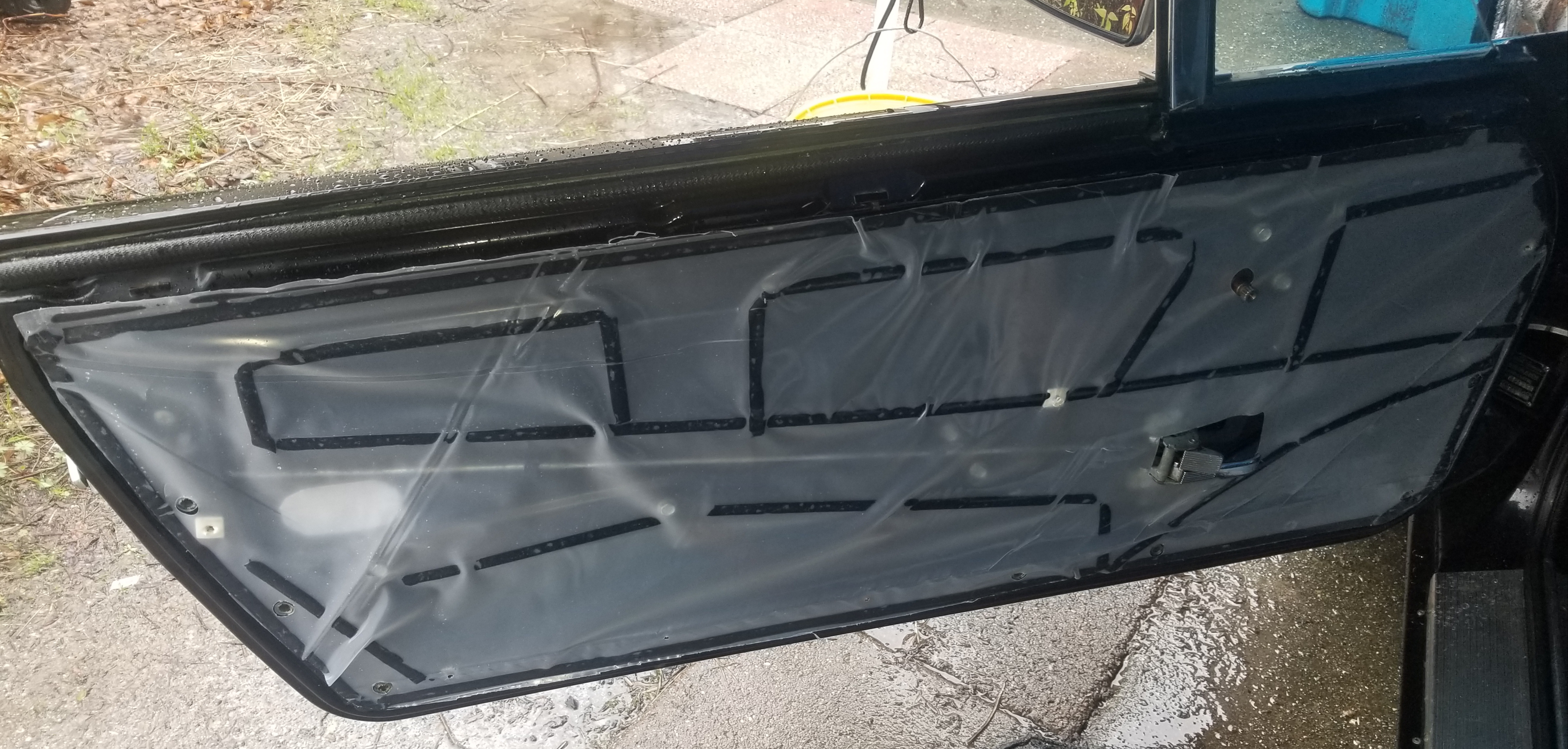

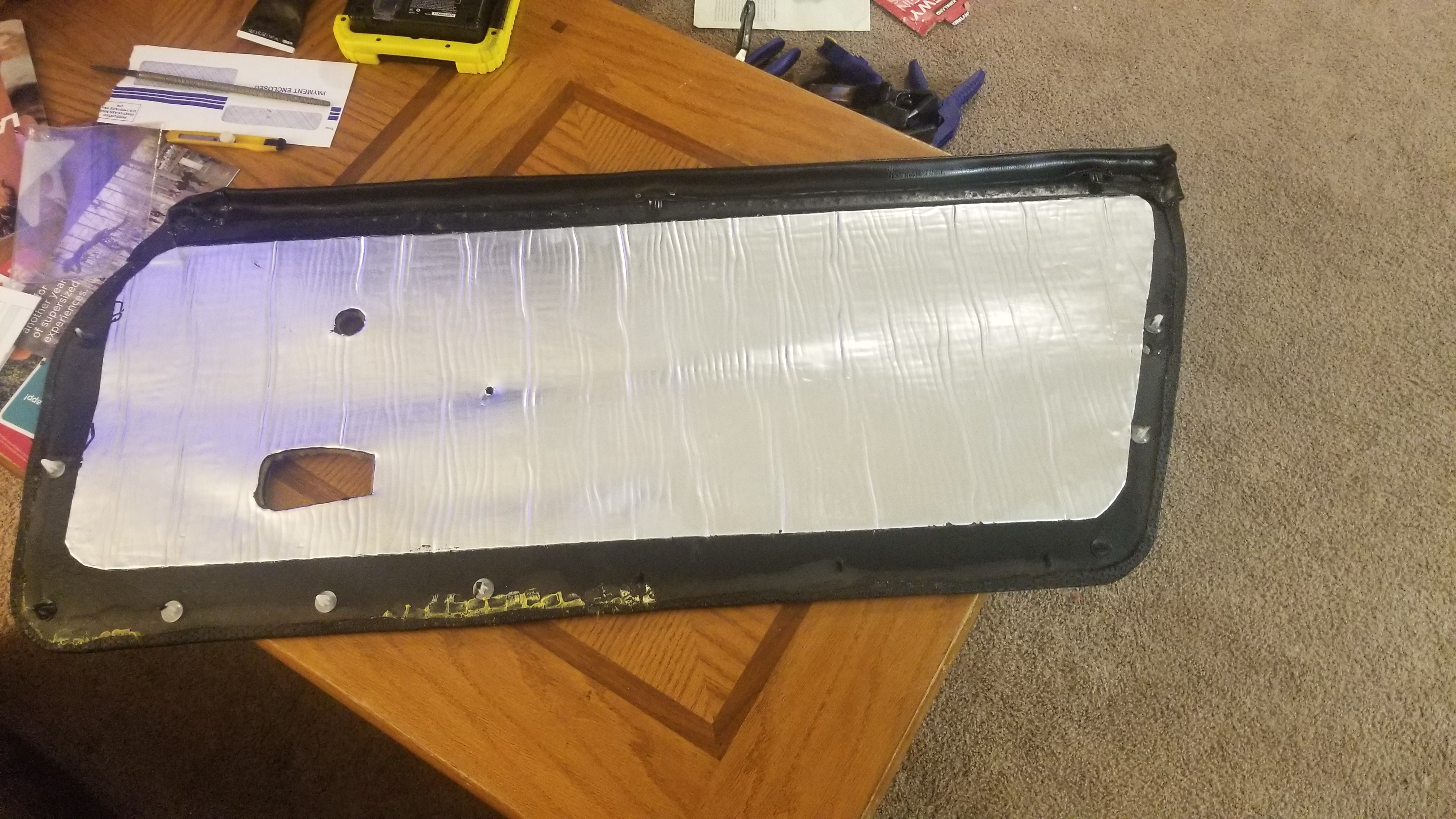

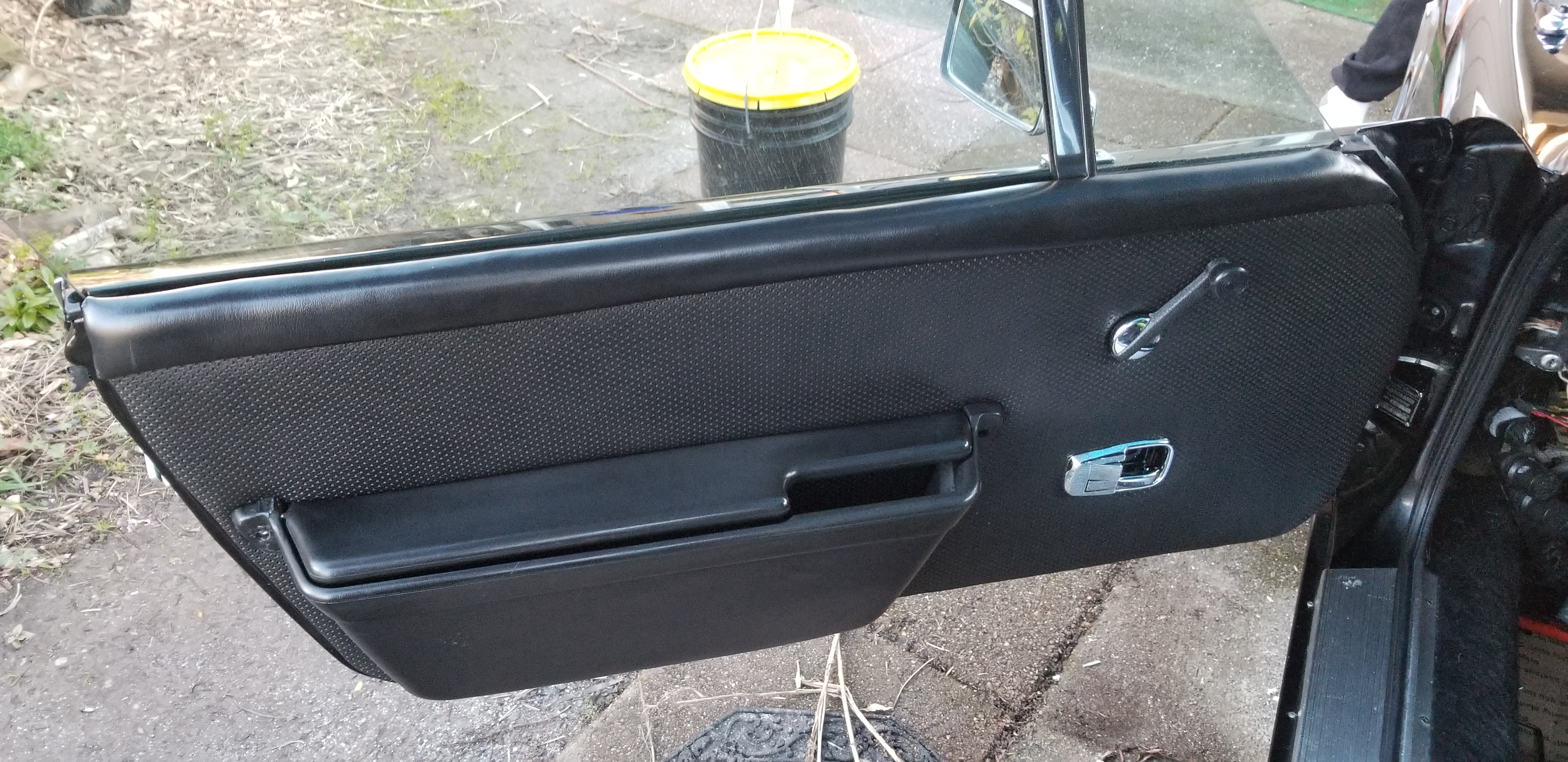

Closed up the driver's door today. It's been torn apart for a long time.
The return spring for its door latch broke around new year.
VW has the replacement spring. (PN 111837061C)
Cleaned, painted and lubricated inside the door. Applied 4-1/2 sq-ft B-QuietUltimate to the door and door panel.
busterphysic
post Feb 19 2025, 07:03 PM
Post #47
Posts: 38
Joined: 2-November 24
From: Santa Rosa, CA
Member No.: 28,444
Installed new vapor barrier.

Upgraded to chrome window cranks and interior door release rosettes.
Mine is a late '73, so, the OEM 113837581D 914 chrome cranks would not fit.
I found some from "356 Devotion" on eBay that do.
https://www.ebay.com/itm/323896424972
914rubber tells me their cranks fit too.

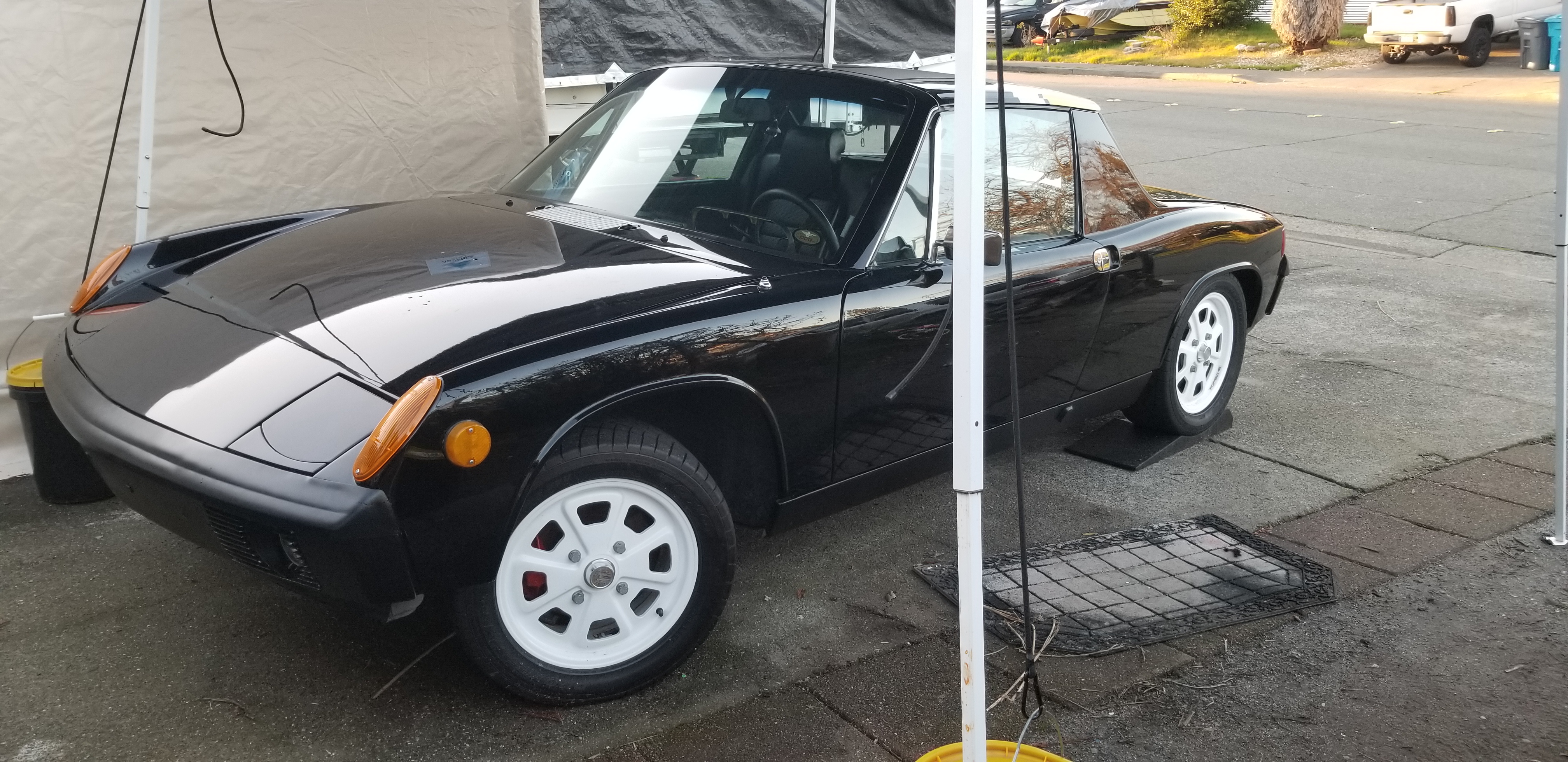

Polished wheel caps.

Call me crazy, but I really like the white Fuchs on that car.
(IMG:style_emoticons/default/hide.gif)
busterphysic
post Feb 19 2025, 09:03 PM
Post #51
Posts: 38
Member No.: 28,444
QUOTE(rjames @ Feb 19 2025, 05:57 PM) *
Tuxedo vibe!

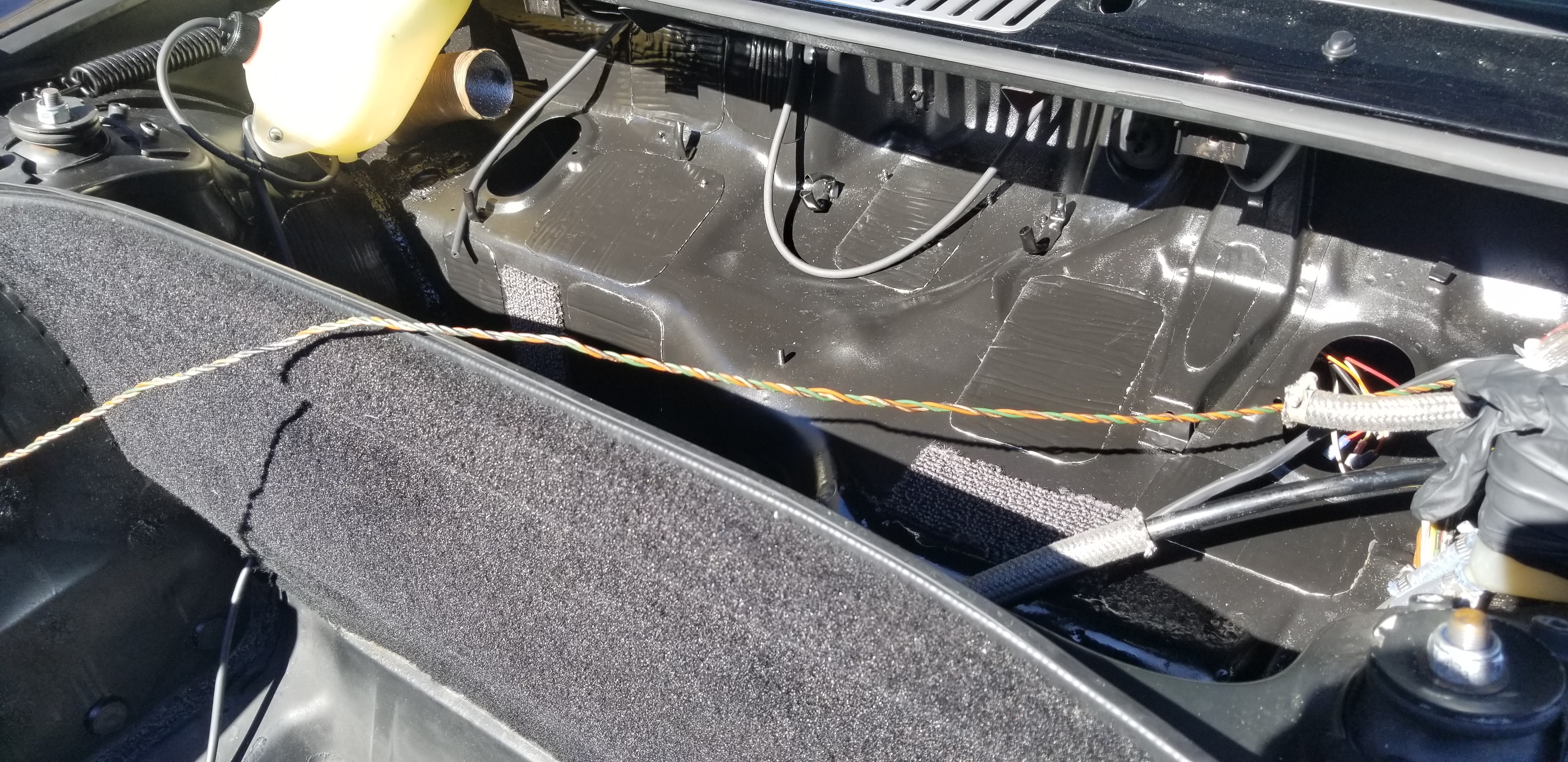

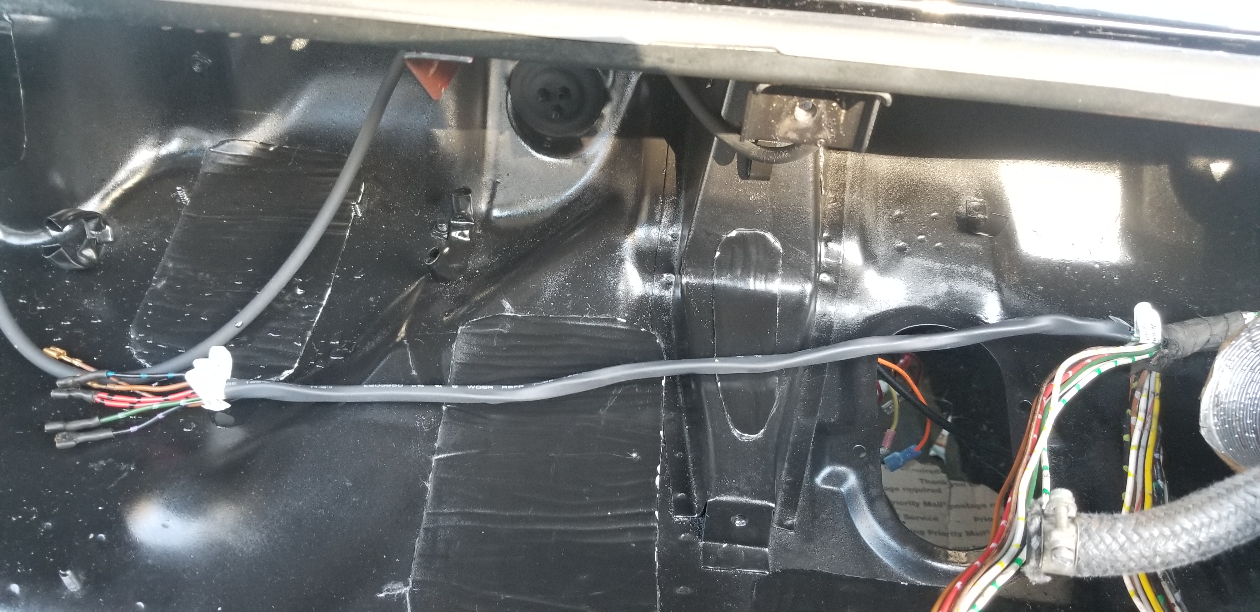

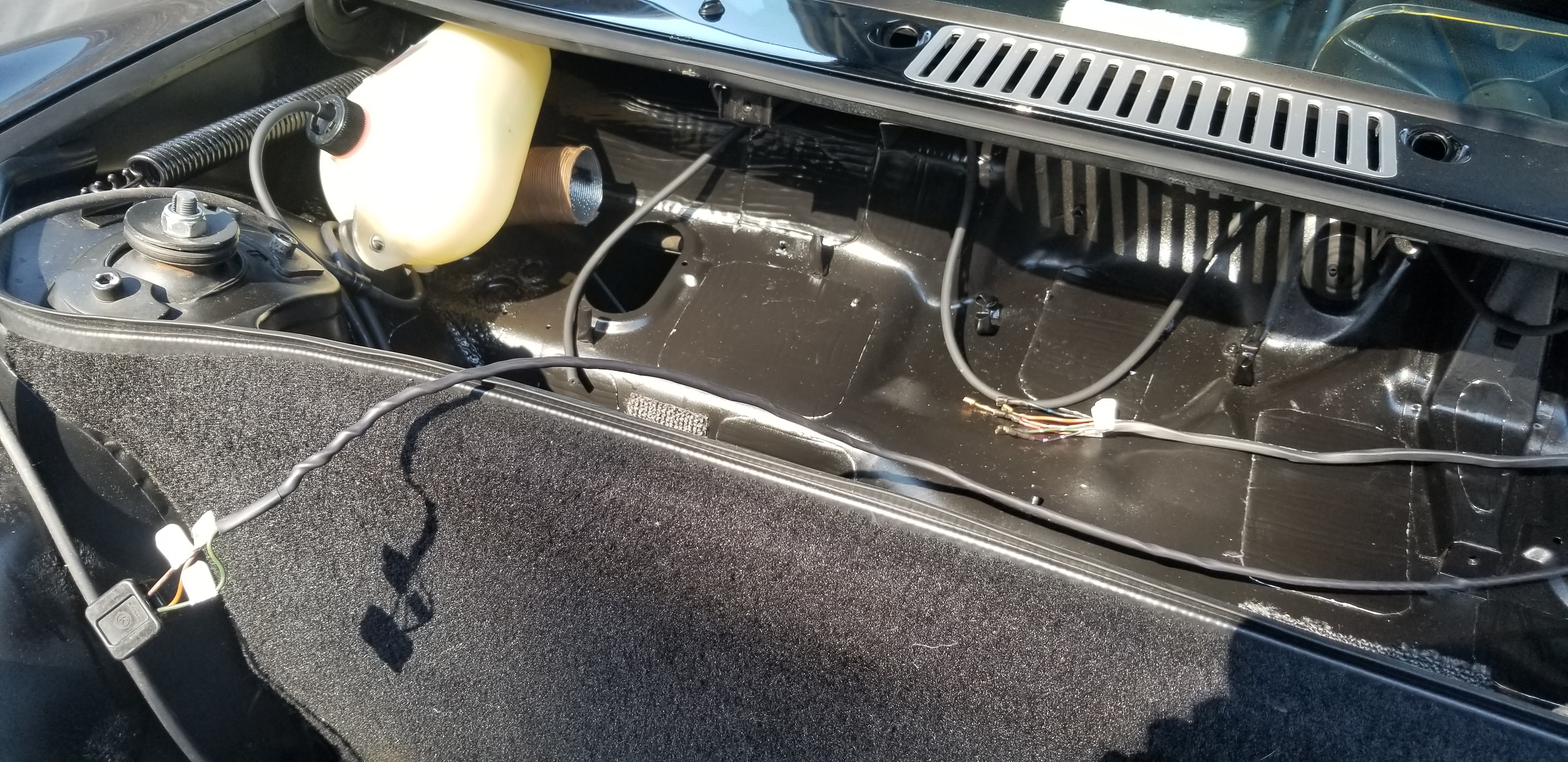

Hi all,
I'm shrinking tubing onto the free ends of my harness.
Should I twist the wires to suppress noise? I shrunk the wiper branch before thinking
of this.
I am twisting the fan branch and fuel gauge branch now that I have this in mind.
Should I redo and twist the wiper branch?
Any radio guys, EEs or other smarties
advice appreciated.
Thanks!
Dave
