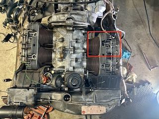

spencercanon   The valve adjustment oddity was that the rocker ar...   Dec 16 2024, 01:39 PM
Superhawk996   The valve adjustment oddity was that the rocker a...   Dec 16 2024, 01:45 PM

spencercanon   I dropped the engine back out and pulled the intak...   Dec 16 2024, 04:29 PM
technicalninja   SirAndy's post is rhetorical I guess. But the...   Dec 16 2024, 05:24 PM

spencercanon   Thanks again everyone for the responses. All my wr...   Dec 16 2024, 06:45 PM

spencercanon   It would be just like me to get the cyl numbering ...   Dec 16 2024, 07:30 PM

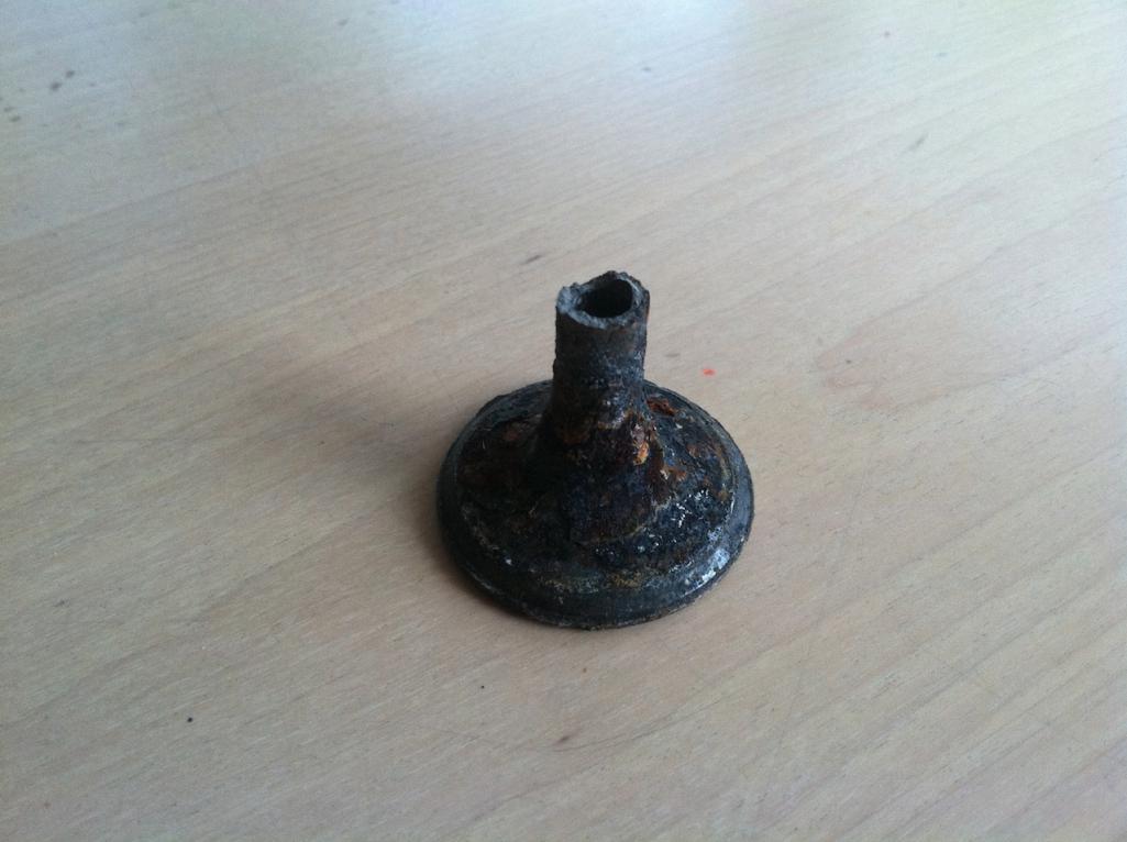

technicalninja   TLDR: Sodium filled valves are not inherently bad ...   Dec 18 2024, 10:04 PM
barefoot   TLDR: Sodium filled valves are not inherently bad...   Dec 19 2024, 09:35 AM
technicalninja   Barefoot, I'm in agreement! :agree: Than...   Dec 19 2024, 10:49 AM
VaccaRabite   I was not aware you could even GET sodium filled v...   Dec 20 2024, 08:19 AM
flipb   Inconel was created for spaceflight. I've got ...   Dec 20 2024, 10:42 AM
technicalninja   Inconel was created for spaceflight. I've got...   Dec 20 2024, 01:14 PM
