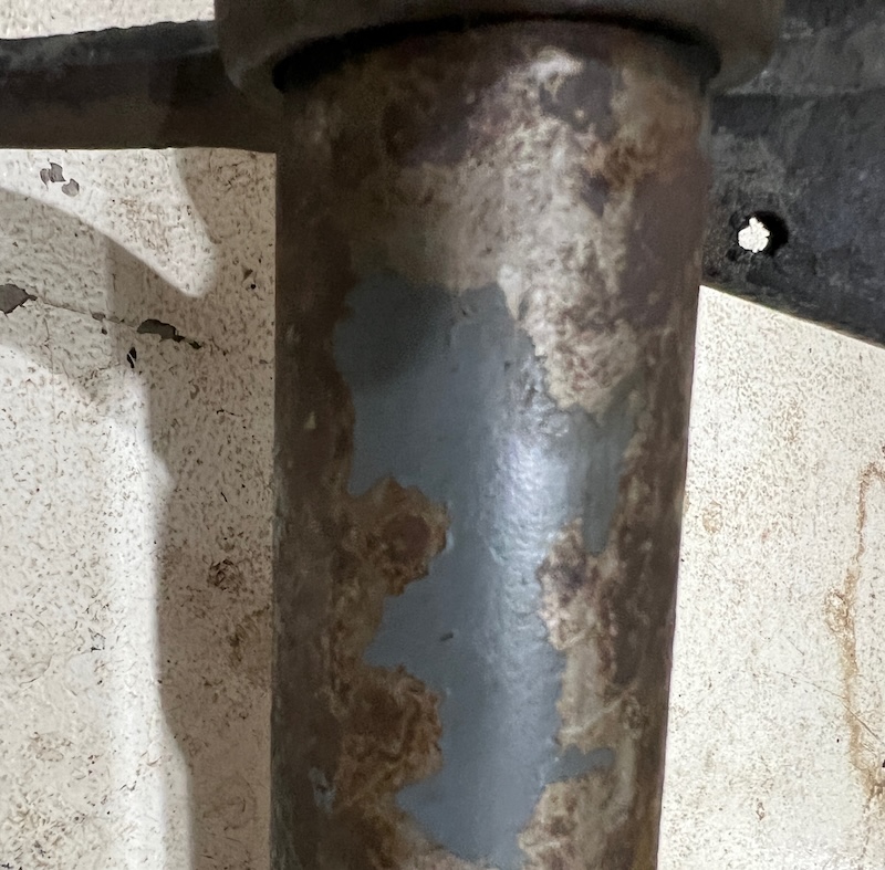

I am going off of what I bought from George at Auto Atlanta. Both front and rear were gray.
Perhaps worth noting, the front strut housing that came off our car was gray. Quite a bit darker when compared side by side with the color of the AA kit.

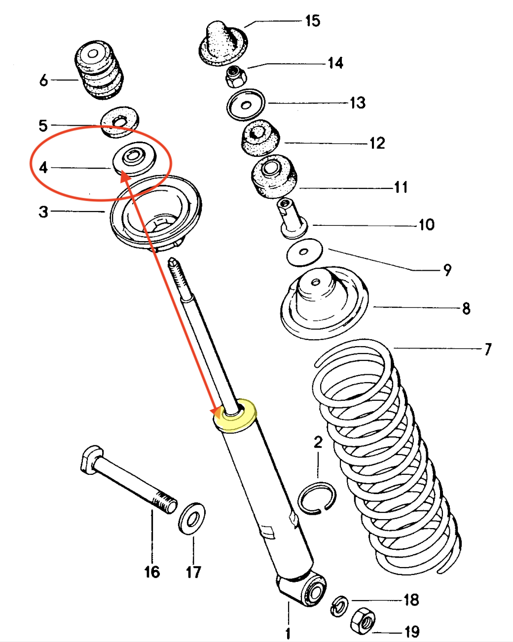

For anyone researching this in the future, I have put the NLA parts into the Parts Vault along with dimensions.
I think #4 is the only one outstanding as of this writing.

TL;DR
It doesn't appear #4 is needed as a separate part.
Long Boring Version
Because I obsess, I tried contacting more people on this part.
  • PCNA Classic Restoration Atlanta: Contact a dealer
  • Porsche Classic Restoration Dealer: We don't sell it, so we don't know anything about it.
  • PAG Classic Restoration Stuttgart: No reply at all. No reply at all.
I went to High Performance House in Redwood City to get a 356 part, and took a print to show Rich. They have quite a bit of 914 stuff. He said I'm looking for something I don't need. That the "cap" was in fact part of the shock itself.
