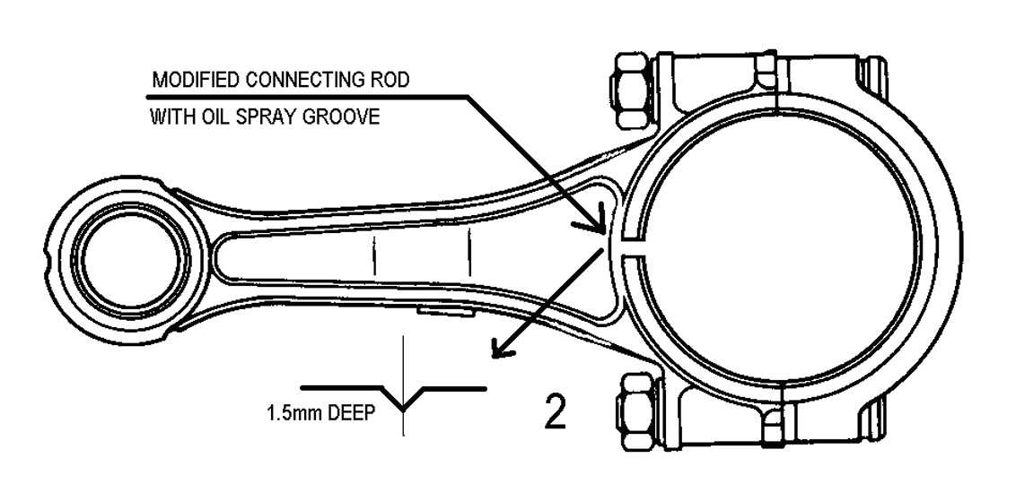

QUOTE(friethmiller @ Jan 6 2025, 12:59 PM) *
QUOTE(cgnj @ Jan 4 2025, 11:19 AM) *
Since we are all spending your money, oil spray groove for rods.
Is this necessary on non-stock, H-Rods? Curious where this "v groove" is actually made. The diagram is a bit confusing, IMO. Anyone have a picture of this modification done on a rod?
This is pretty interesting as a poor man's oil squirter straight from the factory. Does anyone here have any further information on the effectiveness of squirting via a clearance notch at each side of the rod and rod bearing?
Cheers,
Paul

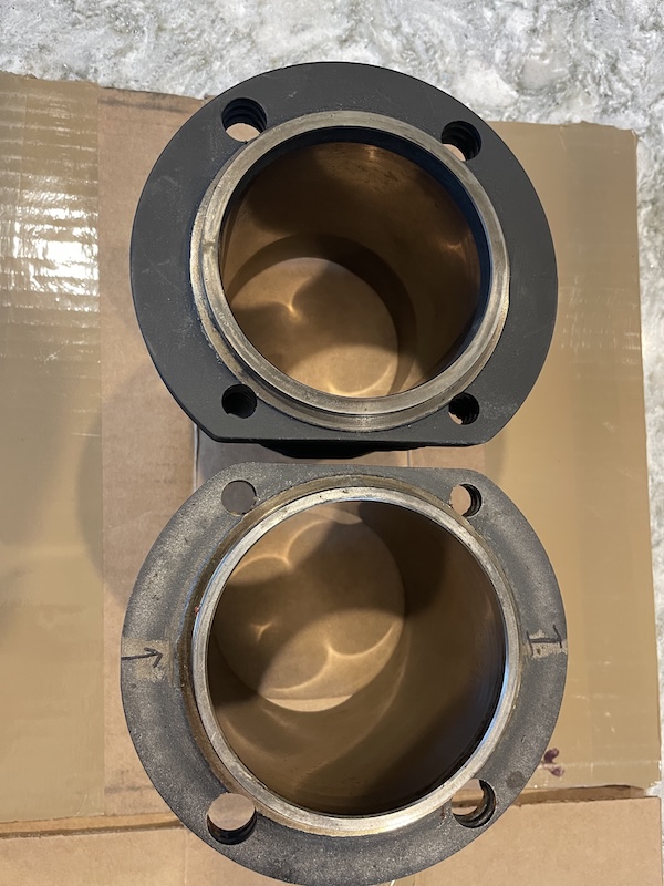

Curious. I checked the wall thickness between my German 93mm and my aftermarker 96mm cylinders.
Wall thickness:
96mm = 4.5 mm
93mm = 6 mm
This makes sense with +3mm boring. That's why the larger pistons (>96mm) need head work. They must use the entire top of the available cylinders sleeve. Not sure how they get the head bolts to clear. It must be very close or the cylinder is relieved to provide room. (IMG:style_emoticons/default/confused24.gif)

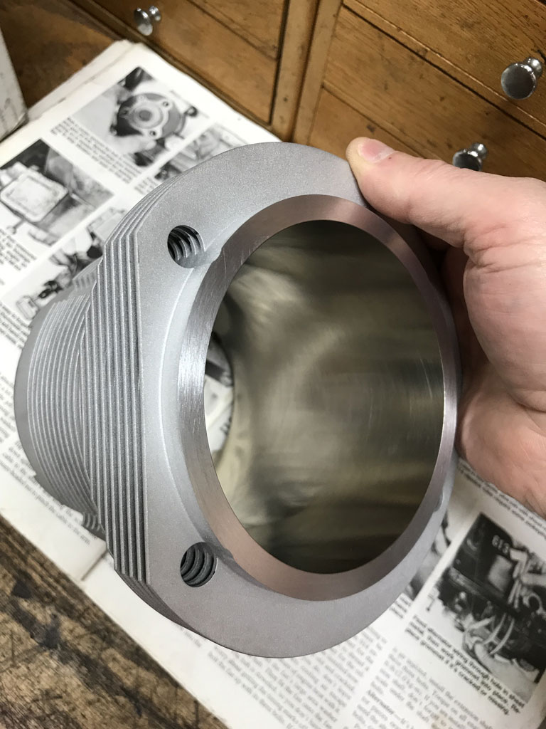

Here are 100mm Nickies you can see head stud relief

QUOTE(Superhawk996 @ Jan 16 2025, 10:00 AM) *
Just a wee bit! (IMG:style_emoticons/default/biggrin.gif)

QUOTE(Superhawk996 @ Jan 16 2025, 11:00 AM) *
all good information, what is the wall thickness with these?
I am sure Jake (and others) have researched this topic, cylinder wall thickness and have found a number to shoot for.

QUOTE(930cabman @ Jan 16 2025, 01:54 PM) *
In storage but I’d guess about 6-8mm. But they are aluminum. Steel is stronger and could be very thin (like 1-2mm) and resist cylinder pressure, the problem is that at thin sections the steel can’t resist thermal deformations and keep a cylinder straight and true. Likewise as the wall thickness decreases, you’re going to have sealing issues at the head / cylinder interface.
It’s pretty well documented 96mm is the upper bound for bored OEM cylinders. Both by Porsche via design (at 94mm) and the decades of real world testing of those that tried to go larger but did so at the expense of reliability. Likewise, tons of reliable engines at 96mm.
Why play Russian roulette trying to bore OEM larger than 96mm?

Jake Raby mentioned that 96mm was the "limit" on torque/or HP (might have been misdirection on Raby's part- I believe I've noticed misdirection in other posts of his) without dual spark plugs (which sounds like a PIA to deal with).
What I'd like is 96MM bores in thicker wall cylinders that doubled/tripled the contact with the head.
This WOULD require boring both the head castings and block for the larger OD jugs.
This is how all of the big bore stuff is done.
That skinny ass contact area between a stock OD 96mm bore cylinder is one of the MAJOR weak links in this engine in my book!
