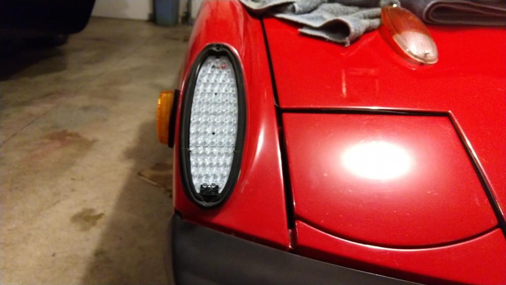

You could always go LED and just drop these boards in. No cutting, no crimping.

QUOTE(Spoke @ Jan 8 2025, 09:42 PM) *
And you can actually see them. Spoke LED’s are the way to go.

I confess I did consider that LED system, since they are VERY visible (and that's the whole point of turn signals (especially when you are only 48 inches tall, so to speak and surrounded by big, mean hunks of pickup and SUV metal!). However, I thought I'd try to stay with the OEM type system (perhaps a mistake, upon further thought). We'll see how things go once the new housings arrive.
I do note that there was some comment about having to match the LED boards electrical feed on one's car at their website but I forget what the specific context of that comment was at the moment.

If you have any questions about installing, Jerry/Spoke not only sells the product, he developed and built it. He knows all the tips and tricks to make it work.

I have Jerry's (Spoke) LED's in all of my lights. Literally took me 30 minutes to install all of them and be done. No install issues at all. (IMG:style_emoticons/default/beerchug.gif)

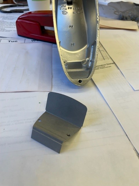

If you continue to get a product you don't like, I can sell you a laser cut, CNC press braked part.
Pete

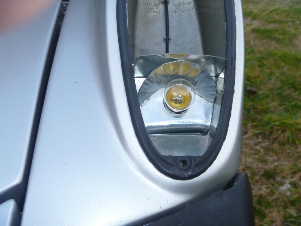

Wondering how good the alloy is as a reflector ? ,the shitty cheap plastic ones that AA and Camp 914 used to sell had no reflector ,my set got binned for that reason, this one wire type will need to be a good fit so they earth properly to the housing , I would suggest a separate earth wire would sort it that's what I did .

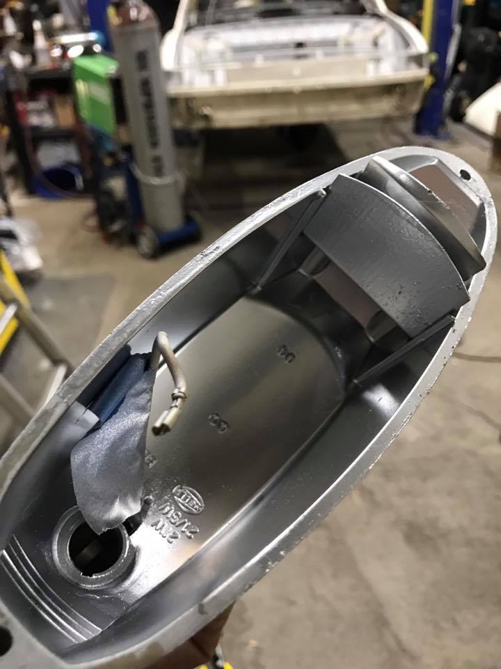

Got mine from a vender member on here but don't think he makes the parts anymore but my pic shows a proper reflector and fitted easy and worked 100%, the only thing I did was to drill the light housing to fit the cast in pins of the housing ,these units are a tight push fit into the housing ,nice and bright during the day which is big safety consideration IMO.
IMO this guy made the best handmade units around as attachment to shows.

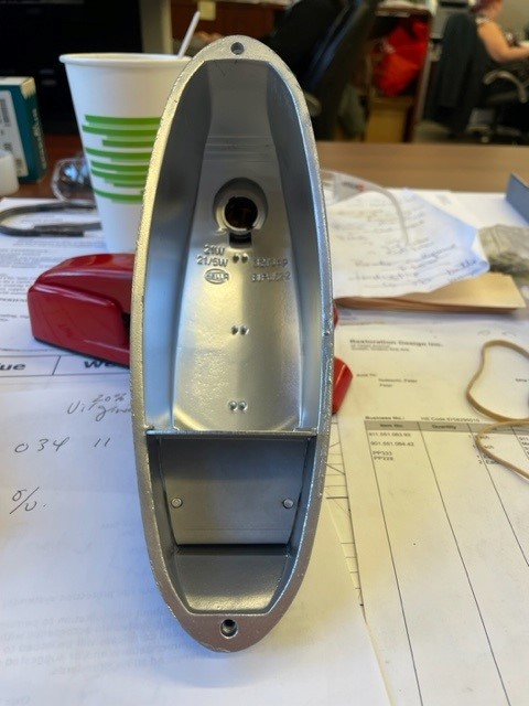

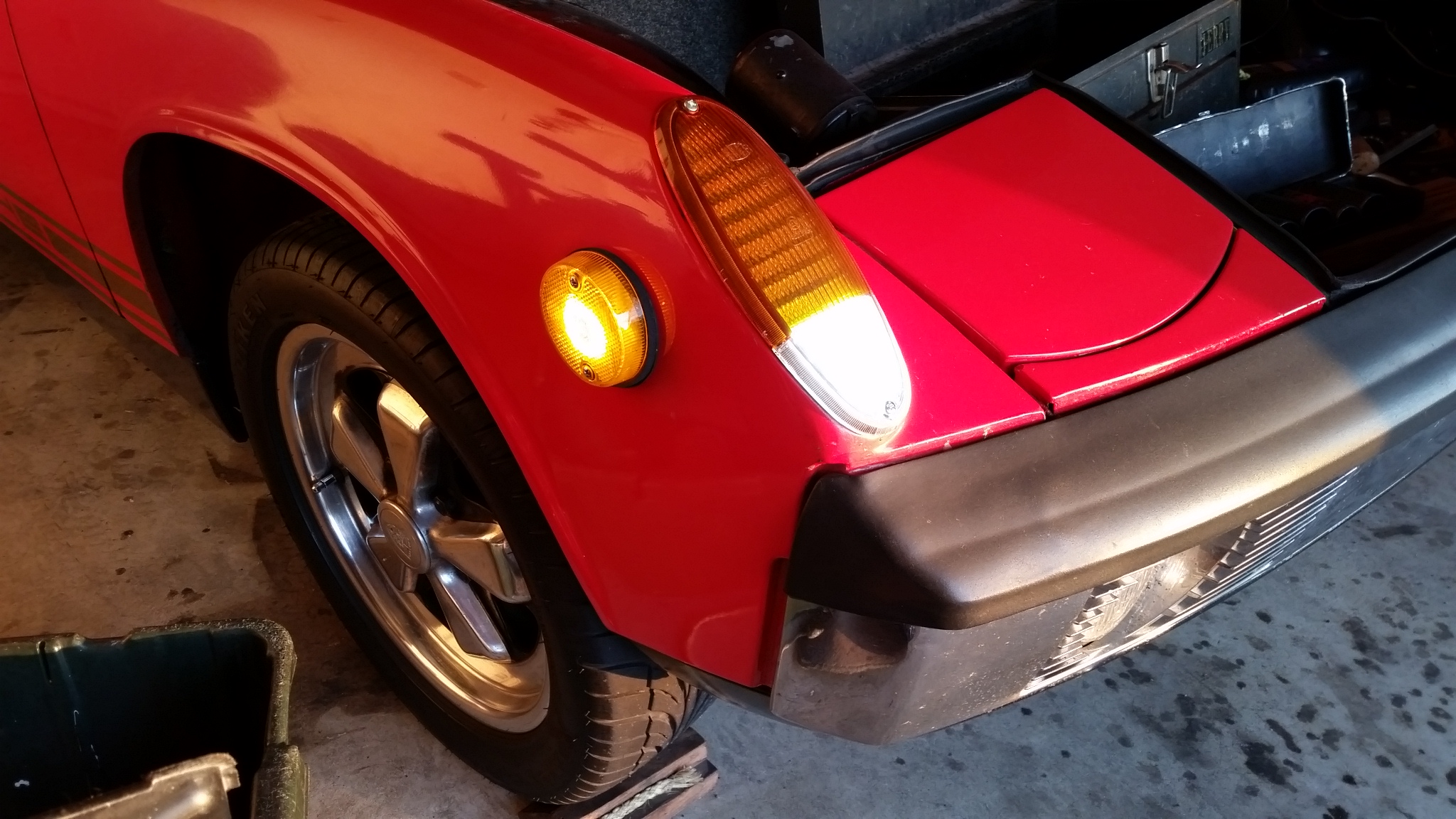

Just as a point of reference these are pictures are of the real deal that are in my 6
Best Bob B

Made my own out of polished aluminum sheet.
