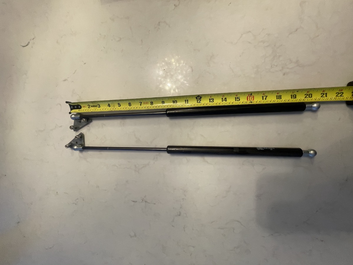

Here are pictures of the kit I got from Clay. The gas struts, Suspa brand (c-16 14874 model), are 20.5 inches long. The ball join brackets are angled on one end (HSMP H180) and flat on the other (HSMP 120) .
It looks like the angled brackets are available here: https://www.imssupply.com/catalog/unknown/h...8zAbGjrdr2WGJlZ
And the flat bracket here: https://fsi-sales.com/products/bracket-sb-1...32ZgaRQBCgBoClW
And the struts are available here: https://shop.suspa.com/c16-14874-gas-spring-p182.aspx

Here are pictures of the kit I got from Clay. The gas struts, Suspa brand (c-16 14874 model), are 20.5 inches long. The ball join brackets (HSMP H180) are the same on each end.
It looks like the brackets are available here: https://www.imssupply.com/catalog/unknown/h...8zAbGjrdr2WGJlZ
I thought the other ones were flat brackets?

QUOTE(ClayPerrine @ Jan 15 2025, 02:37 PM) *
You're absolutely right. In my haste to post I overlooked the difference. I updated my original post to include photos of and links to the flat bracket as well.
