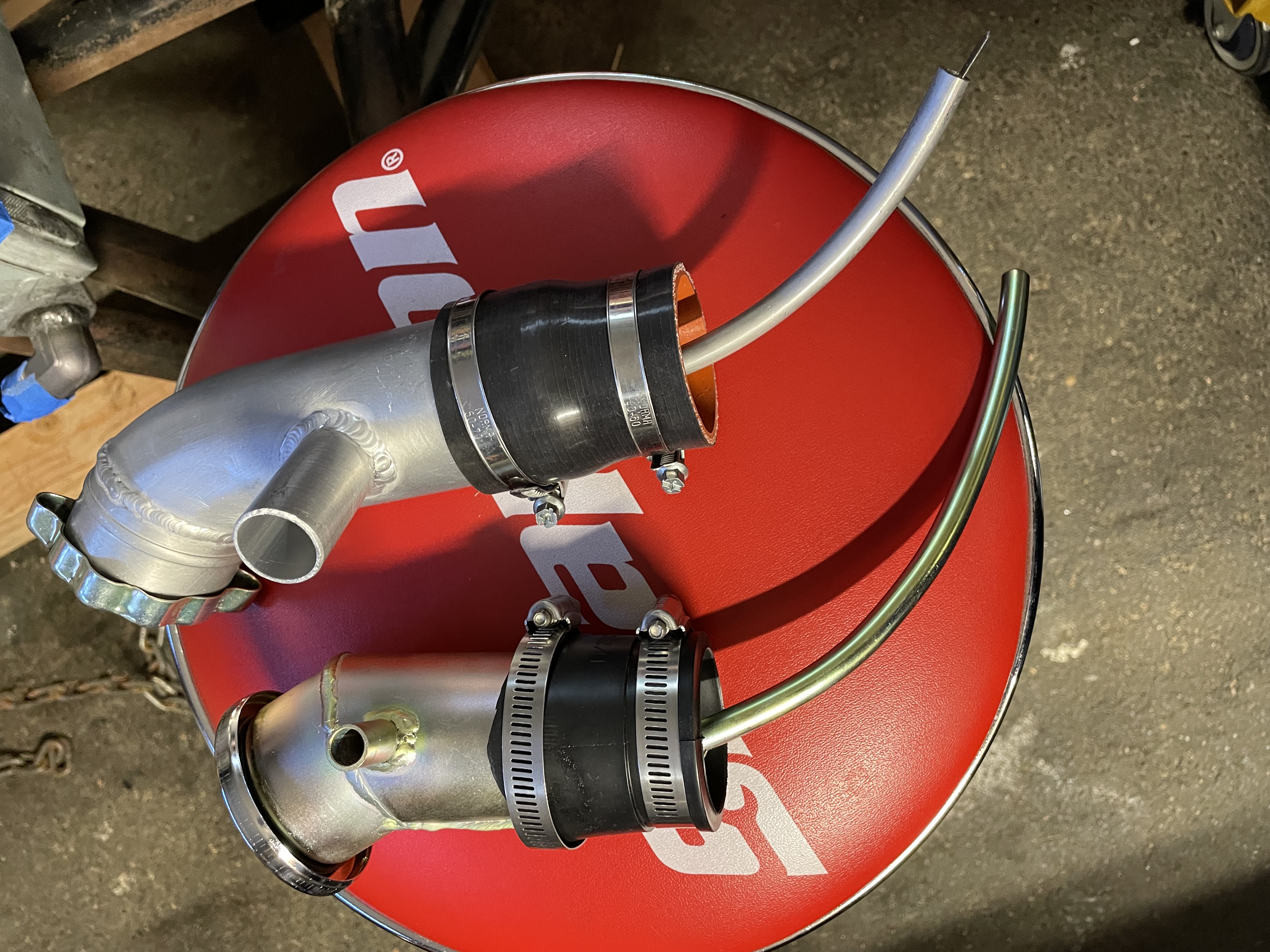

I have a couple of choices of oil fillers to use with my aftermarket oil tank. There are notable differences and I’m not sure why.
One is aluminum, the other steel.
Overall length. The aluminum one is a bit longer which could make filling easier. But more intrusive.
The vent hose sizing. Aluminum one is for 25mm hose the other is 13mm. I’m guessing they are designed to terminate at different devices? I’ve seen from diagrams that some end at an oil overflow bottle. Where did the hose end up on the original 914-6?
Thanks for your help.

mb911
post Jan 14 2025, 05:34 AM
Posts: 7,821
Joined: 2-January 09
From: Burlington wi
Member No.: 9,892
Mine is the one in the bottom of the picture. The smaller fitting is for a puke tank this the small fitting and would be the same size as the GT fillers necks. The 1” fitting on the aluminum filler is meant to connect to the stock air filter. The 1” fitting on the tank should connect to the breather near the triangle of death.
mb911
post Jan 14 2025, 05:40 AM
Posts: 7,821
From: Burlington wi
Member No.: 9,892
Btw why you really don’t want the vent to connect to the air filter is that when you accidentally overfill the tank and that’s a when as everyone has done it at least once or when you drive aggressively the excess oil gets consumed by the engine and you get a ton of smoke out the tail pipe which will also effect combustion effect and could be detrimental to the health of the engine especially if running full tilt. Stock -6 engines really were not high performance so didn’t really matter
Simple answer mine is designed for puke tank just like GTs
The aluminum one designed for attaching to stock filter but could be adapted to puke tank.

mb911
post Jan 15 2025, 07:16 AM
Posts: 7,821
From: Burlington wi
Member No.: 9,892
QUOTE(scrz914 @ Jan 14 2025, 11:56 AM) *
Thank you. This information is very helpful.
For reference the upper one in the picture is PMS brand.
