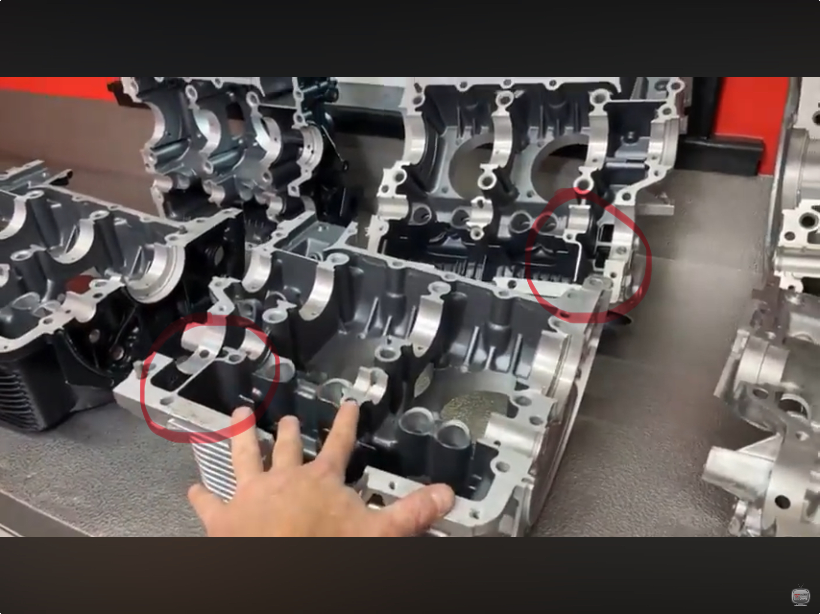

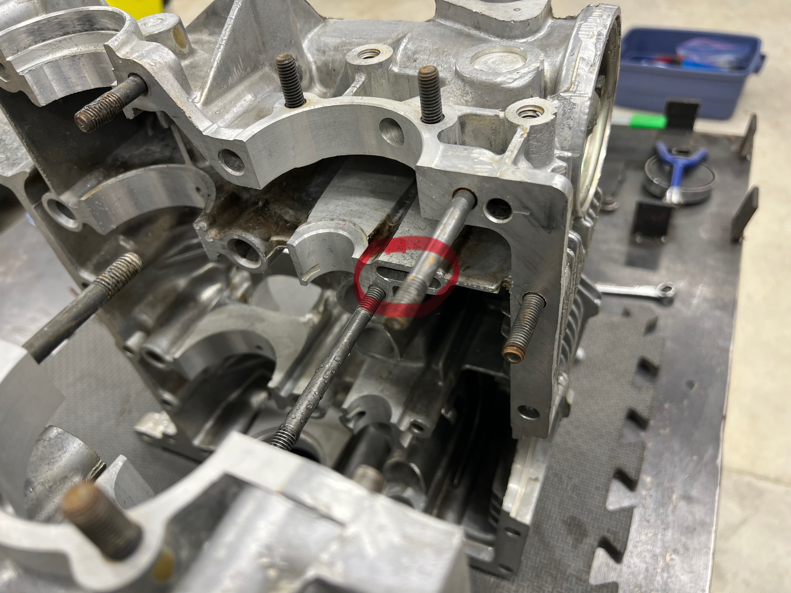

Can someone tell me what the slotted hole indicated within the red circle on the first photo is, why it’s there, and how’s this case differs from most other cases that I have seen the does not have the hole? Cases in the second photo have no similar hole.

The photo with the coated engine cases is a clip from Jake Raby’s YouTube video “The Tale of Three Cases”. I simply used that clip to show the difference in the specific area in question.
Jake explains why he uses these coatings in the video.
Back to the initial question….can anyone shed some light on what this hole is???

The OP got an answer on FB. Here is Raby's comment:
"This crankcase is from an engine originally fitted with hydraulic lifters. This is not a 914 case, it is either a VW bus case with the code of GE (or maybe a rare late GD case) or it was sold as a universal case in the 1980s from VW. I can't see pics of the breather chimney, so I can't tell if has an enclosed chimney from a Vanagon (CV case code). The important part of this engine is it must use the proper (short) oil pick up tube which was never 914 equipment. The passageway is how the oil returns from the oil pressure relief bypass. With hydro lifters this bypass oil was to be instantly recirculated to keep the lifters pumped up during the bypass period."

As a continuation of Jake’s response to my question, I gave him the case numbers and this is what he had to say:
“that’s a newly manufactured replacement case known as a universal case. These had no case code stamped on them. This case likely has a major issue in the oil pressure relief system or the cylinder decks. These cases have been a major pain in the ass for me over the years. Some of them that I found that were NOS were never used and were “new” because they were junk. This one actually appears unused and there’s likely a big reason for that.”
