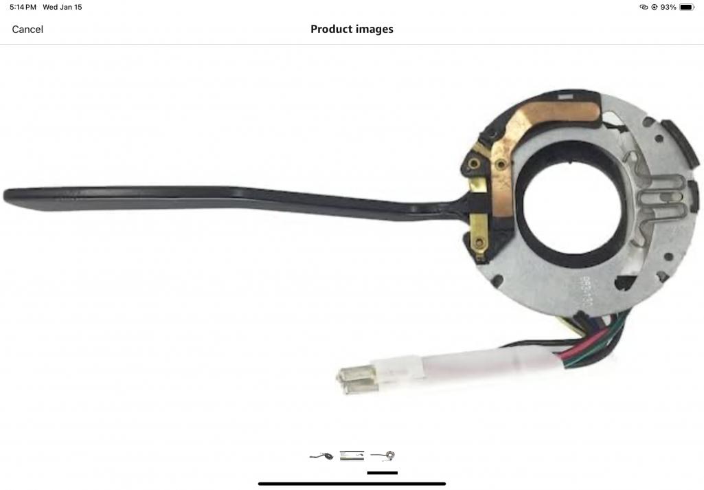

I just received this replacement turn signal switch and noticed it a little different; the original switch has two copper bat wings on the top. The replacement only has one.
1. Is this gonna be a problem ?
2. What are the copper bat wings for ?
FL000
post Jan 15 2025, 08:43 PM
Posts: 451
Joined: 31-January 12
From: Lancaster, CA
Member No.: 14,076
Hey Jim,
Pretty sure the wing is for the horn. In theory should work with one if that is how it was made (not defective) but can’t say from experience.
914Sixer
post Jan 16 2025, 12:56 PM
Posts: 9,123
Joined: 17-January 05
From: San Angelo Texas
Member No.: 3,457
Even original SWF ones went to single tang in the late 1990's, so yours is correct.

72-74 HAD TWO FINGERS, 75 76 AND 76-81 924 HAD ONE FINGER FOR THE HORN CONTACT. EVERYTHING HAS BEEN SUPERSEDED TO THE ONE FINGER
