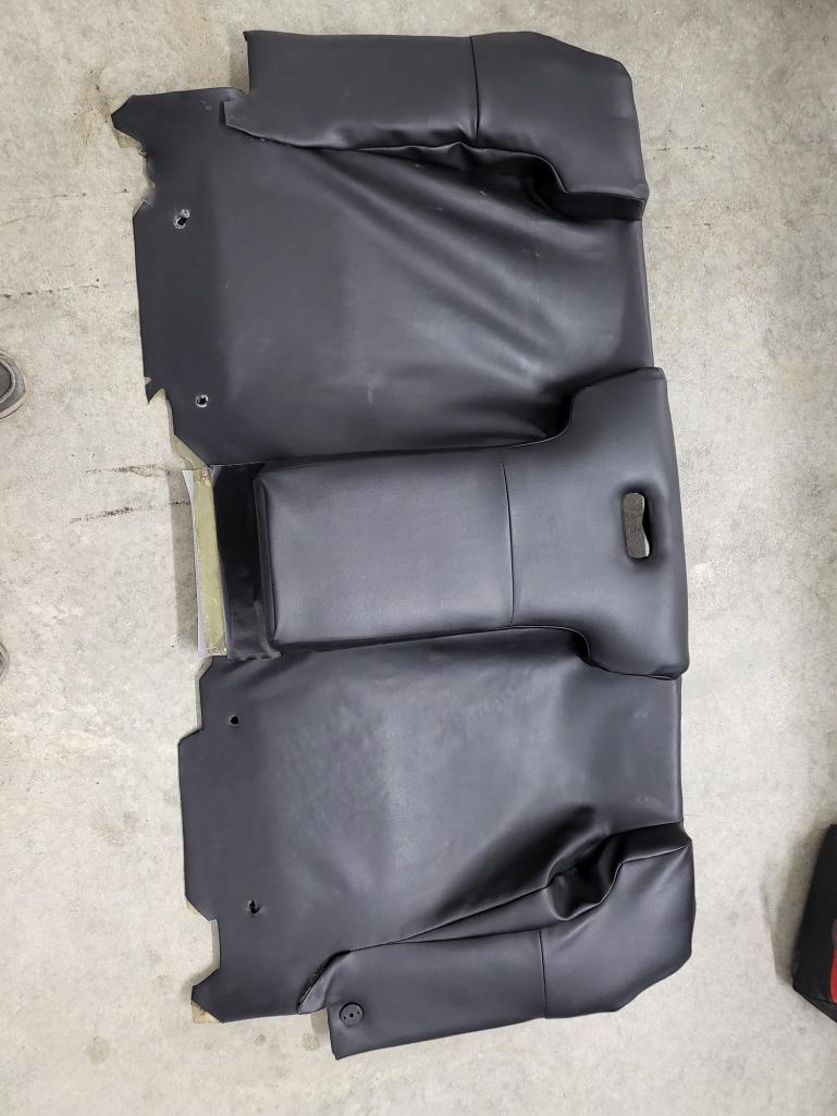

OKN929
post Jan 29 2025, 09:38 AM
Posts: 12
Joined: 19-December 22
From: USA
Member No.: 27,039
I have attempted to restore mine and have it looking pretty good but could never get it to sit flush. I working on the mounting brackets to better secure them but I'm still using the original backpad with some minor updates.
