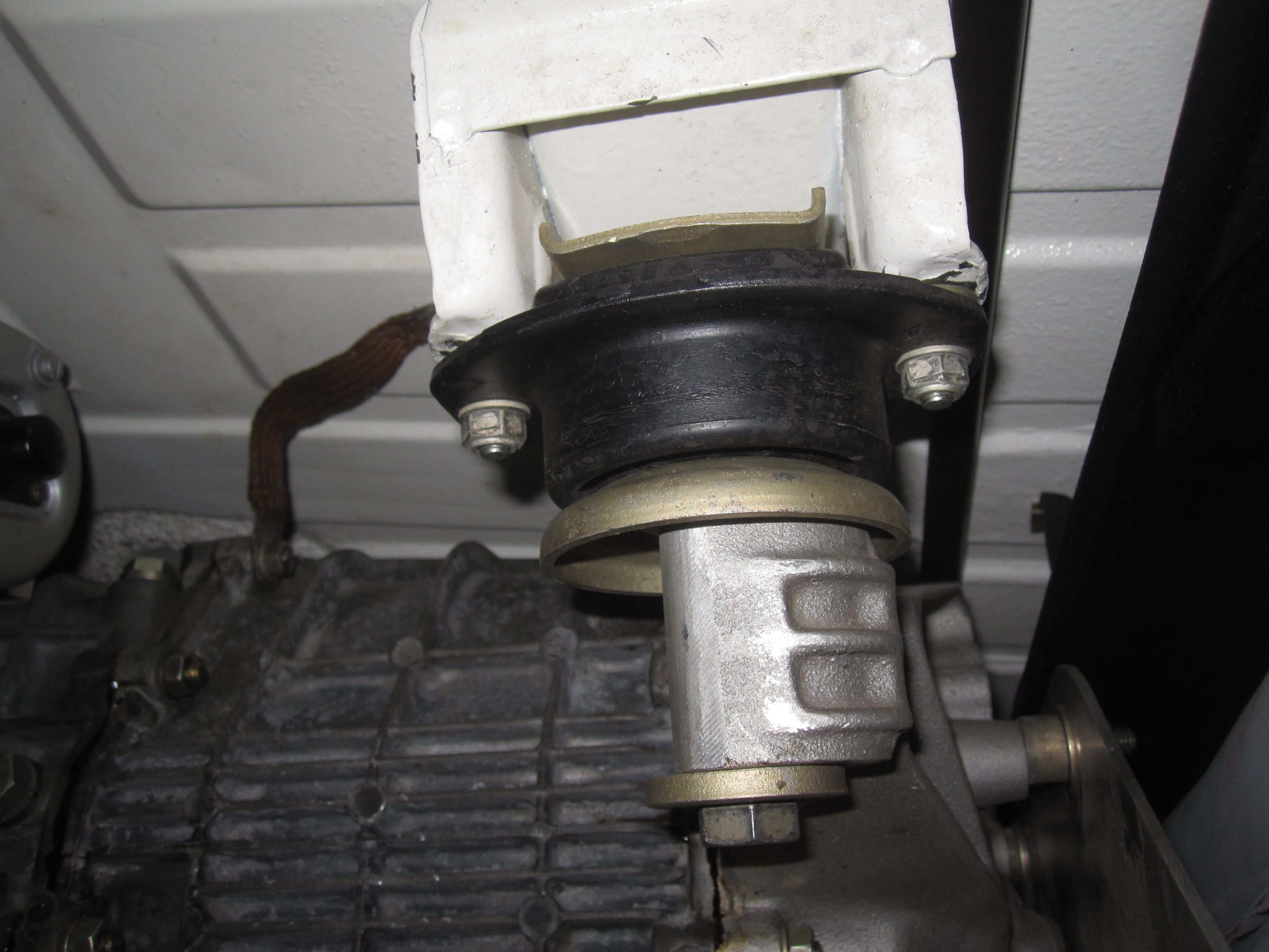

Here is a shot of the 916 at Canepa that you can see the reinforcement plates present.
My guess is they were installed by the factory.Attached Image

For some reason those cup washers /transaxle mountings look out of place with what I usually see ¿¿
But I think that with the 916 hot rod 2.4 mfi, the stiffening kit should be present.

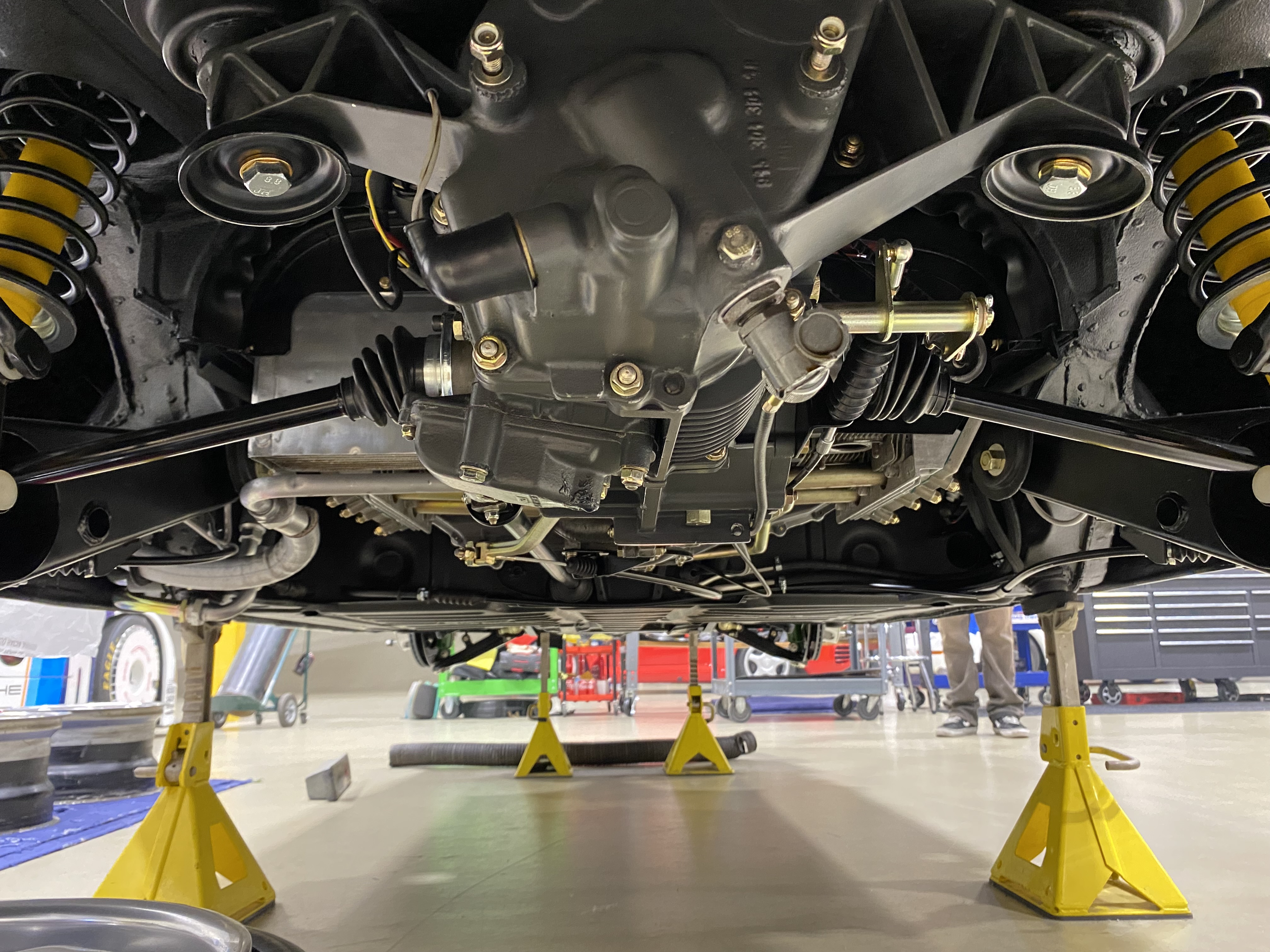

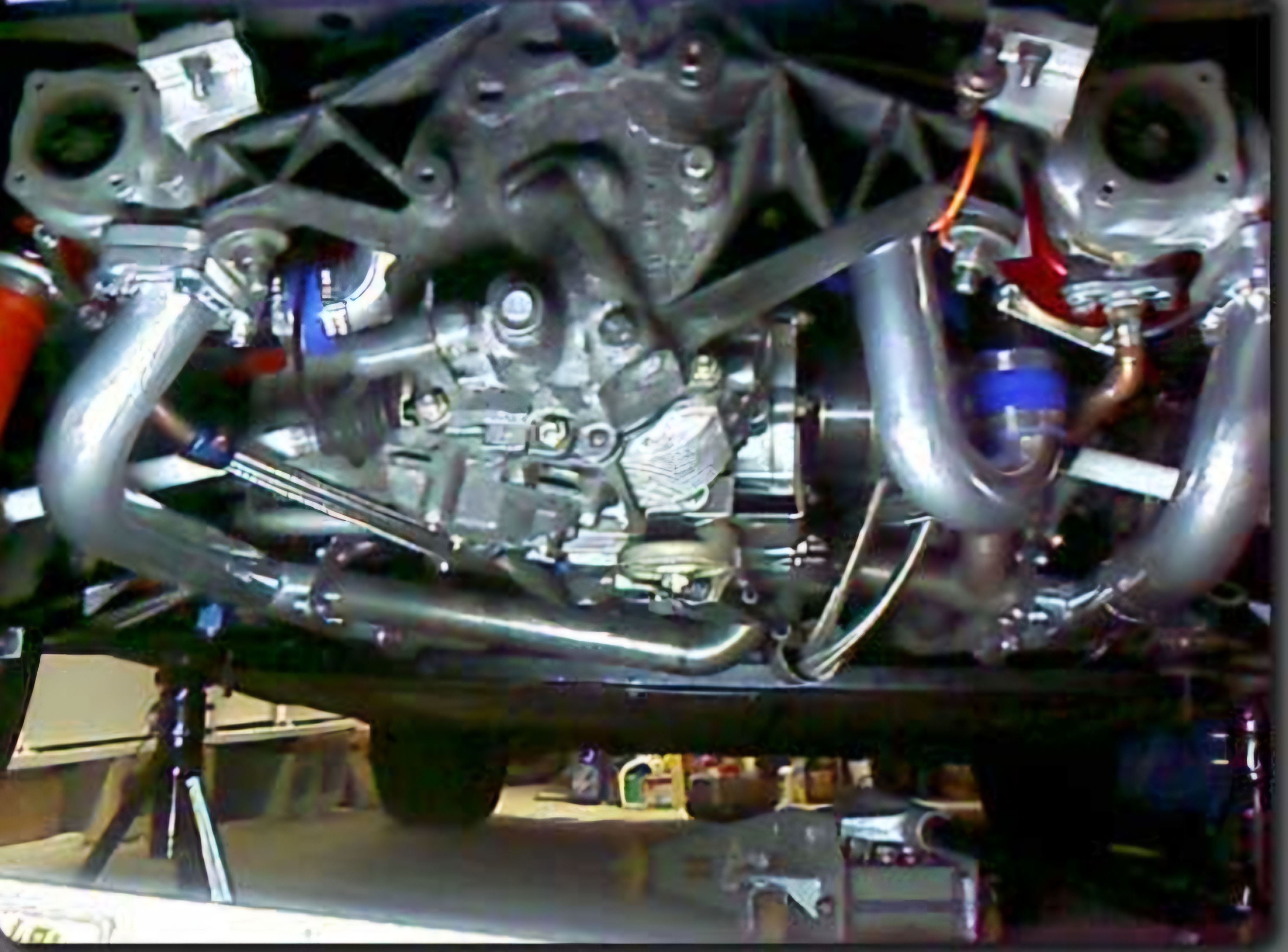

This is how the 916 nose cone transaxle mounting hardware has been running in my biturbo / flatfan car for the last 30+ years. I do use custom made T6 aluminum solid rear mounts though.

QUOTE(Maltese Falcon @ Feb 1 2025, 10:17 PM) *
They're in the wrong place...should be between the casting and the trans mount.
When in the correct place they are often installed wrong side up.
BUT...racers sometimes place them wrong side up to stiffen engine/trans
location.

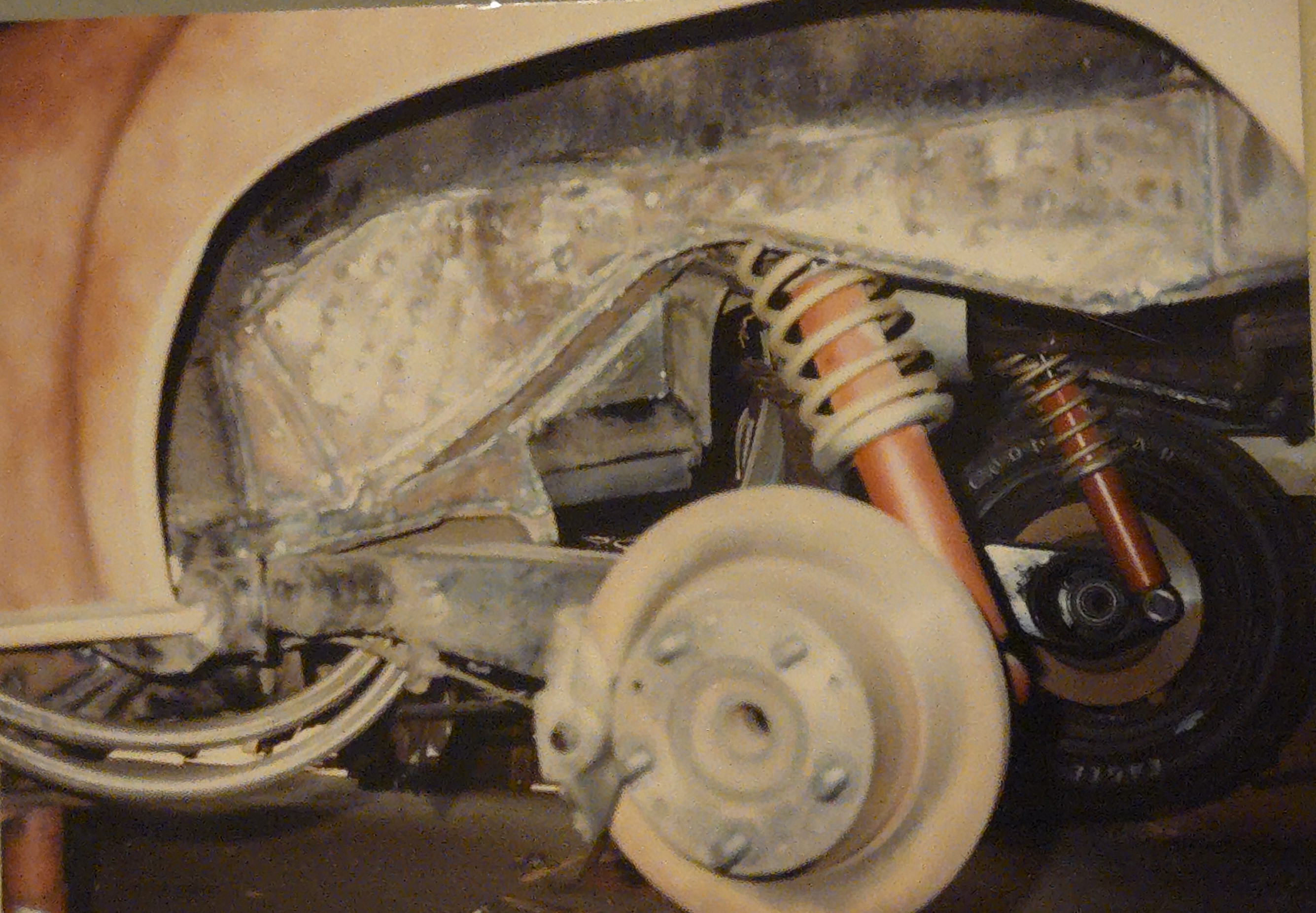

@Montreal if you have a bit of time during your 4 to 6 conversion> you should definitely schedule your chassis reinforcement kit installation. Having to go back and do it once your 6 is converted and running is a lot more work.
Starting in 1976, club racing / time trials in the 914>with a T4 2L boosted at 7psi started a few hairline cracks in the inner ¼ panel/ fender well sheet metal areas. I didn't even know about the gt stiffening kit, and just left as is. In 1978, I converted to a 2.7L 6 and raced at same tracks RIR and Willow, still left the weak rear inner fender areas as is.
In 1985, when I installed 3L biturbo, and GT steel flares, 916 trans, 8 point cage; I located the stiffening kit + welded that as well. When we sanded away all of the undercoat and paint the sheet metal damage was seriously worse than just a few cracks.

funny the transmission round plates are on the wrong side of the ears
916 had the chassis stiffening kit welded in
QUOTE(TMM914 @ Feb 1 2025, 07:36 PM) *
rgalla9146
post Feb 3 2025, 08:11 PM
Posts: 4,997
Joined: 23-November 05
From: Paramus NJ
Member No.: 5,176
[quote name='dr914@autoatlanta.com' post='3190151' date='Feb 3 2025, 06:57 PM']
... see posts 3,4,5 and 6
