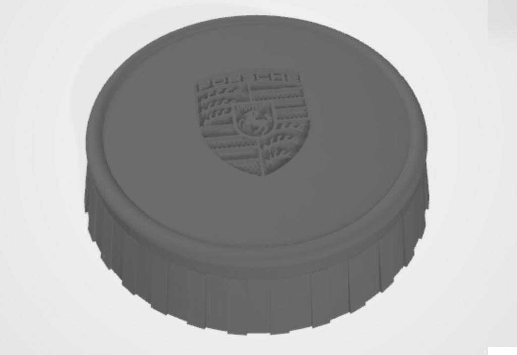

Been playing with many different approaches to a 3d printed hockey puck. I gave up on the leather texture and instead have gone for a nod to the original but one that instead looks good and prints easily. That means two pieces and a larger emblem.
I have it as two pieces now so the detail of the emblem is good on a filament printer (you need to print it at an angle with supports but the puck sides are printed flat on the board for best results with no supports needed. I have not uploaded these to my collection on thingiverse yet. I will provide instructions on printing when I do. If you have a resin printer the single piece form with the smaller emblem will work fine.
https://www.thingiverse.com/thing:6238862
These were printed at low resolution. I will print a high resolution form, paint and assemble when I get a chance.

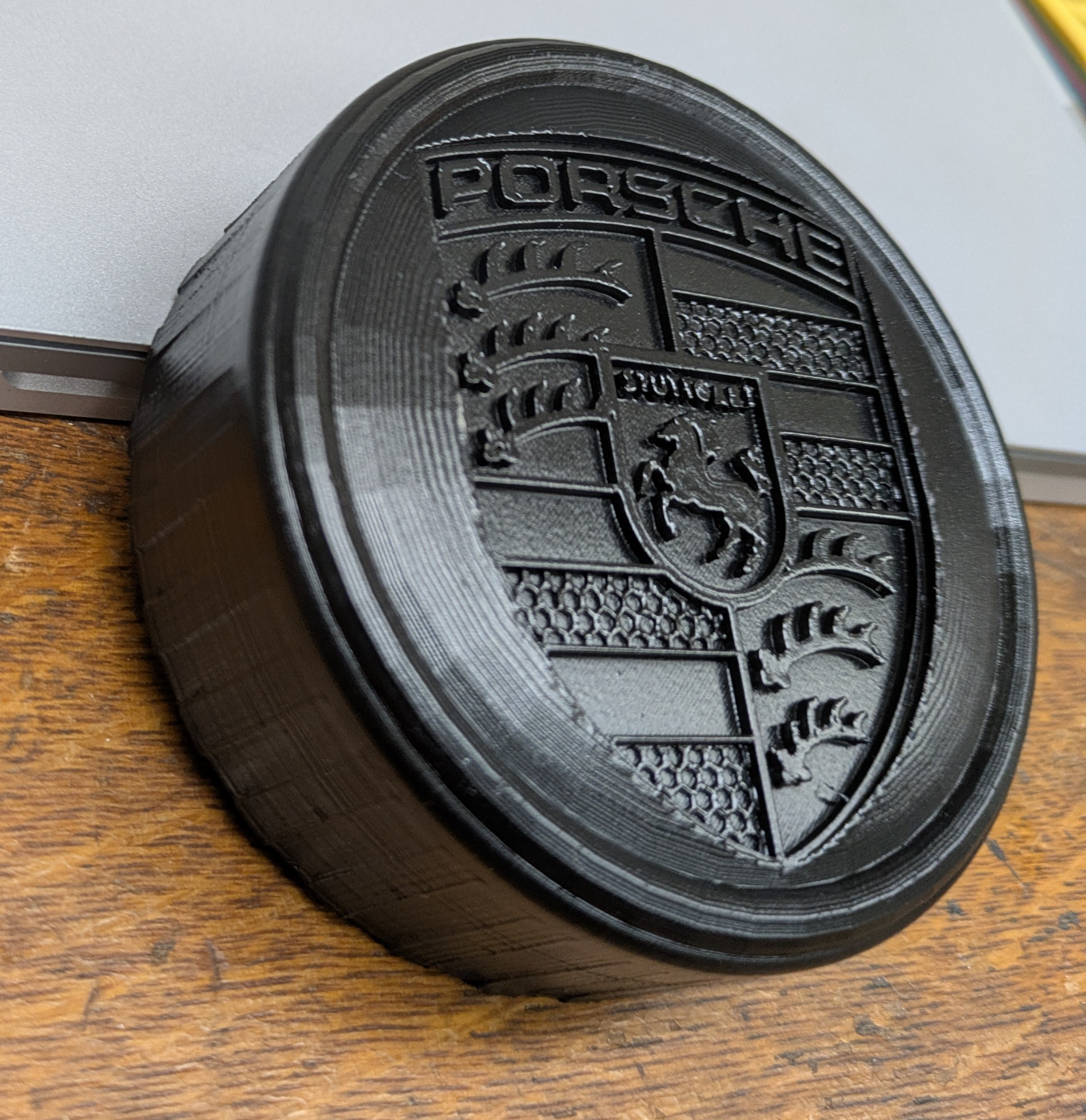

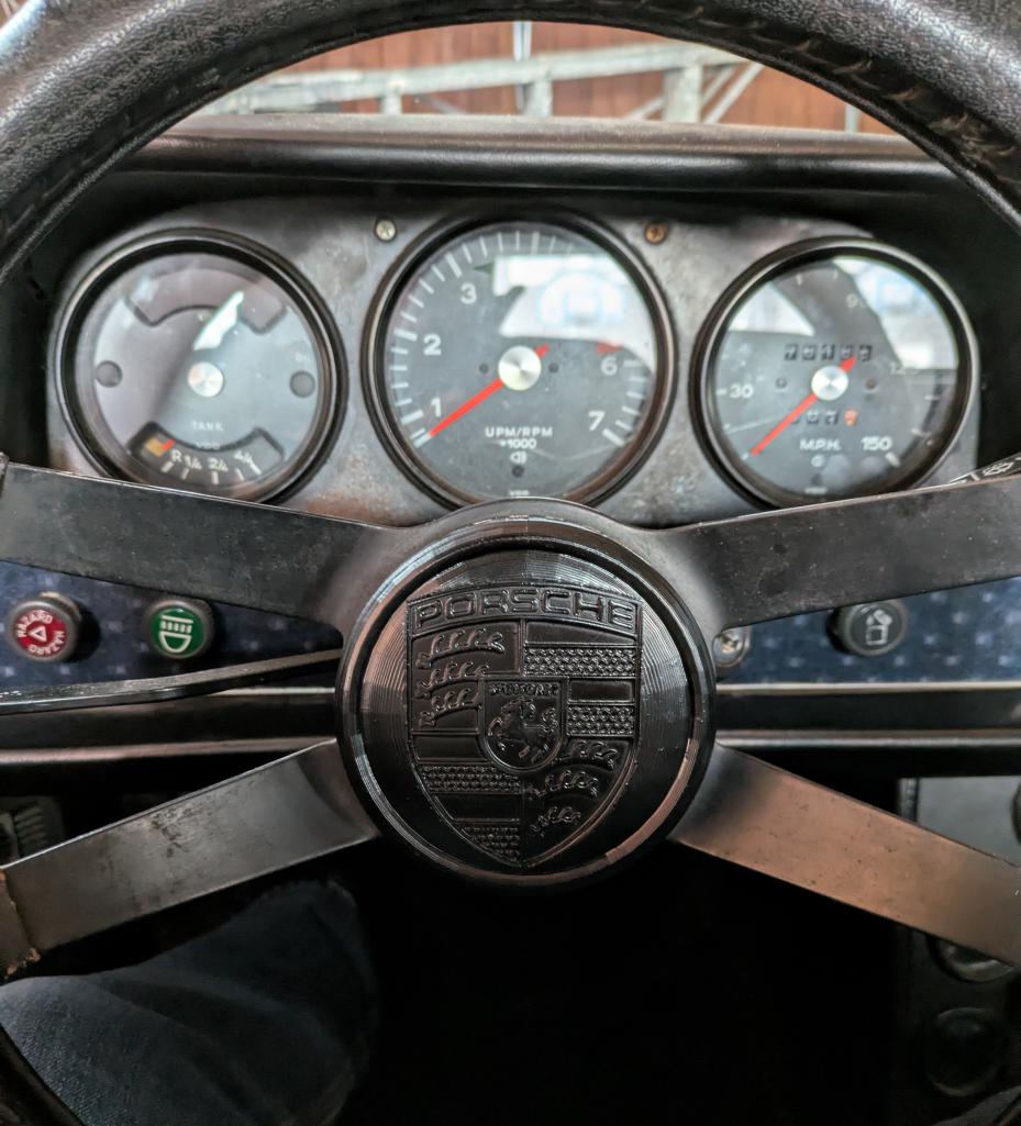

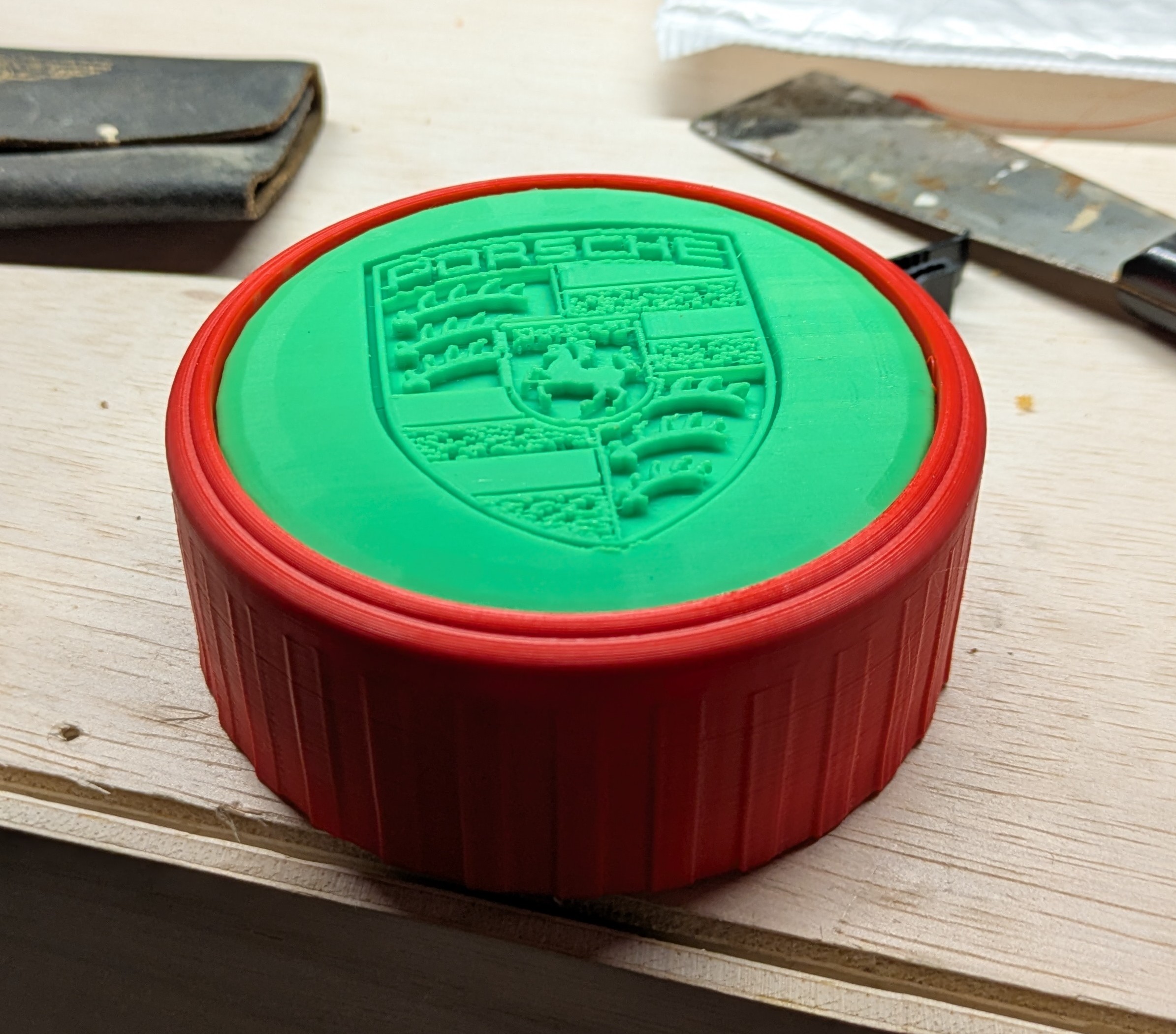

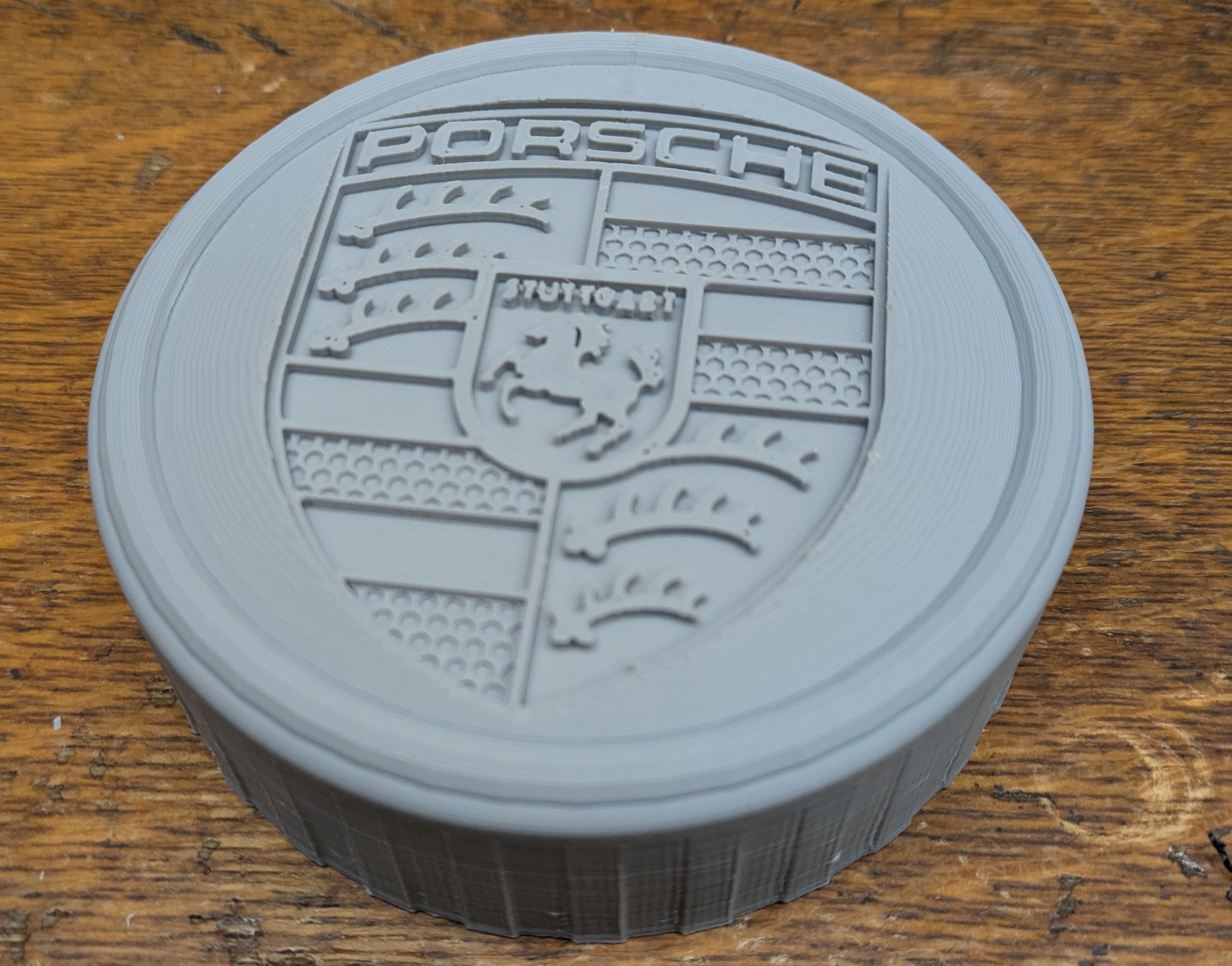

Well, I think I have gotten it to where I am happy.
Raw off the printer:
and here it is painted.

This is the '6.3-biggerhole' stl on my thingiverse.com page (that refers to the indent on the inside for the rubber bumper).
This is a good compromise between ease of print and 'faithfulness' to the original design. I figured a single print design would be better for everyone and this does just that. This was printed at .12 with a .4 nozzle on a longer lk5 pro. It looks pretty good on my anycubic kobra 2 neo as well, same settings.

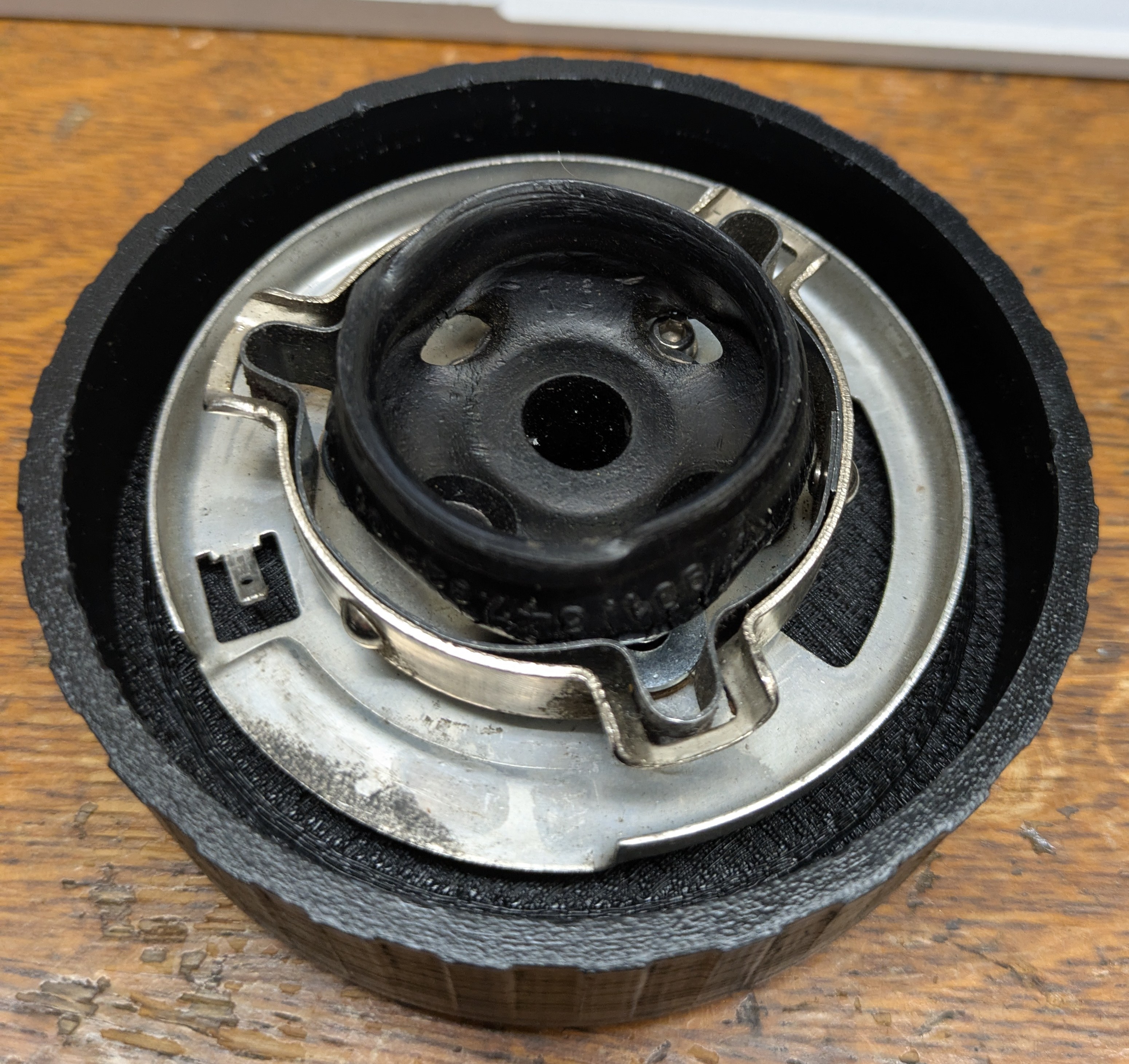

I have two models set, one for just screwing straight into, and another setup for threaded brass inserts (the better way).

Popped it on the garage bound car today. Could be just a hair larger in circumference but otherwise worked great. I have just bumped up the diameter to 105 from 100. Will have to print another one I guess...

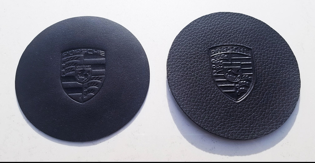

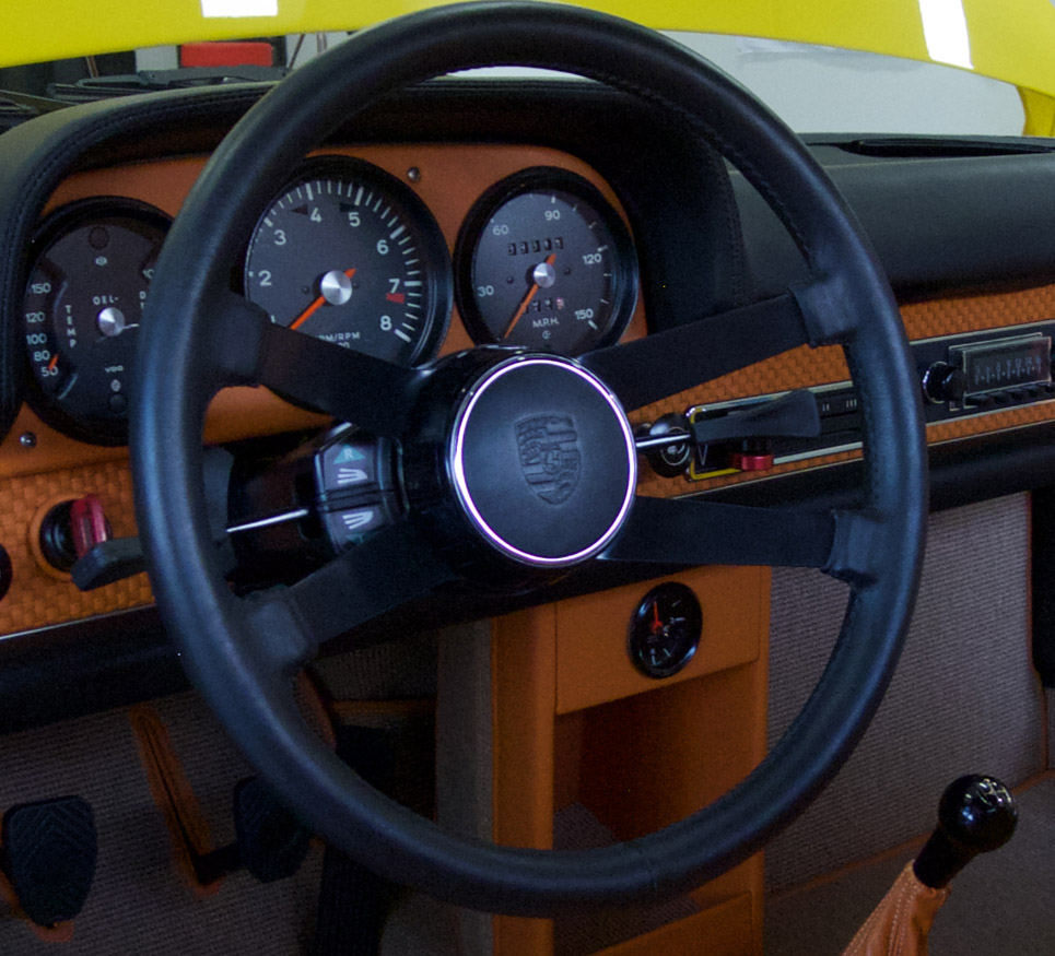

I love the work but just an idea. I think if the crest was the same size as the factory used, I think the proportions, IMHO I think it would look better. Also, color filling and sanding may look very cool.
Shown is a real factory puck. Used it was like $450. On Ebay 15 years ago. I also had to try a few different leather puck faces till we got one that was good enough.
Best Bob B

Pretty amazing , what can be done , modern times...

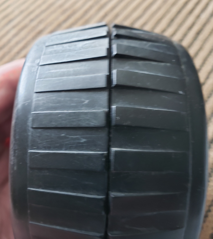

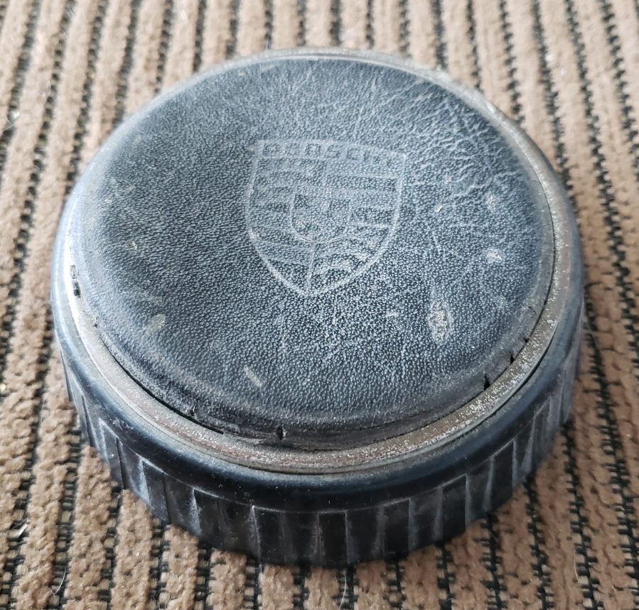

Here is a pic of an OG Puck...
The dia. at the top of stripes is 98.50mm and tapers to 108.550 at the base of stripes, Stripes are 1.0mm tall at the base of puck ...

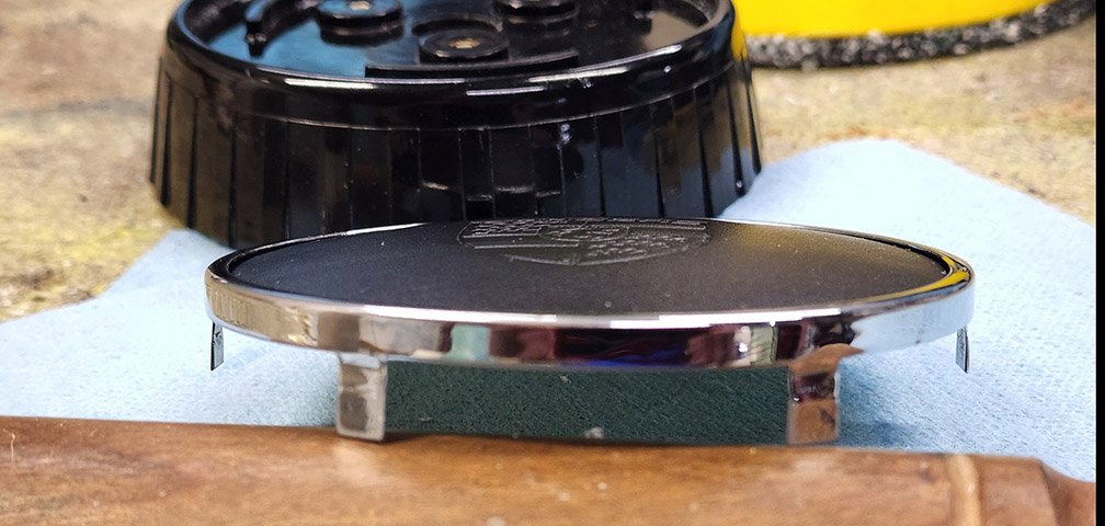

The second pic is of the First version and the Last version...
Note the insert was only a press fit,The Later had tabs to bend over to
retian leather ...
sixnotfour

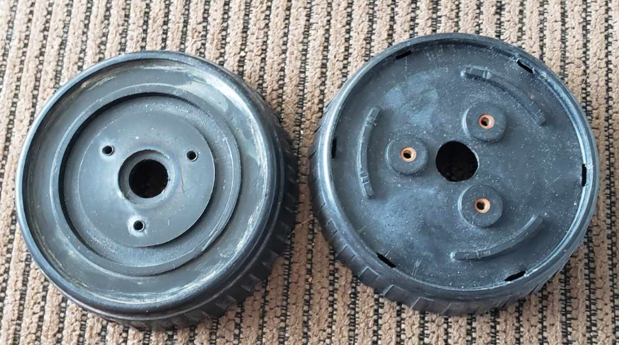

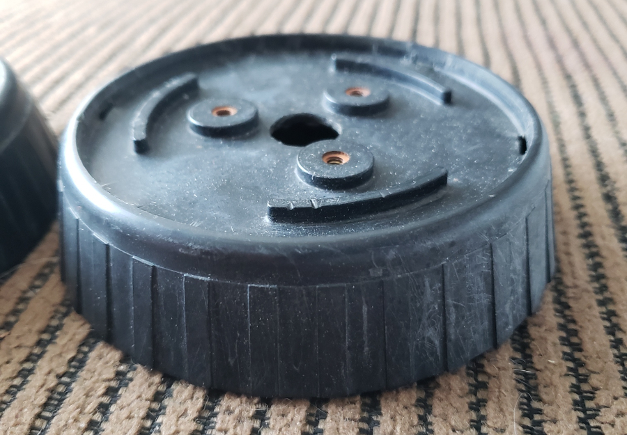

Well Its Snowing ...So,, Early Versus Late...Early on right,,
Here are the dimensions and visual between the two..
OD at top of stripes, 99.00mm, and the Bottom 110.00mm, Stripes are 1.50mm tall at the base of puck ...

Pictures of OG puck used for my built. Just for reference
Best Bob B

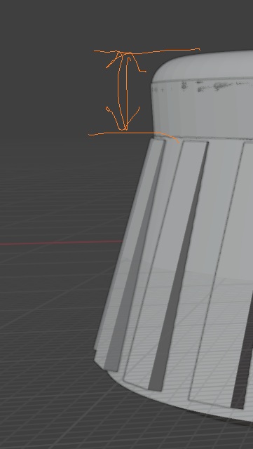

Sweet, so then the cylinder diameter at the base must be 109.5?
The other measure I would like is the height from the top of the 'bumps' to the top of the bevel.

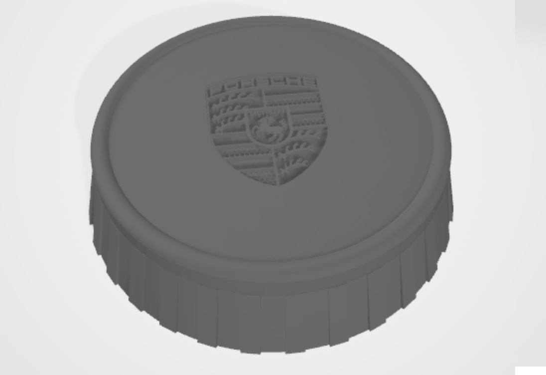

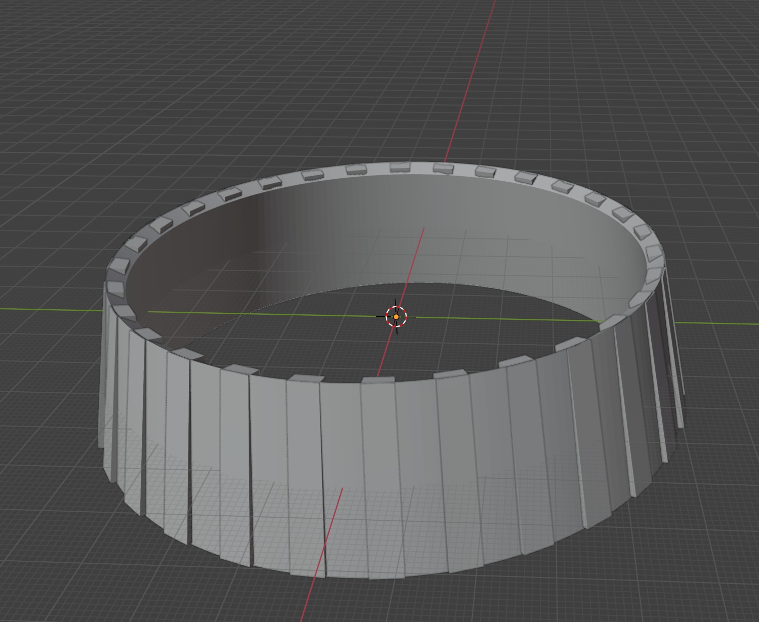

Well, here is a small logo version of the new design with the flared base.
Gonna print it and see how it goes...
