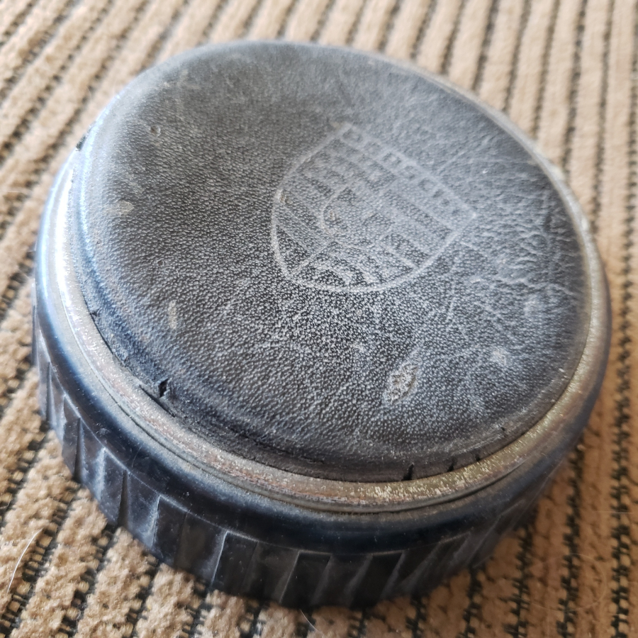

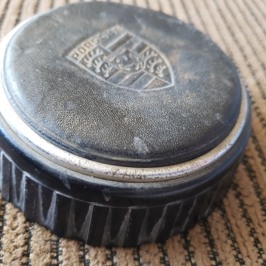

Also the leather had a pressed dia. that went under chrome , That made it start about 1.0 to 1.5mm higher than chrome.. not sure about the curved
height of leather originally.
The pic shows what was originally under the ring...2 different pucks... (IMG:style_emoticons/default/beer.gif)

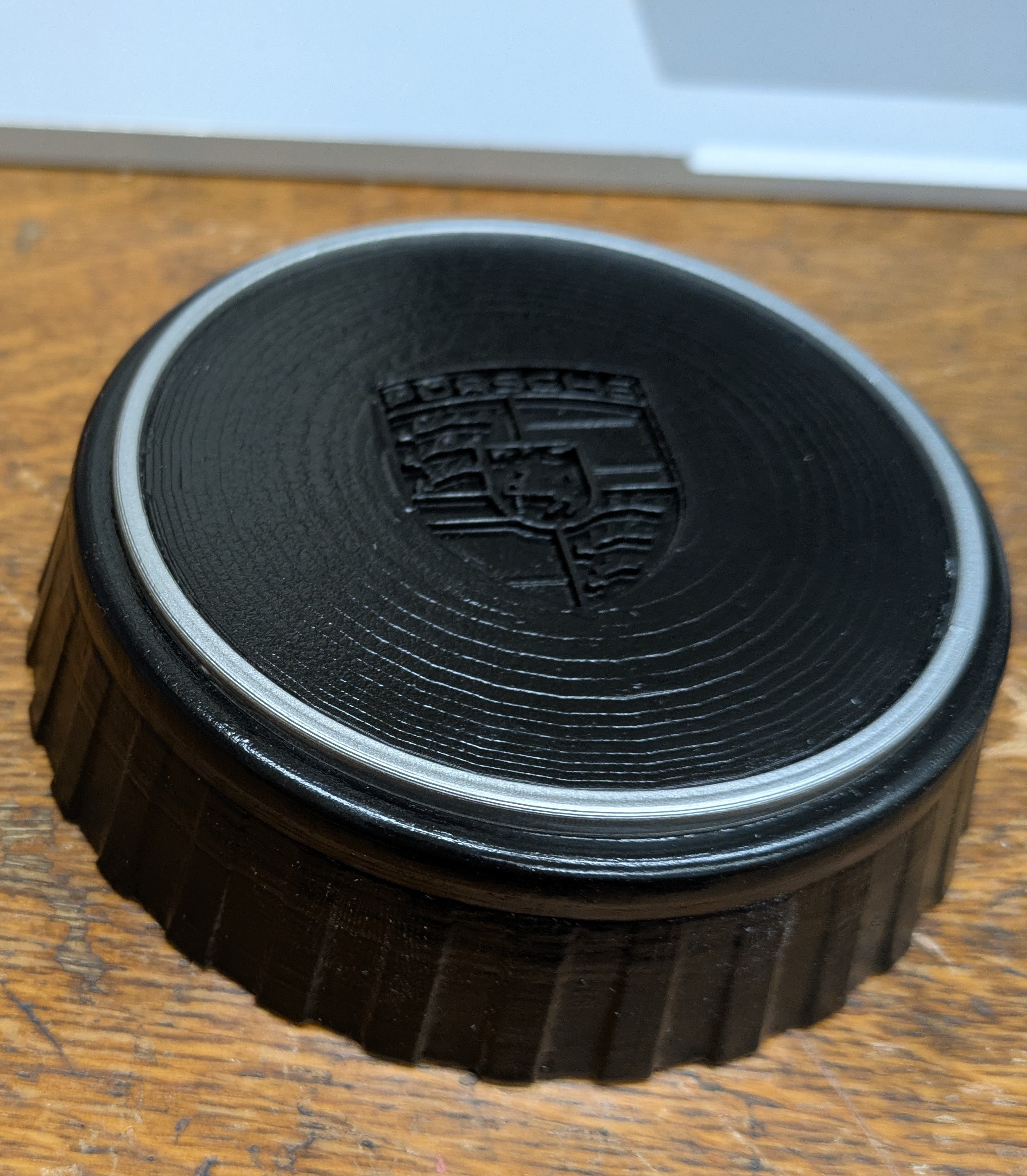

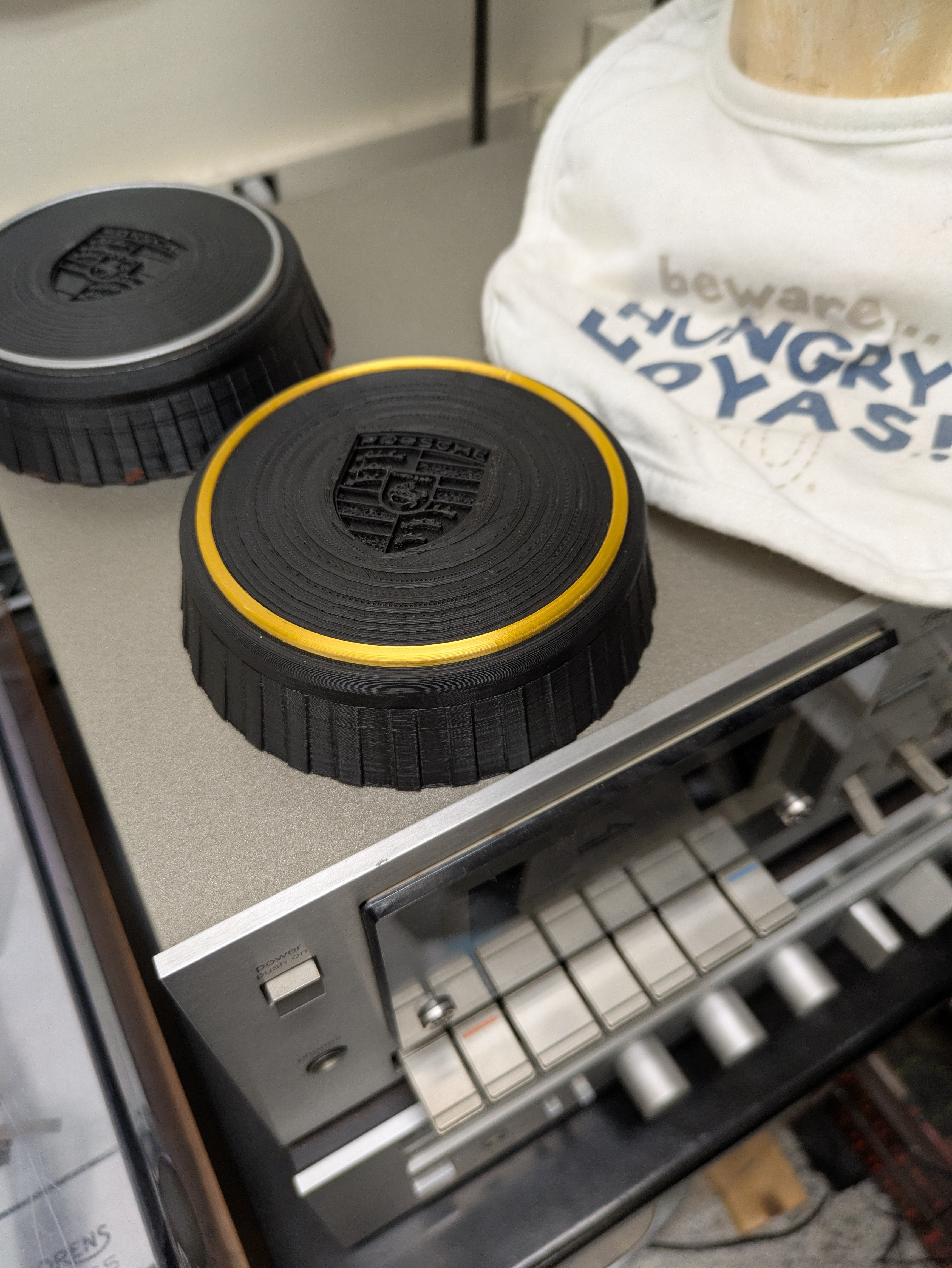

I haven't decided about how much I want the 'dome' to exceed the top of the chrome ring. I can't really make the squashed sphere (yet) that the leather creates in real life so currently at its center the sphere I am using is there at about 1-1.5 above the chrome. I will have to see if I can create that kind of a buldge.
Here is this morning's print.
unpainted. Used some gold-colored filament for some flair.

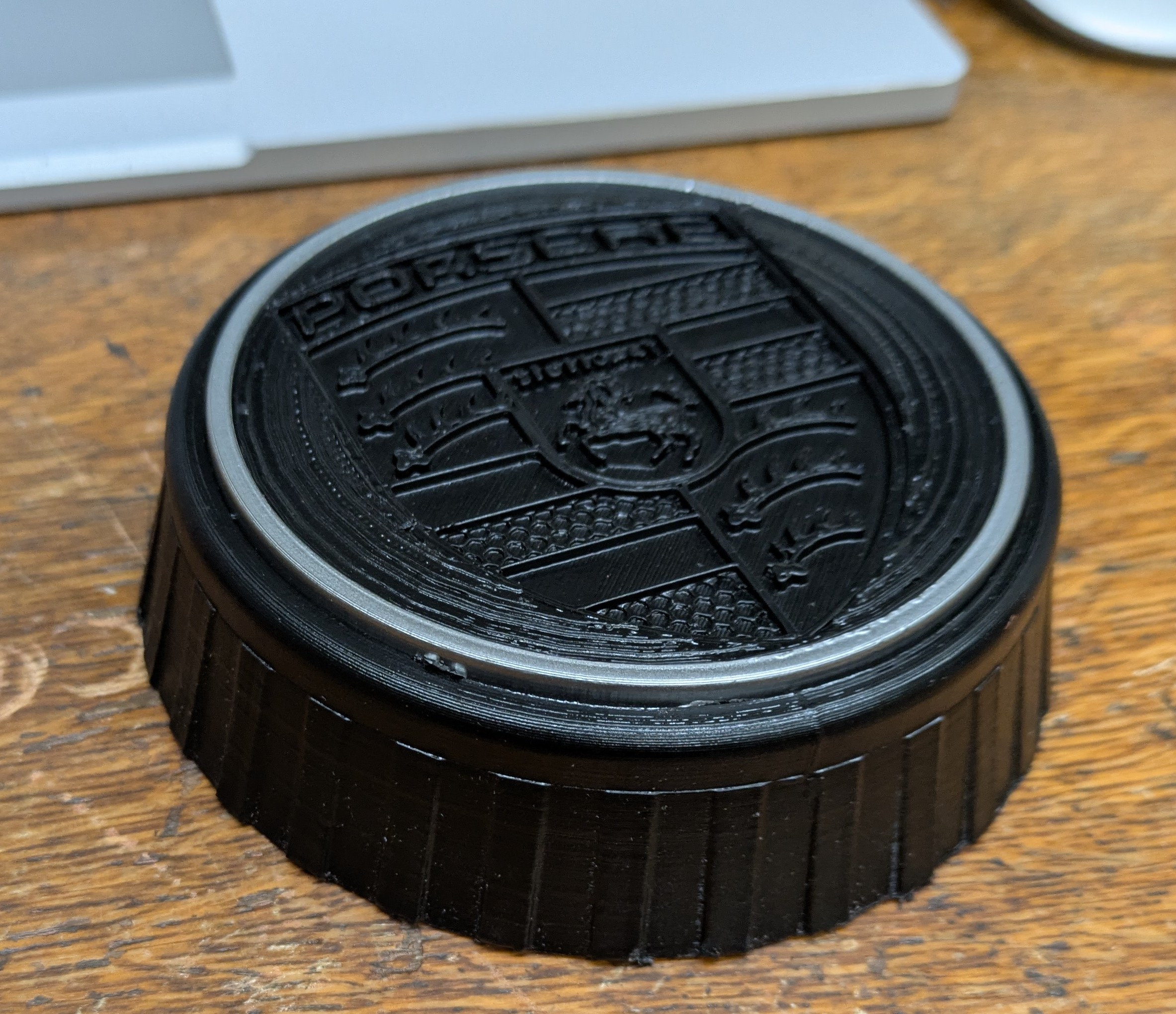

Here is the final print, painted and ready to go.
Small logo is abs and the big is a pla test. I am going to expose it to car cabin heat and see what happens.
All the stls are up on thingiverse https://www.thingiverse.com/thing:6238862
When I put it on the car tomorrow I will post a picture.

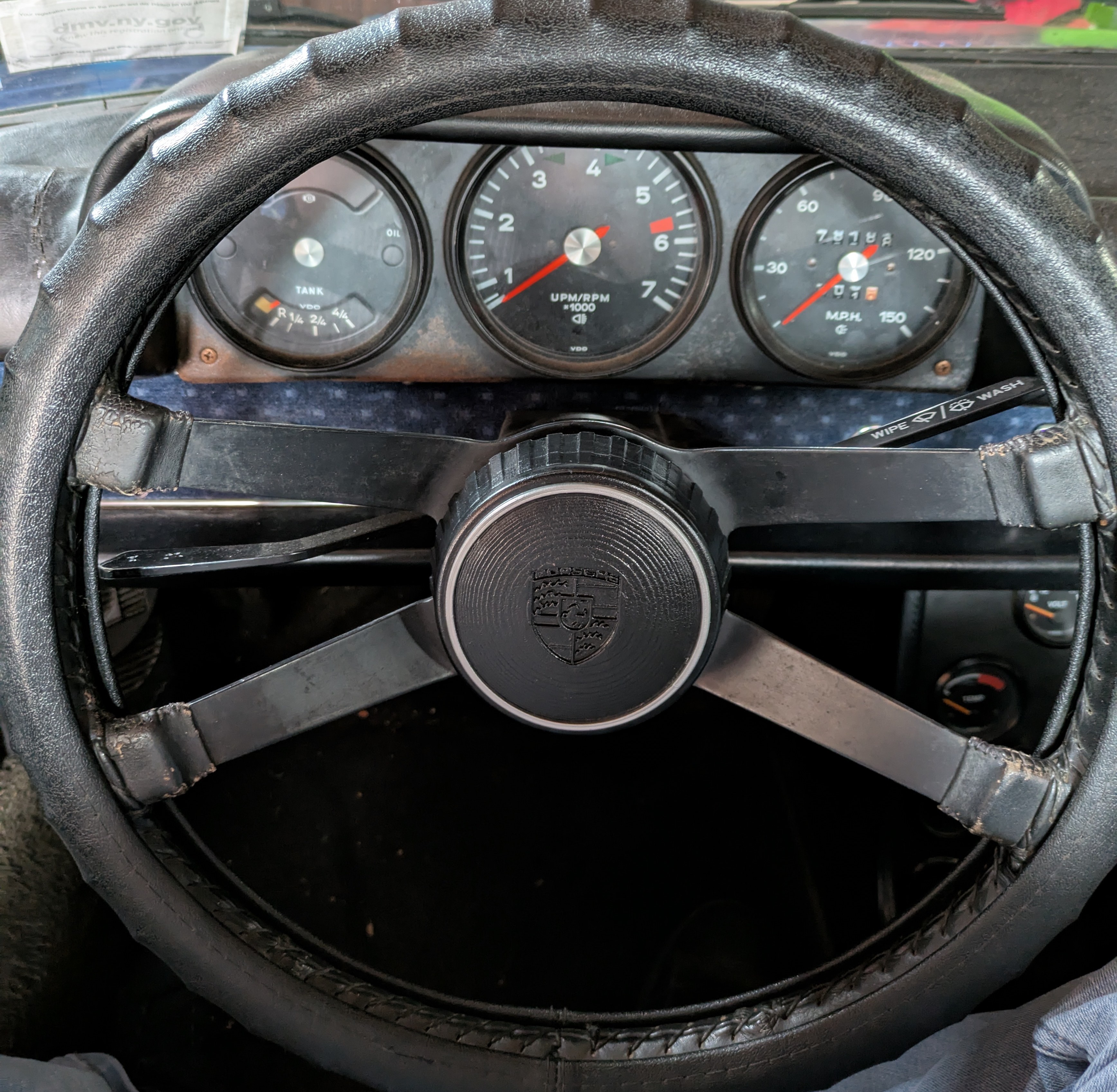

emerygt350
post Feb 28 2025, 11:30 AM
Post #46
Posts: 3,068
Joined: 20-July 21
From: Upstate, NY
Member No.: 25,740

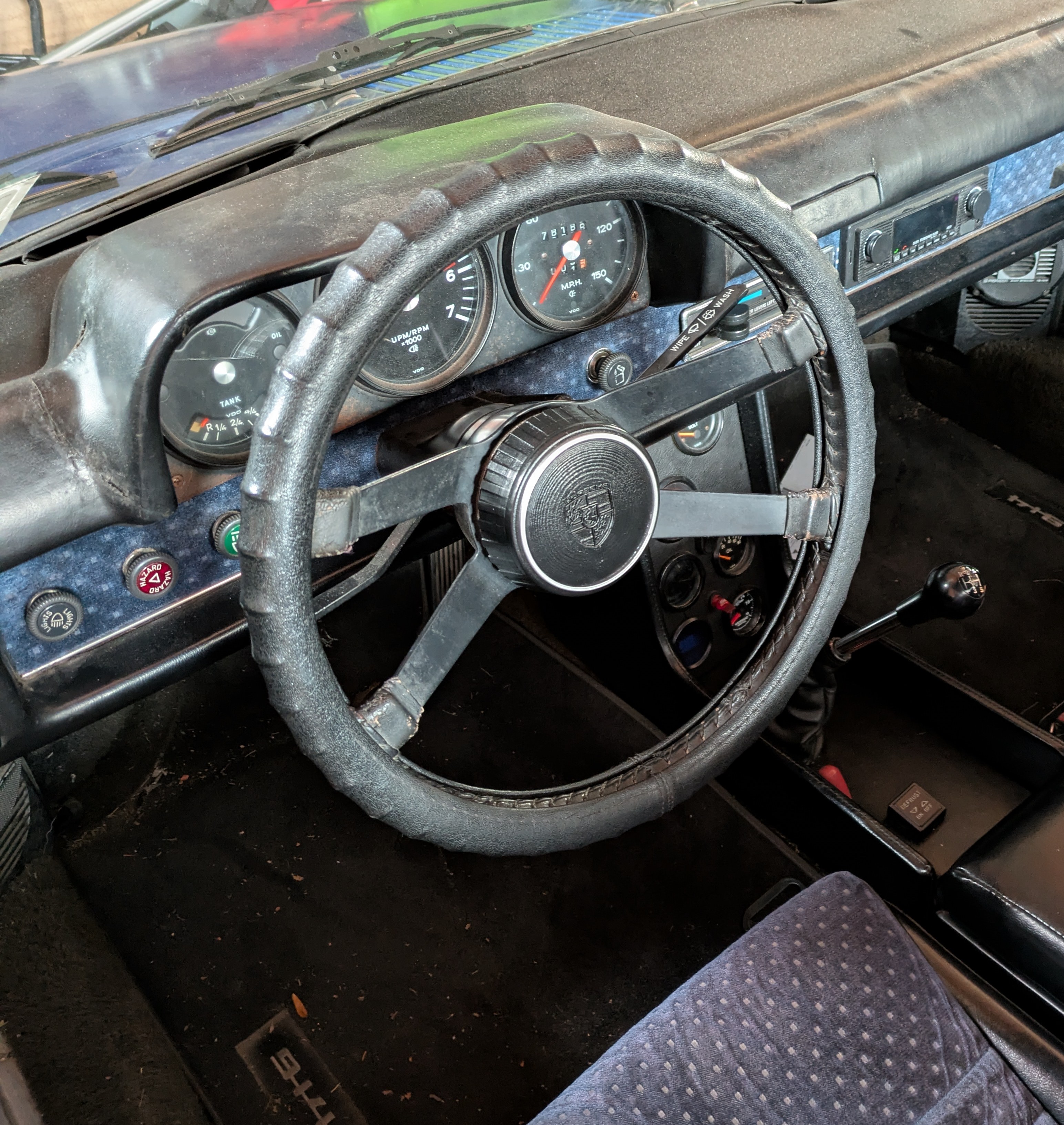

And here it is installed.

I must say... it's very handsome,,, Nice job! (IMG:style_emoticons/default/beerchug.gif)

I would be tempted to sand it down to remove the resolution marks on the face of the puck.
Cool idea!
If you know someone with a resin printer you should be able to really clean up the resolution.

QUOTE(VaccaRabite @ Feb 28 2025, 07:02 PM) *
Cool idea!
Zach
Yeah, we have one but it is down. I have been working on a spare print looking at sanding and putty. I am not so thrilled with the results. It just doesn't make it look any more 'real'.
Resin won't let me add the brass inserts and it gets quite brittle so even screws get a little dodgey.
