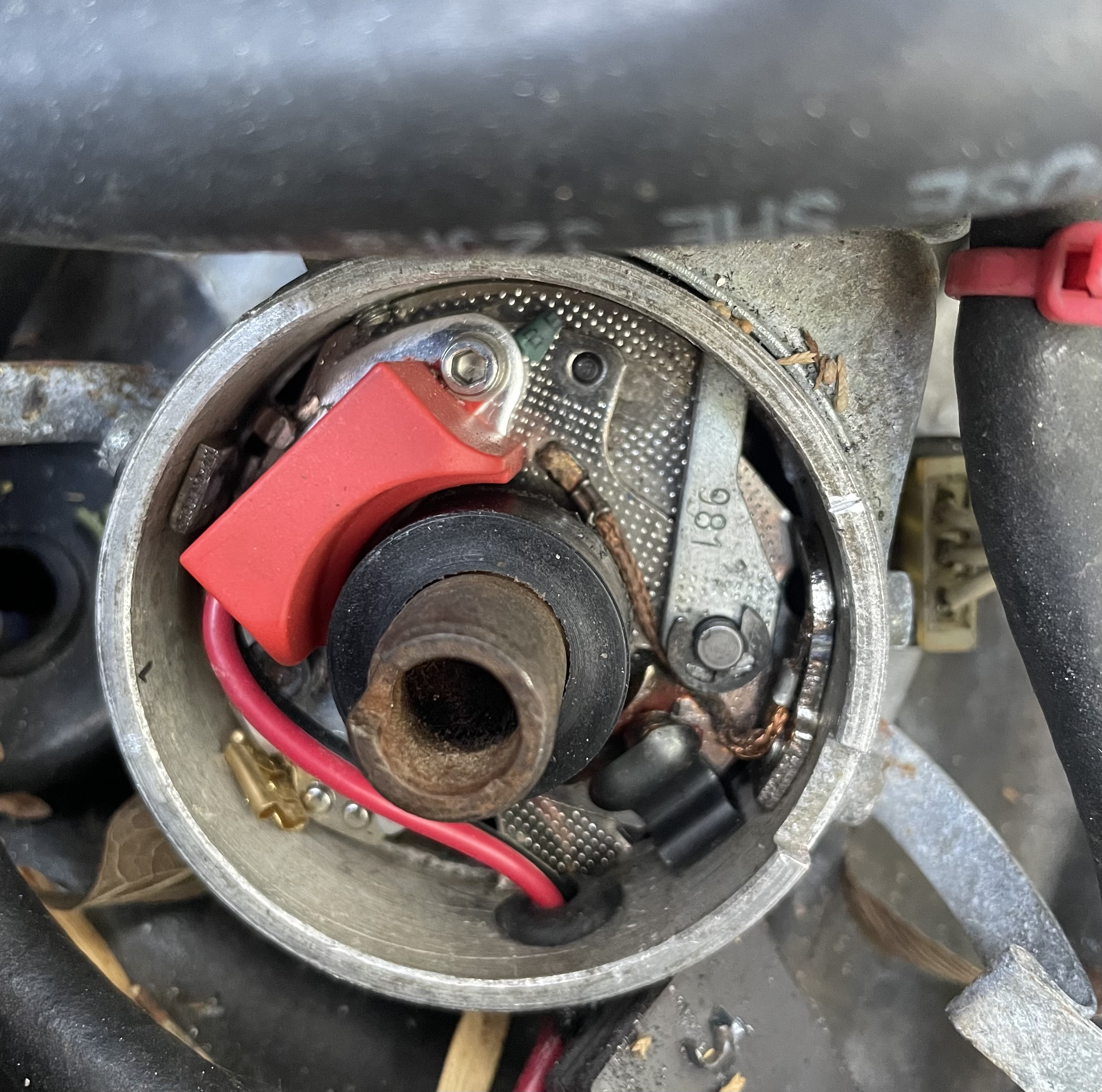

This electronic points replacement unit was installed on my 1.7 when the engine was rebuilt, just before I got the car (engine never started or reinstalled at that point). Now the engine is in (5 years later) and I’m getting ready to try to fire it up for the first time. I’ve turned my attention to the distributor and since I have no experience with these electronic inserts and no installation instructions or paperwork, would first like to know if anyone recognizes this particular unit? - it’s red and I’m only seeing black ones on type 4 when searching. And is there any glaring mistakes that you guys see to the installation?

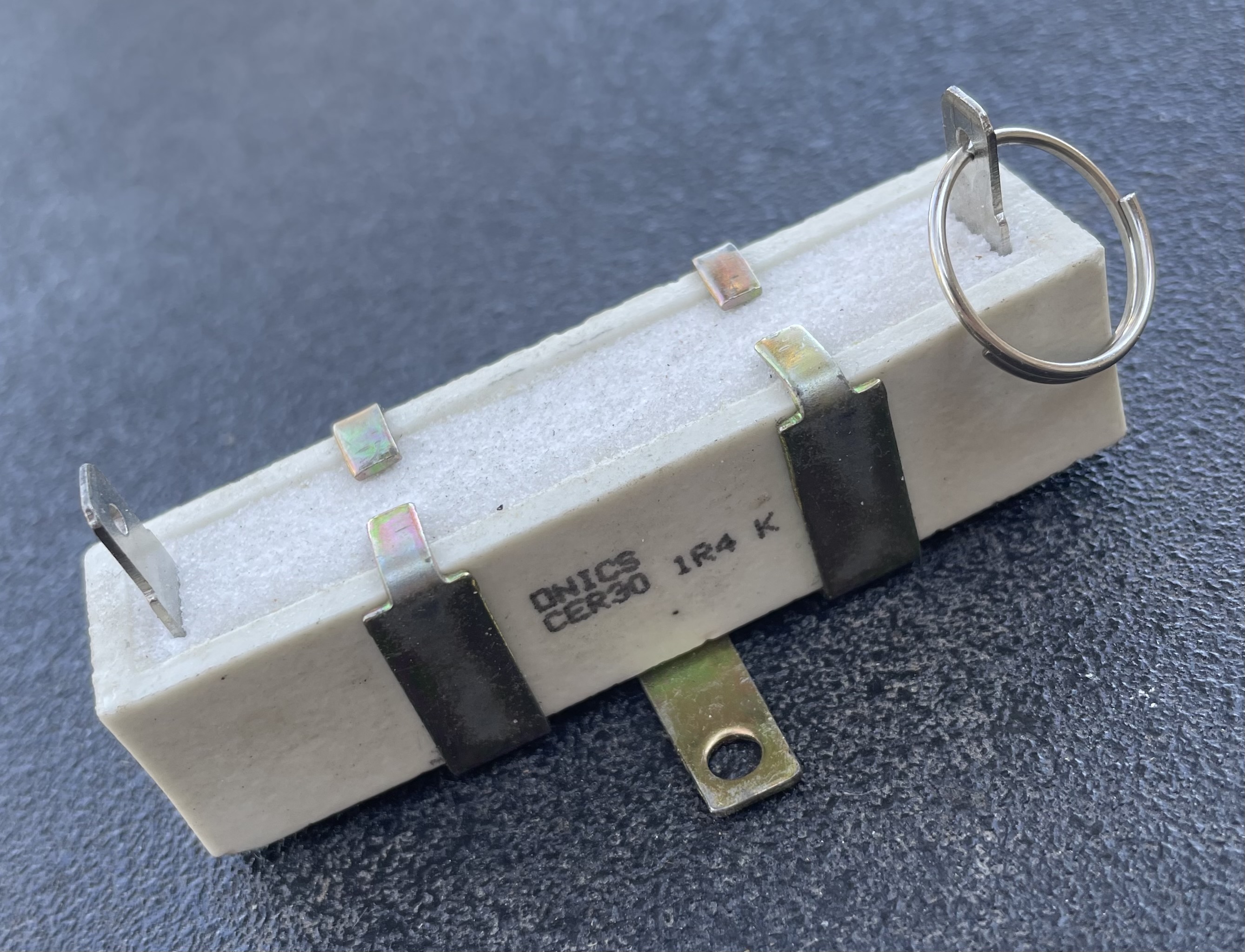

This ballast resistor was amongst a box of parts that came with the car, but not installed.. so I’m wondering why not (aren’t they recommended/necessary?).. if so, I’m not seeing a real convenient place to mount it, where are you guy installing these (I did a search for pics)?
Superhawk996
post Feb 2 2025, 01:07 PM
Posts: 7,592
Joined: 25-August 18
From: Woods of N. Idaho
Member No.: 22,428
I don’t recognize the electronic ignition and can’t comment on that.
Regarding ballast resistor, measure the primary side of the coil you intend to use. Should be around 3-4 ohms. If it has an internal ballast resistor don’t use the external resistor.
Using a coil with too low of primary resistance will burn points or will destroy an electronic ignition.

OK thanks.. there is currently a Beru Germany ZS 172 installed which is described as having an internal resistor and being a direct replacement for Bosch Blue coil (I have a couple of those packed away too I believe). I will check the resistance on this one.

So my Beru measure 3.3-3.4 ohms, 3.3 is spec so I suppose it’s good to go - will not be installed the ballast resistor.

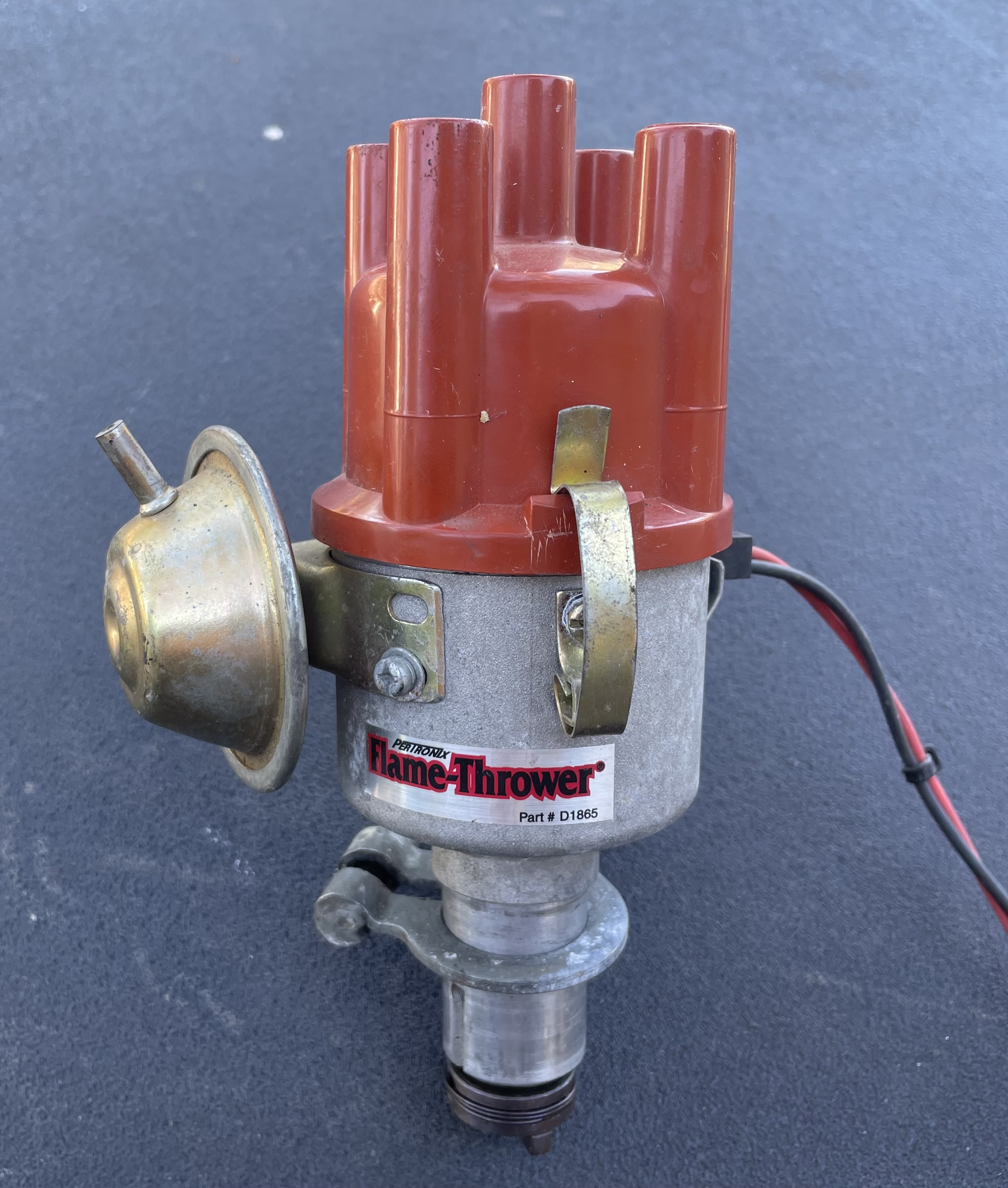

Interestingly @Superhawk996 posted documentation for the Flamethrower brand of distributor… well I also have one of those (an SVDA model) and was wondering..is there an advantage over what’s currently installed in my distributor? Would you guys pull the stock unit and installl the flamethrower?
914sgofast2
post Feb 2 2025, 04:05 PM
Posts: 782
Joined: 10-May 13
From: El Dorado Hills, CA
Member No.: 15,855
I f you are still running the Djet fuel injection system, I don't think the Flamethrower distributor will work, as it has no provision for operating the separate fuel injector points contained in the stock Bosch Djet style distributor. The Flamethrower will probably only work with your engine if you are running duel carbs, instead of the Djet FI system.
emerygt350
post Feb 2 2025, 07:07 PM
Posts: 3,423
Joined: 20-July 21
From: Upstate, NY
Member No.: 25,740
Or a single carb (IMG:style_emoticons/default/wink.gif). I don't think you will hurt much giving it a go. As long as the coil is in spec. Eventually if you don't like it's performance I would switch to a 123ignition. If you have fuel injection it's a whole different story, and it ends with a 123 as well.
Literati914
post Feb 2 2025, 09:03 PM
Posts: 2,174
Joined: 16-November 06
From: Dallas, TX
Member No.: 7,222
QUOTE(914sgofast2 @ Feb 2 2025, 04:05 PM) *
.. The Flamethrower will probably only work with your engine if you are running duel carbs, instead of the Djet FI system.
Thanks - I have another type4, a 'GA' based 2056 that came with dual Italian Weber 40IDF's .. but it has stock points. Now that you mention it, I think that's why I bought this Flamethrower to begin with. Back before I'd worked out a plan for which engine I'd be installing in which project car.

So, am I correct in thinking that the electronic points replacement unit ^ also eliminates the need for a condensor?
technicalninja
post Feb 3 2025, 09:39 AM
Posts: 2,531
Joined: 31-January 23
From: Granbury Texas
Member No.: 27,135
Yes, it does not use the condenser.
When I've installed optical or mag based points replacement like yours I've almost always installed a CDI box as well.
I sort of see those as two parts of a whole.
In the past the CDI box was also the thing that set rpm limits as well.
Some of the fancier CDI boxes had timing adjusters in them.
Most common of these pups were a reduce timing when XXX happens for boost or N02 applications.
These were crude and similar to what the 123 can do.
Now days the EFI stand alone can whip the shit out of the CDI box as it can control timing VERY accurately and do the boost/nitrous retards as SOP.
In today's world I'd chose a full-on stand alone to just do ignition duties over an old school ignitor and CDI box.
The modern way eliminates the distributor completely and allows waste spark or COP.

I just came across an old Dwell tester that I bought and used on my first 914 which had the original points set up .. do these electronic distributor inserts also eliminate the need for dwell adjustment ?
Jack Standz
post Feb 23 2025, 02:54 PM
Posts: 620
Joined: 15-November 19
From: Happy Place (& surrounding area)
Member No.: 23,644
Yes.
930cabman
post Feb 23 2025, 03:00 PM
Posts: 4,367
Joined: 12-November 20
From: Buffalo
Member No.: 24,877
QUOTE(Jack Standz @ Feb 23 2025, 03:54 PM) *
Yes.
No condenser, no dwell sure sounds like the EZ button for sure. I have been a dyed in the wool points guy, soon to change
