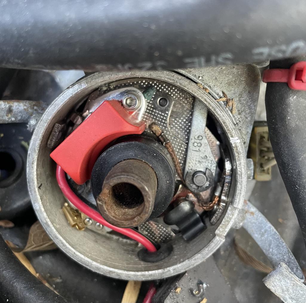

This electronic points replacement unit was installed on my 1.7 when the engine was rebuilt, just before I got the car (engine never started or reinstalled at that point). Now the engine is in (5 years later) and I’m getting ready to try to fire it up for the first time. I’ve turned my attention to the distributor and since I have no experience with these electronic inserts and no installation instructions or paperwork, would first like to know if anyone recognizes this particular unit? - it’s red and I’m only seeing black ones on type 4 when searching. And is there any glaring mistakes that you guys see to the installation?

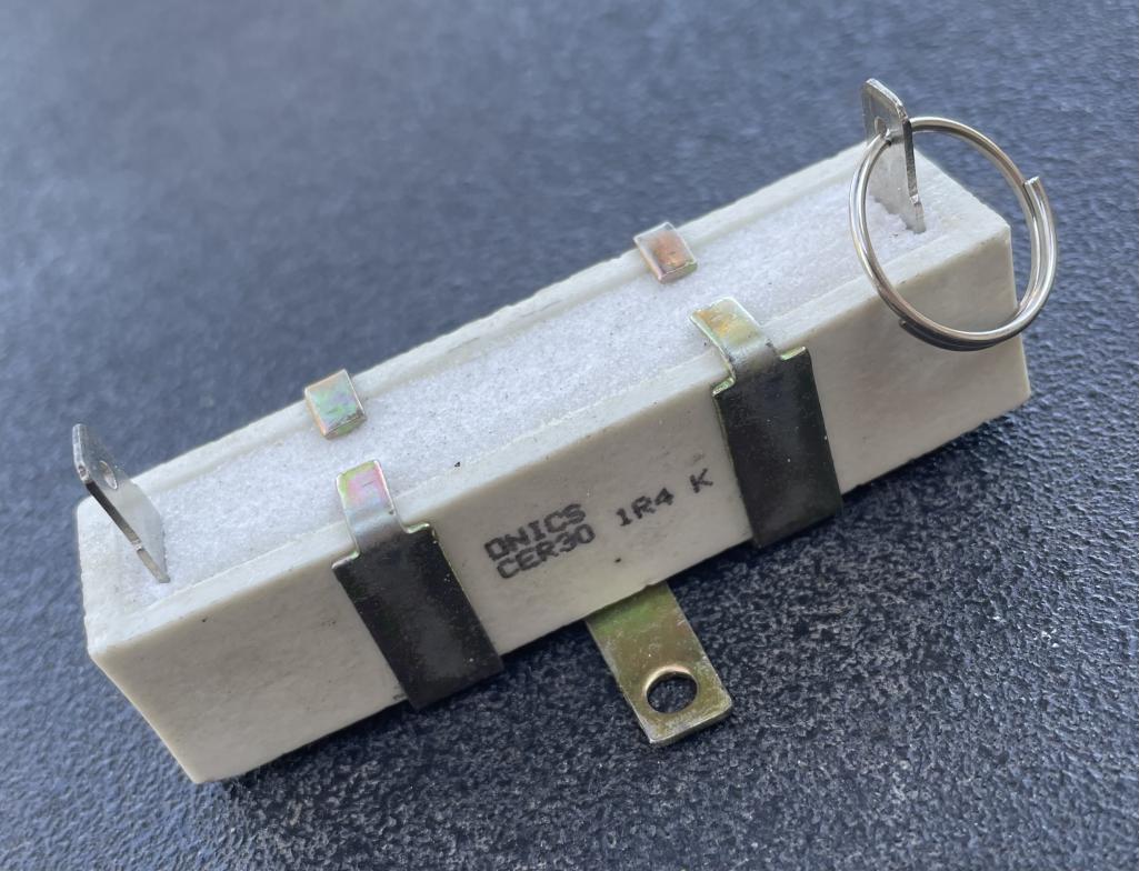

This ballast resistor was amongst a box of parts that came with the car, but not installed.. so I’m wondering why not (aren’t they recommended/necessary?).. if so, I’m not seeing a real convenient place to mount it, where are you guy installing these (I did a search for pics)?

I don’t recognize the electronic ignition and can’t comment on that.
Regarding ballast resistor, measure the primary side of the coil you intend to use. Should be around 3-4 ohms. If it has an internal ballast resistor don’t use the external resistor.
Using a coil with too low of primary resistance will burn points or will destroy an electronic ignition.

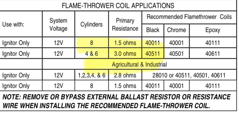

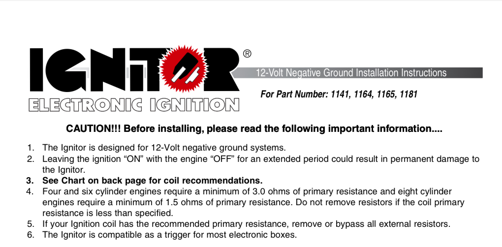

Here are the Pertronix instructions as an example:

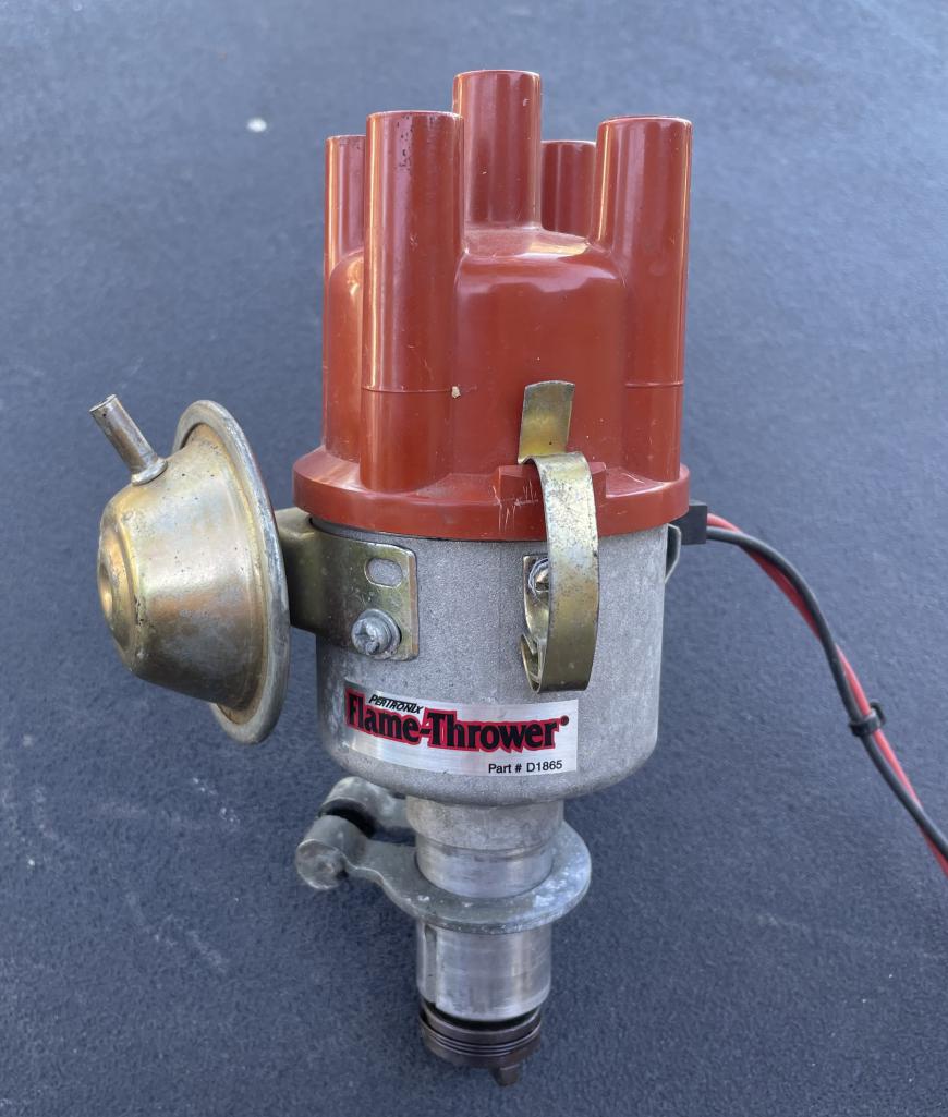

Interestingly @Superhawk996 posted documentation for the Flamethrower brand of distributor… well I also have one of those (an SVDA model) and was wondering..is there an advantage over what’s currently installed in my distributor? Would you guys pull the stock unit and installl the flamethrower?

I f you are still running the Djet fuel injection system, I don't think the Flamethrower distributor will work, as it has no provision for operating the separate fuel injector points contained in the stock Bosch Djet style distributor. The Flamethrower will probably only work with your engine if you are running duel carbs, instead of the Djet FI system.

Or a single carb (IMG:style_emoticons/default/wink.gif). I don't think you will hurt much giving it a go. As long as the coil is in spec. Eventually if you don't like it's performance I would switch to a 123ignition. If you have fuel injection it's a whole different story, and it ends with a 123 as well.
