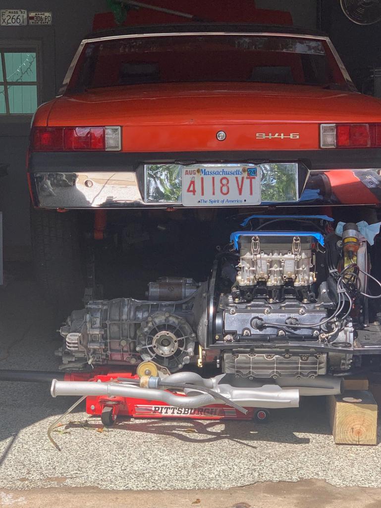

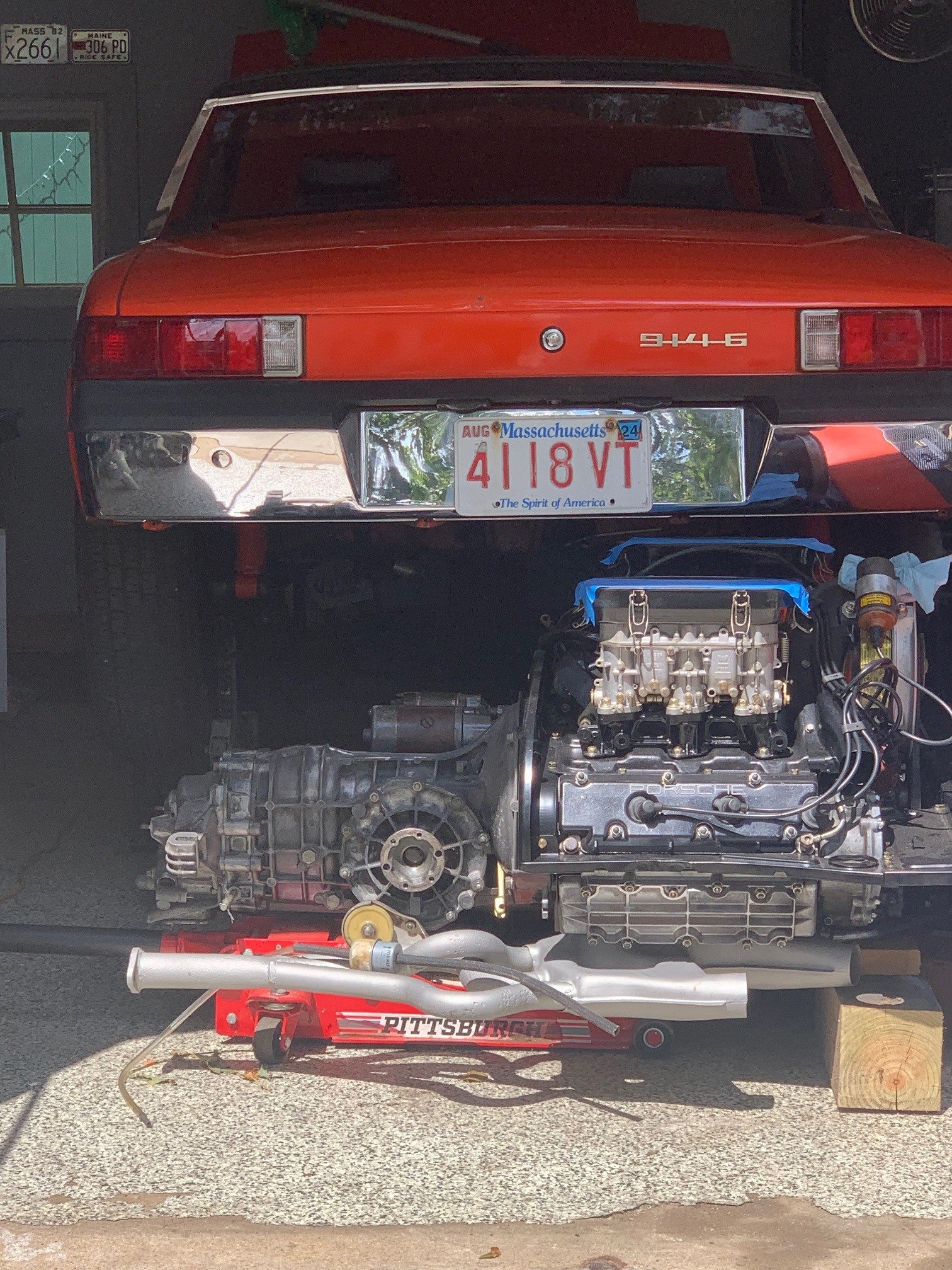

Engine ready to go, if you passed my house this is what you would see when the garage is open.

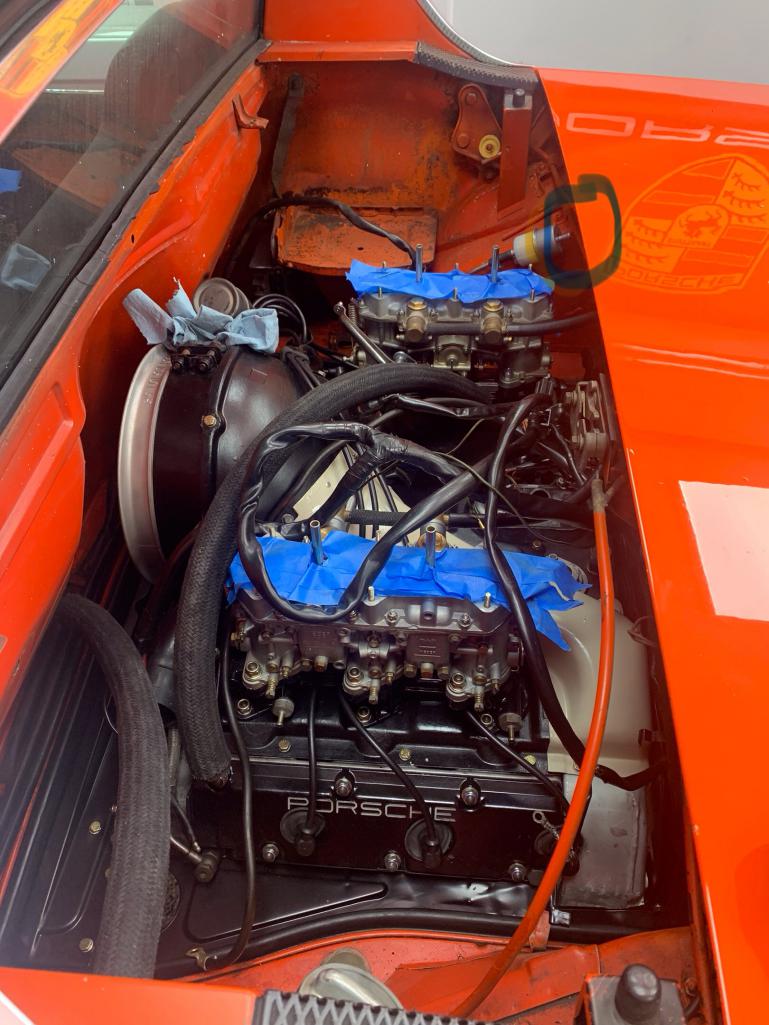

Got the engine in, hooked up the battery
Turned the key
Hhhhmmmmm, gas smell is pretty strong…………
Rebuilt engine baptism - 93 octane, look for the circle in the picture
AND
Filled the oil res with a quart, looked for leaks, none yet!
Started to put in another 5 quarts from a big gallon style bottle, funnel broke…. (IMG:style_emoticons/default/mad.gif)
Oil baptism on the other side
2 hours of cleaning or as I like to think of it: back sliding

Entire engine bay was dry iced, sprayed the areas where paint came off with flat clear
Looks rough, but the entire hell hole is in very strong shape, did not want a have-ass engine bay job, went with a cleanup and kept the ‘ patina’. (IMG:style_emoticons/default/biggrin.gif)

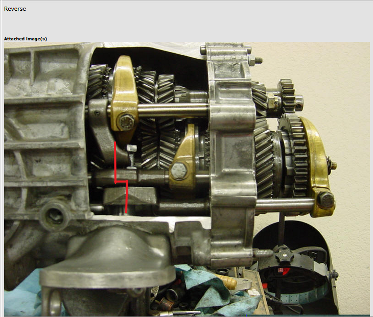

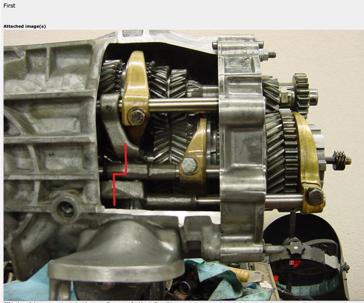

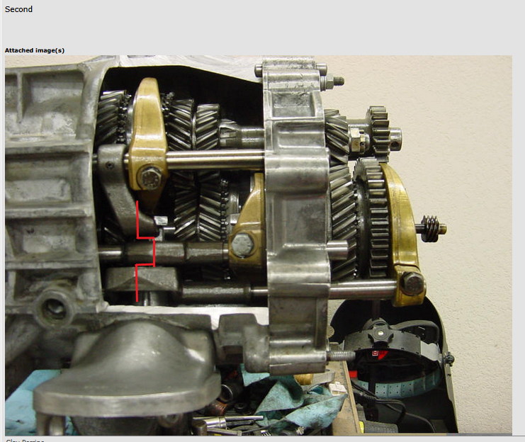

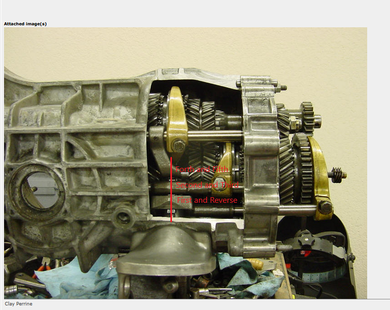

Transmission - Shifter
While I am chasing the 'carb-spitting' issue, I am also chasing the shifter being.....OFF
This is manifesting itself as the DREADED 1st to reverse problem.......As to the condition of the 901, gears are all within spec, new syncs 1st and second, new slider for 1st reverse - new dog teeth for 1st and second.
Let me explain,
When I put the car into 1st or reverse, I (as well all of you) push the lever from RIGHT to LEFT and feel the spring pressure of the shift plate.
About 1/4 of the way to the full extent of the spring compression the there is strong resistance. BUT i can CONTINUE to push to the left. I believe that I have reached the limit of the various linkage components and that what I am REALLY doing at this point is torquing the linkage. I can then continue to torque the linkage until I have reached the full travel of the shift lever spring plate
What happens is; when the shift comes out of 1st, there is no SPRING BUMP to push the selector in the transmission from the 1st-reverse position to the 2nd-3rd or middle position.
I have cut pictures from Clay Perrine's excellent 901 cut-away to depict what is happening
Transmission is in Neutral on the other side of the selector bars is a vertical channel, there is a knob that is in ONE of the THREE channels - when moved the selected bar moves left to right
Now, the knob is in the channel of the lowest bar AND the bar is slide to the left for FIRST GEAR
My shift LINKAGE - not the shift lever - when moved forward never gets the BUMP from the spring and as a result STAYS in the LOWEST position THOUGH the shift lever HAS moved to the right and you think that the shift is in the correct place BUT NO, it ends up pushing the SAME slider BACKWARD into reverse
OUCH!!!!!
What should happen is the selector should get a bump to the next position from the spring and end up here.
MY PLAN
I am going to adjust the Shift bar about 20 degrees until I do not get any mechanical loading, not sure if 20 degrees is correct......feels right.......
