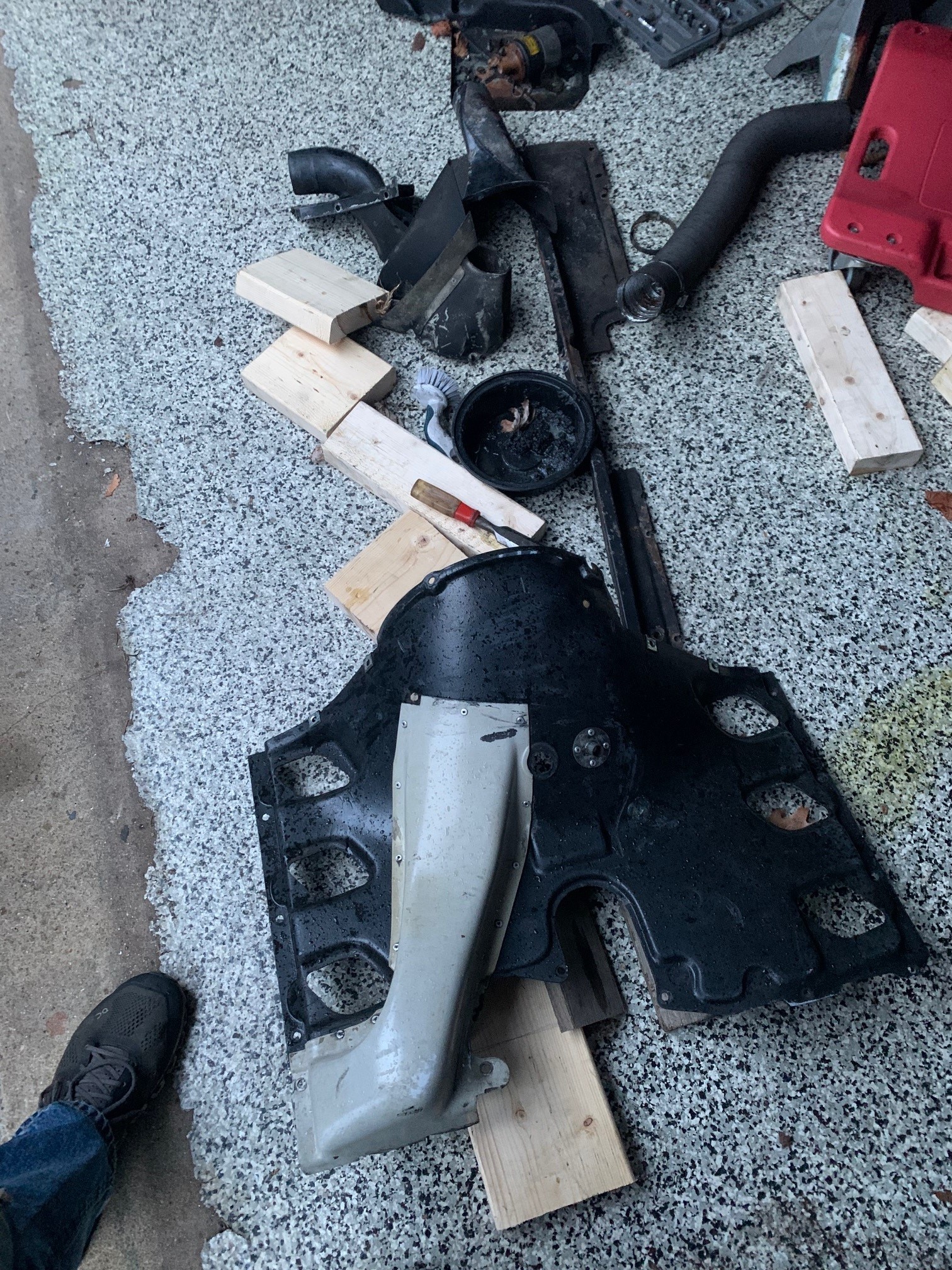

Spent a few hours this morning traveling to get a new flywheel from a fellow 914-6 owner - Thank you Mr. M!
Dragged the engine to the beam - when I rebuilt the garage I put in a beam, however, it is never where I need it so I had to squeeze the engine to the beam
Took off the tin and started washing it - perhaps 50 year of grime on the inside - in places nearly 1 inch thick. Scraped and then Dawn and a brush - will fine-tune the cleaning later
Tetris with the floor jack to get the engine high enough, the bean is rated for 4000, the pulley system around 2000 (so it says) and the engine is 400ish, still scary work, got the bolts to line up after realizing I was doing it wrong

********UPDATE*********
Heater Manifolds and all tin are being powder Coated
Tin = off gloss black, as close to factor color and shine as possible
Header Assembly = Gray Ceramic, a bit brighter than typical primer
Very Good Vendor in the Boston Area - Pike Powder Coat (IMG:style_emoticons/default/first.gif)
Also found a very good capable machine shop - I am taking a mil off of the face of the P225 so that it will fit the Dog Tooth

Took the valve covers off, they were close to finger tight - pretty certain that they were not torqued - if they were is the torque setting 'finger-tight'?
Head Stud Nuts all very tight - no broken studs, no leaking at the cylinders at either the head or the case.
The mating points between the covers and the cam housing are very dirty, will try and get them shiny and able to seal.
Also, the heat louvers are really looking good, a few coats of the green stuff and it all goes away,

Still cleaning the engine - took off the flywheel and all of the crevases were filled with a gritty oily grime, this is mostly cleaned, I see no cracks or other points of leakage, most likely is from the gasket
Spent a few hours cleaning all of the fins, lots of mouse parts and their house remnants were found (IMG:style_emoticons/default/dry.gif)
(IMG:style_emoticons/default/barf.gif)

Lots of progress getting rid of the grease and dirt.
I took a Scotch-Bright pad with a bit of de-greaser to the valve cover seats, seems that there was goo used in the past - leaking from these was extreme, lots of small lumps from legacy sealant?
Fan Cowling - could not believe the layers on this
Or this!
Fan is in the soup!
Oil cooler is very clean - was in the parts cleaner for 2-3 hours (30 minutes each run, turn and repeat) the inside has grease that is still making its way out - should be very clean - will power flush and dry prior to re-install
