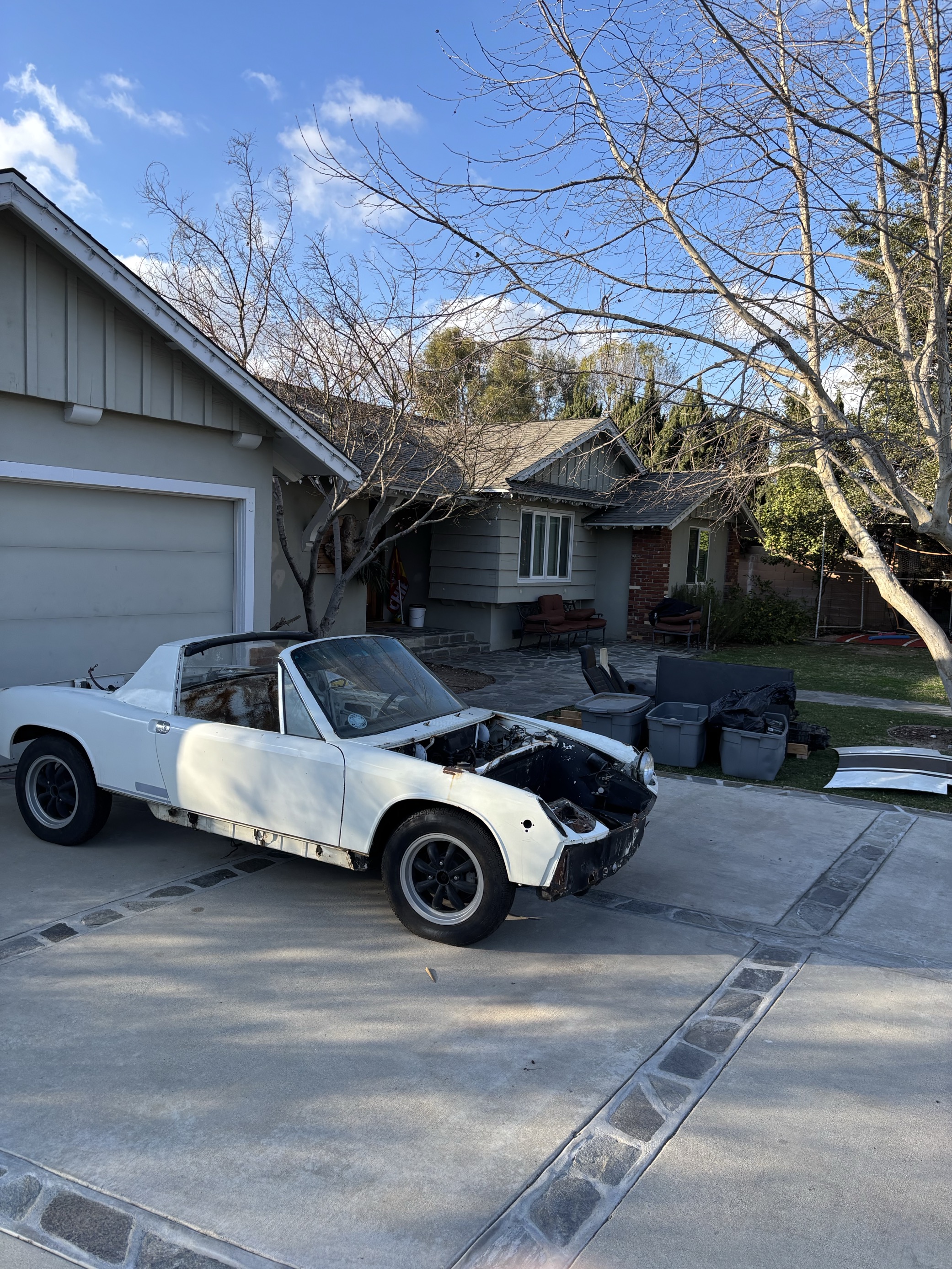

I actually bought two critters! a 75 and 73. Each has challenges with rust in the usual places, will require some panel replacements. But bodies are in great shape, both definitely have potential as a solid restoration.
Have always loved 914's, just something about them. looking for a fun driver, something that I can be proud of after the restoration. Level of "wrenching", comforatable with fab, welding, body work, engine work, the whole bit. Grew the son of a mechanic working on cars all summer long, restoring plenty of cars with my dad. The project is sure to bring back memories.
