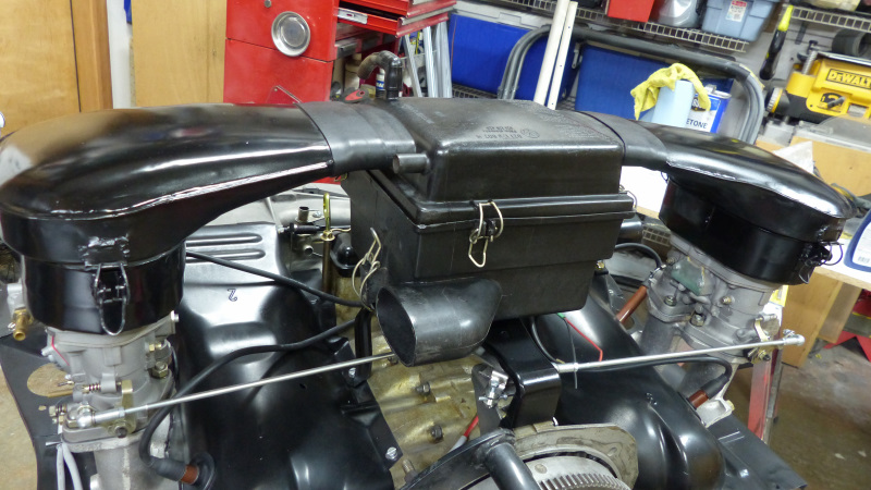

Another home made airbox system built from scratch by the late, great Brent Brock.
Note: these airbox systems are done to decrease NVH, not to mitigate fire risk.
