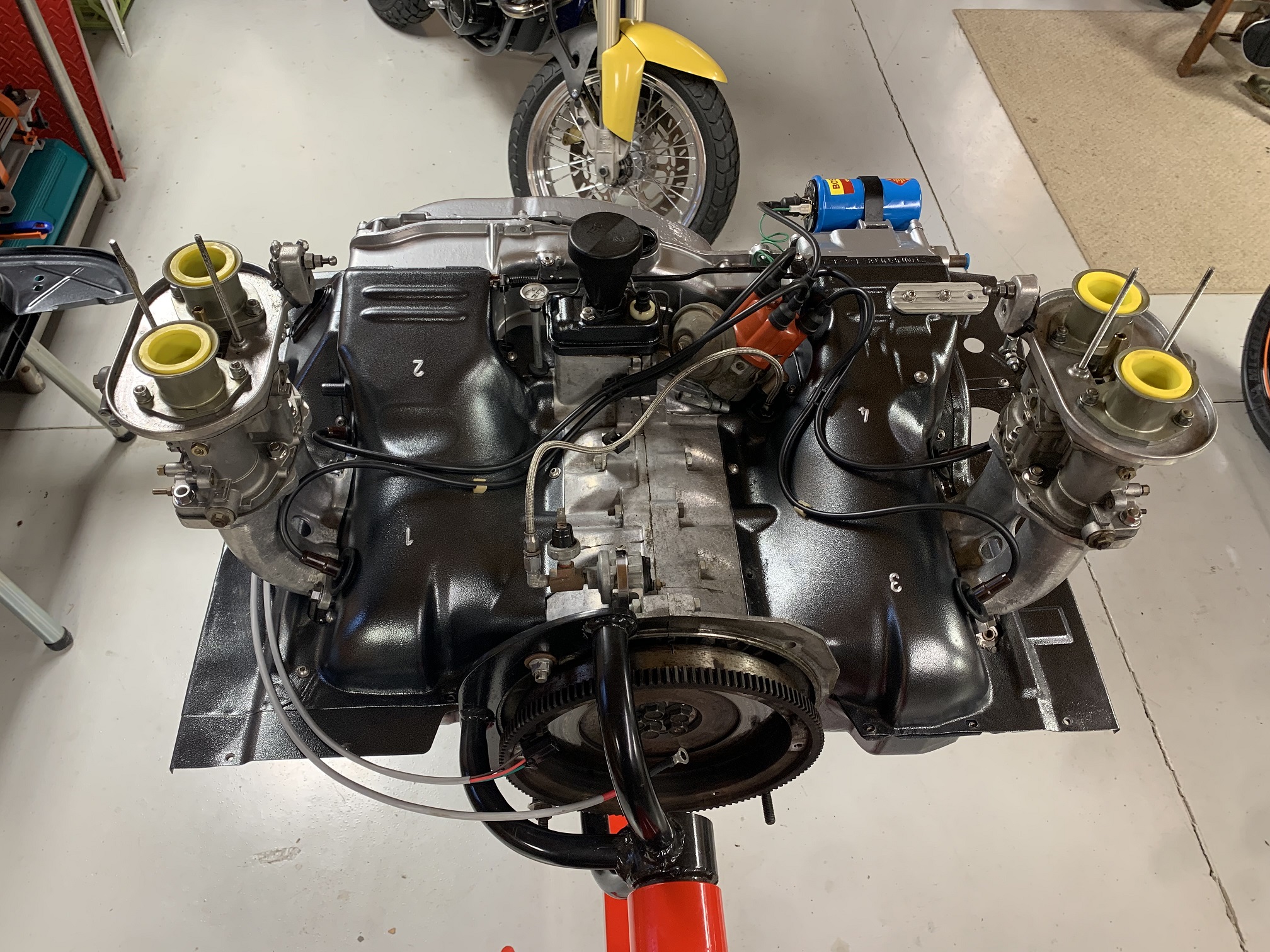

Having re-installed the distributor in roughly the same orientation as before this rebuild (the engine ran well), with the plug wires in the same orientation, I notice that the rotor is aligned with the wire that is for cylinder #2 when the engine is at known TDC for #1.
Rotor turns in a clockwise direction when engine is turned.
A pic...
Superhawk996
post Feb 27 2025, 12:15 PM
Post #43
Posts: 8,136
Joined: 25-August 18
From: Woods of N. Idaho
Member No.: 22,428
Follow the Haynes or factory manual to instill the dizzy drive and distributor
If what you have said is correct the dizzy drive is mis-installed. Each tooth is about 30 degrees of rotor rotation. Sounds like you are off by two or three teeth.

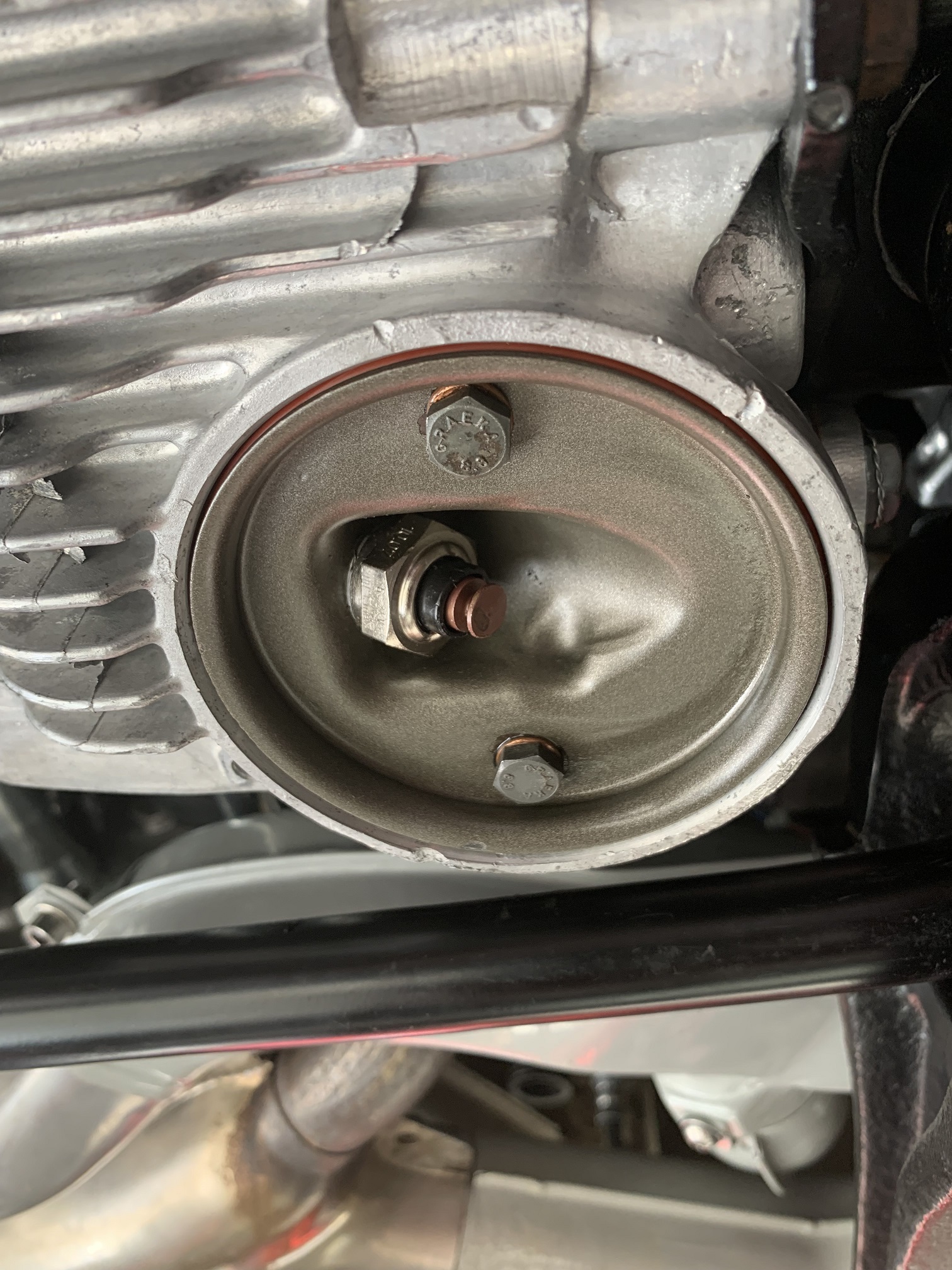

Moving on to some other fiddly projects. Oil pressure gauge in the cabin now functions (woulda been helpful 6 months ago). Oil temp gauge on this car has never worked. I discovered the fairly specific wire that connects the sending unit in the taco plate to the rest of the harness under the battery tray. Woulda been nice to know I had this before the engine went all back together, but I just found it in a box, inside of a box of spares that came with the car. That wire, which is very OE, will not connect to the sending unit. See pic below...
Seeing as I'm going to have to fabricate a wire anyway, what kind of connector attaches to that sending unit? Do I get a different sending unit?
I also found the cover plate for the taco plate that routes the wire up the front of the engine, so may employ that with my custom wire(ing).
