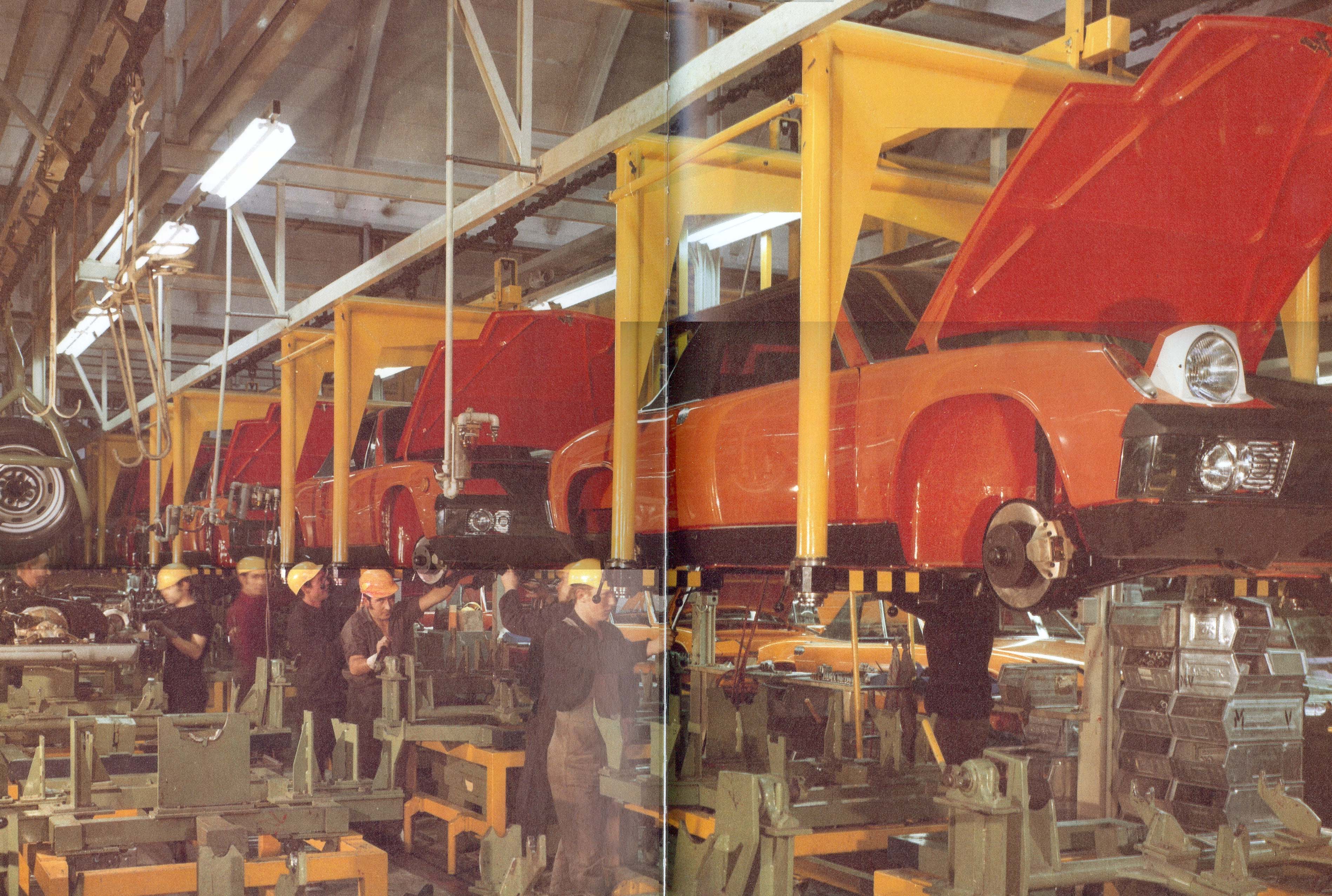

QUOTE(fiacra @ Feb 21 2025, 08:00 PM) *
I have heard some people say not to jack up the car on the doughnuts (the raised bits emergygt350 is talking about - I'll attach a picture to make it clear) but I think most of us do.
The donuts are not jack points, they have no structural support. The front ones literally just sit on the bottom side of the front floorpan and the rear triangle isn't much better.

QUOTE(SirAndy @ Feb 23 2025, 12:46 PM) *
@SirAndy . All well and good to say that, and to give someone the over top of the glasses librarian look, but not helpful if you don't actually share what jack points you are using/recommending (IMG:style_emoticons/default/beerchug.gif)

QUOTE(fiacra @ Feb 23 2025, 03:20 PM) *
In order:
- Stock jack posts (probably excludes a large number of 914s due to rust)
- Grooved metal/rubber top floor jack under the pinch welds on the longs (probably still excludes a lot of cars)
- Production assembly line "donuts" (who needs a straight floor pan anyways)
- Solid outer motor mounts (yeah yeah, i know)
If you want to jack up both sides either in the front or back, i prefer a piece of wood to spread the load.

QUOTE(SirAndy @ Feb 23 2025, 03:46 PM) *
So what are they?

QUOTE(SirAndy @ Feb 23 2025, 05:00 PM) *
In order:
(IMG:style_emoticons/default/stirthepot.gif)
Even though my stock posts are solid, I get nervous about the insert sliding out, especially with the car angled sideways. So I prefer using the longs, with a 1x2 piece of hardwood to protect the pinch welds and spread the load.
I do use the donuts for my Esco jack stands, but I also reinforced the inside of the floor above the front donuts.

QUOTE(emerygt350 @ Feb 23 2025, 06:13 PM) *
So what are they?
@emerygt350
That's where the factory attached the chassis to the conveyor on the assembly line ...

QUOTE(SirAndy @ Feb 23 2025, 08:22 PM) *
So what are they?
@emerygt350
Hmm, those 914s look rust-free, but I want them to pull off the outer rocker covers before I buy one. (IMG:style_emoticons/default/biggrin.gif)

QUOTE(SirAndy @ Feb 23 2025, 07:22 PM) *
So what are they?
@emerygt350
So, in other words, they are where the manufacturer decided was the best place to support the weight of the car.....

QUOTE(fiacra @ Feb 23 2025, 08:36 PM) *
A partially assembled car with the weight equally distributed to all 4 mounting points.
So unless you have a lift in your garage, that ain't how you would jack up your car.

QUOTE(fiacra @ Feb 23 2025, 10:36 PM) *
So what are they?
@emerygt350
the factory had the luxury of the 5 minutes the russian steel the 914 was constructed with was rust free. (IMG:style_emoticons/default/beerchug.gif) (IMG:style_emoticons/default/beerchug.gif) (IMG:style_emoticons/default/stirthepot.gif) (IMG:style_emoticons/default/beer3.gif)

QUOTE(SirAndy @ Feb 23 2025, 10:37 PM) *
(IMG:style_emoticons/default/rolleyes.gif)
Got it. Makes sense, although at some point they almost certainly had to have been supporting a fully assembled car. (IMG:style_emoticons/default/shades.gif) I do have a lift in my garage so it has been a long time since I've used a floor jack on either of my 914s. I just want to reiterate to the OP that you need to make a careful assessment of structural integrity before you pick the place to put your jack.
