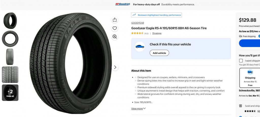

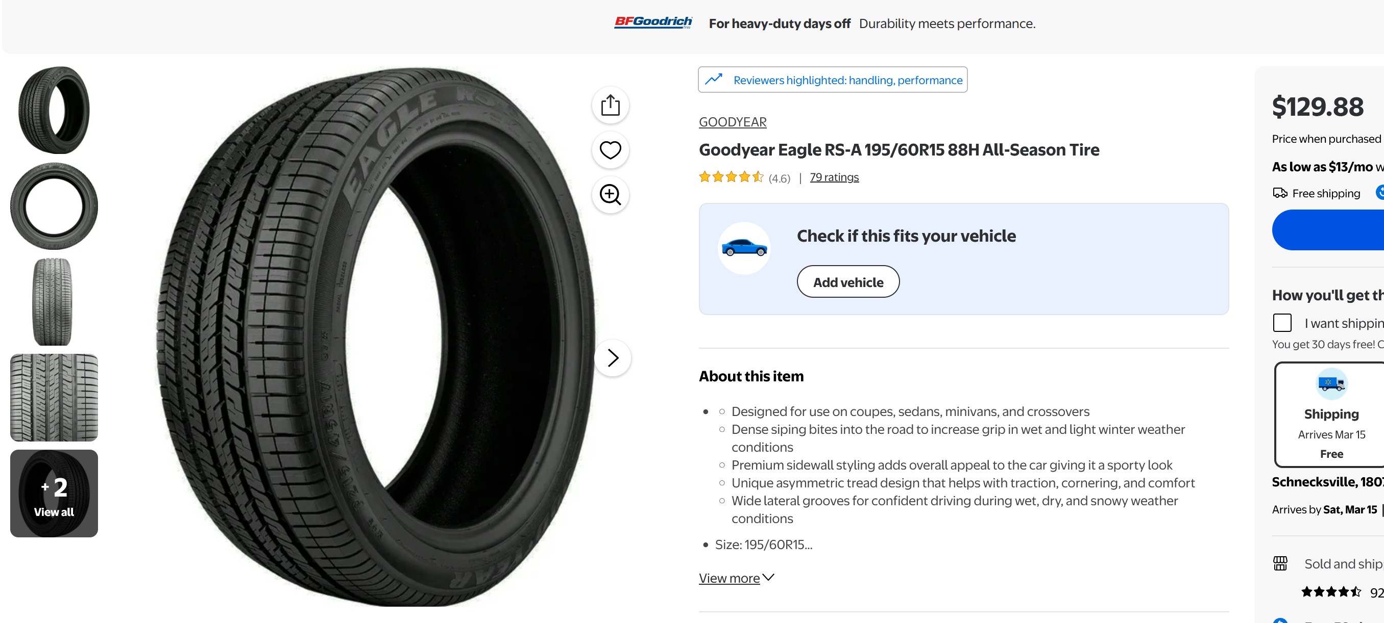

195/60/R15 look a lot better on the 914 and should fit on the car w/o adjustment.
There are less expensive tires than the Eagles but Eagles do grip well.

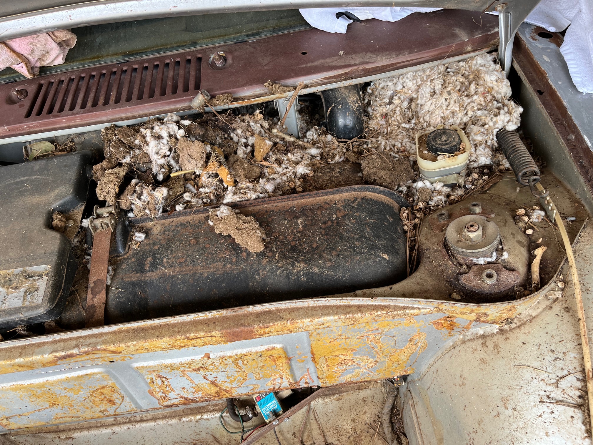

It's been a busy couple of weeks and I haven't done much to this car but I finally got the front boot open. The cable is still there and works but it took a minute to figure out were the release is to get it open all the way. Usually takes me a minute on any car to simply figure it out. I was hoping to find the headlight assemblies but no luck. I did find my very first every rats nest in a car though. I will never need to find another now that I have that experience. Thanks for all the tire information. no one locally could lead me to a source for 15 inch tires. I'll be starting to remove parts to inspect for rust and so on. I'll also pull the covers and see how the internals are looking. It apparently has about 75K miles according to the odometer. When I was trying to get the battery box mess off I did try hooking up a battery to it just to see if any power was getting through. Nothing happened but I don't recall if I even turned the key on. How can I tell what the original color for this car was. I haven't found any references so far. Finally, the Haynes book came on Friday. Lot's of good information there and an entire chapter on my favorite (not) thing, wiring diagrams, a nessesary evil. Back to work...

Interesting fuel pump location.

I was looking it over a couple of days ago simply to get an idea of where things are. After looking through the Haynes manual I realized I didn't know where the fuel pump was located or at least supposed to be located. Paying some attention I finally found it sitting right in front of me. This is an electric pump and an earlier comment mentioned this engine was originally fuel injected but was converted to carburetor. Is this even the right pump or just got left there? Looks like it has fuel lines attached but the electrical wiring is completely ruined. I'll need to figure out where it draws power and if it even needs to be there or if another pump has been installed in some convenient spot. This may reveal a general lack of sanity but I enjoy restoration work. Figuring out someone else's 'modifications' can be interesting to say the least. Two things I can't figure out are the original colors of this car and why the headlights were taken out. Starting to wonder if this was a donor car for another project. Considering where I found it I sort of doubt it but....

Without looking at the tag with the paint code, going to guess it's original color was silver.
You're making some good progress! Keep the pictures coming.
If your 914 is a 1975 or 1976, the fuel pump is supposed to be in the front trunk as shown in your picture.

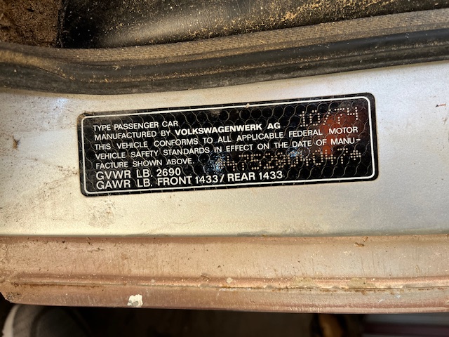

The sticker in the door frame says it was built in October of 1974. For an American car that would make it a 75 but for German built cars I don't know how they date them by model year. If it was built in 74 does that automatically make it a 74 or that late in the year would it be a 75? I'm not finding anything else to date this car.

Attached Image This is the vin tag in the driver side door frame.

QUOTE(Rick H. @ Apr 23 2025, 04:02 PM) *
Rick H.
75-76 impact bumper brace on inner fender well,, runs almost back to gas tank bulkhead,, see in mouse house/ fuel pump picture..
Bumper are big rubber things with a steel reinforcement....Or you could be lucky and he had some early chrome steel bumpers to back dte it.. (IMG:style_emoticons/default/idea.gif) (IMG:style_emoticons/default/popcorn[1].gif) (IMG:style_emoticons/default/sunglasses.gif)
