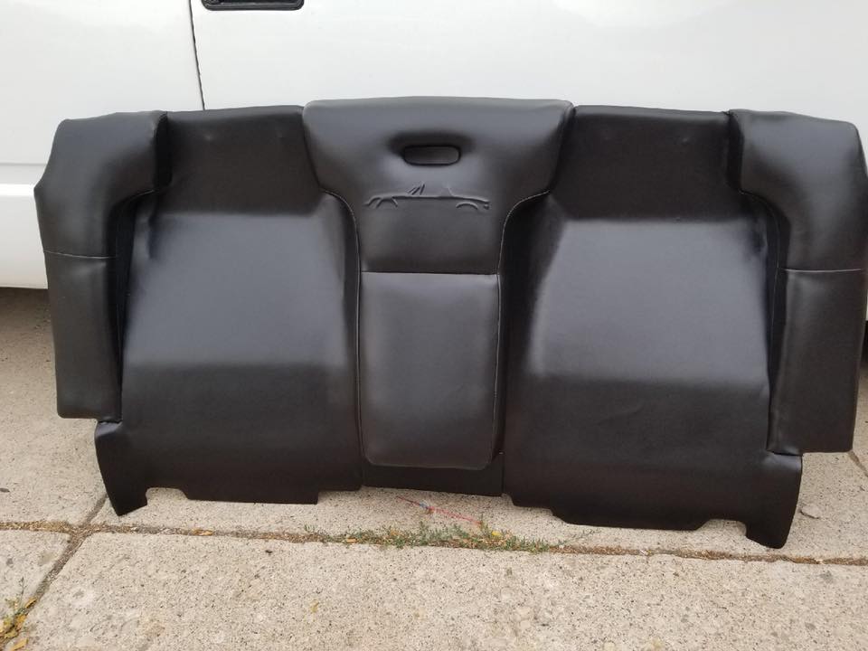

The main problem that I had with the 914rubber kit is that I needed to move the large outer foam pieces about 7mm because the upholstery wasn't cut exactly right. At best it was a hat trick but came out looking great. I think I took a bunch of pics. Let me find the link........here is the link with a few pics. I probably have a bunch on my camera that I didn't post. LMK if you need them. M ore importantly I show the hole spacing if you go the foam back pad route. http://www.914world.com/bbs2/index.php?s=&...t&p=3126821

absolutely the skill level. Our kits fit perfectly and if you could see the quality our "girl" Nora accomplishes when she recovers the backpad, you would be WELL pleased!!!
