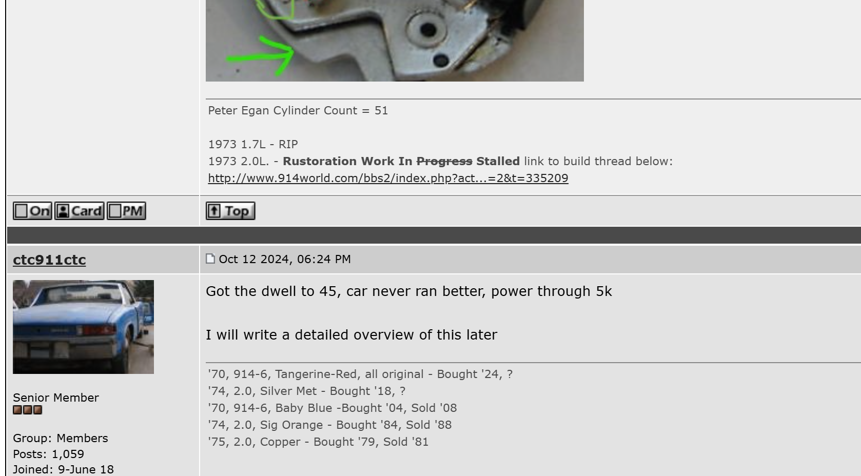

My 914 mentor, Richard Towle would say that for the Djet
1. Compression
2. Vacuum
3. Fuel - check all injectors
4. Spark - check all plugs
5. Dwell - more important than timing
These need to be solid, everything else is, to some degree, tuning.
A great deal of attention is always paid to those things we do not understand. ECU, Pressure Sensor, etc. Ignore these and focus on the basics, once you are certain that the basics are in place, then move to the more detailed systems. I ignored the dwell, Richard called me a few times and told me GET THE DWELL RIGHT and I listened. Thank you Richard! RIP......once I got one of the basics solid, lots of little stuff disappeared. Hot Start, idle bizareness, rich/lean results, etc.
The note below is my experience late last year, I did everything to the car with the exception of dwell, I could not get my dwell angle set with my Distributor (which I rebuilt) so I purchased another, Dwell angle set to 45 first time and the cars performance increased 2X. My old distributor for reasons yet uncovered, could not set a solid dwell angle.
