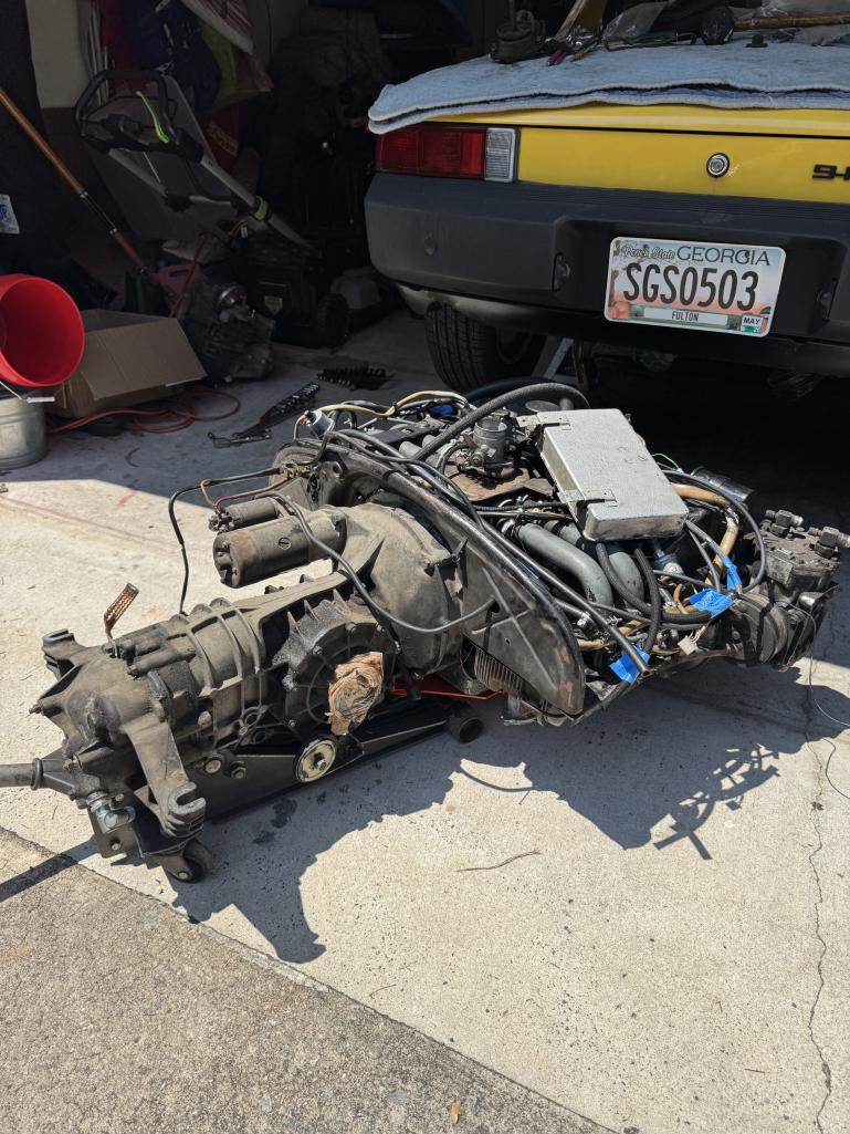

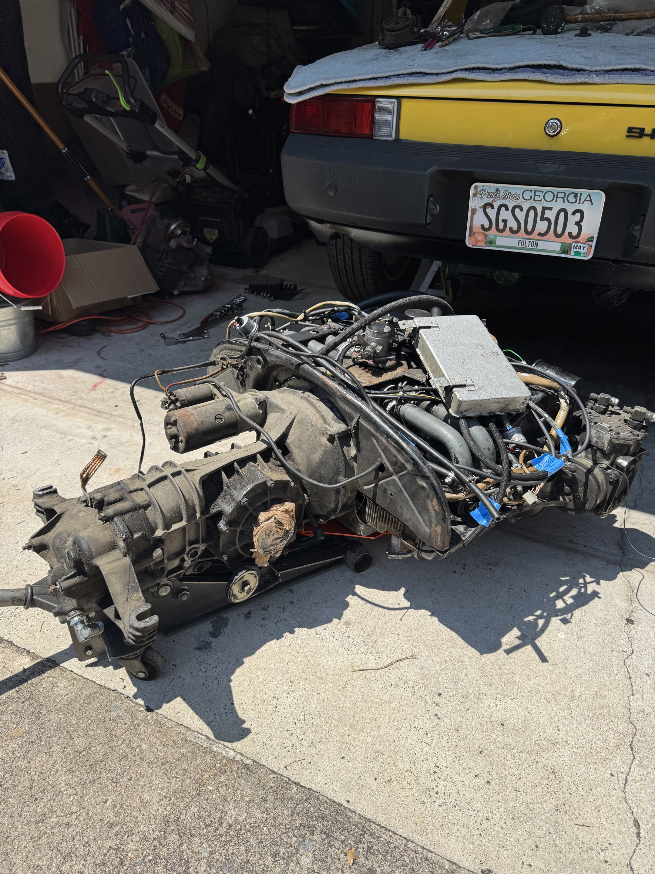

Got the car back from AutoAtlanta and dropped the engine. Now the fun begins!Attached Image

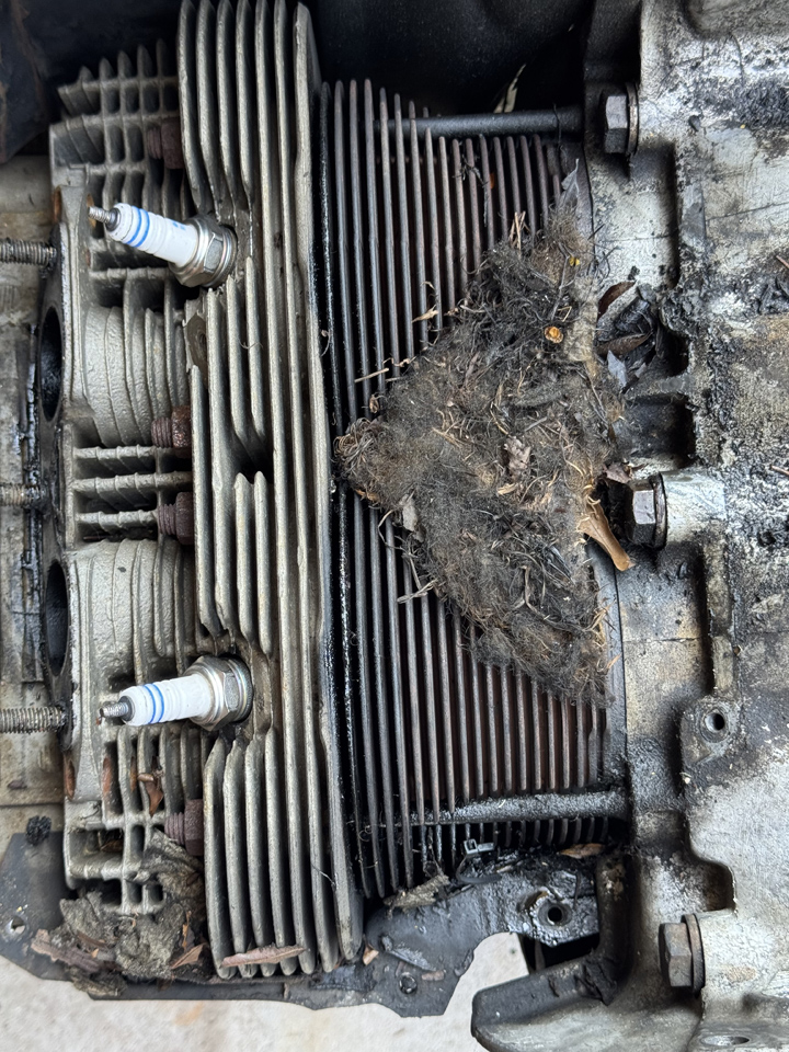

Member No.: 27,780
QUOTE(Superhawk996 @ Mar 18 2025, 09:49 AM) *
Got it - agree; set aside cooling issues for the moment as not likely related to the cold start issue.
What I’m trying to get a sense of is whether there is some underlying fast overheating (ie mouse house in the tin) that would quickly confuse the Fuel Injection by maybe starting too rich but very quickly going too lean to re-start if the 3/4 side head when the CHT is overheating.
Well, I should have listened, but knowledge is hard to come by. Pulled the tins, and there was a bit of a mess in there. Appears to be mostly fiberglass insulation and leaves.
Superhawk996
post Jul 5 2025, 06:01 PM
Post #146
Posts: 8,058
Joined: 25-August 18
From: Woods of N. Idaho
Member No.: 22,428
It happens to the best of us. Trust me I’ve learned the hard way about mouse houses too. (IMG:style_emoticons/default/beerchug.gif)
