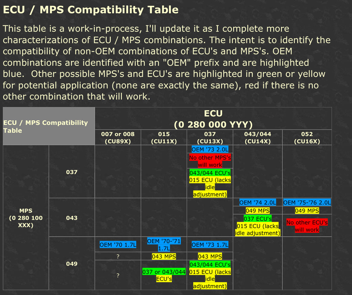

The MPS is the "Euro" version. I had a 043 and when I went by AA George Hussey recommended going with the 037 "Euro" part instead (and he had those, but no 043s). And yes, have vacuum tested the new part several times (IMG:style_emoticons/default/smile.gif)

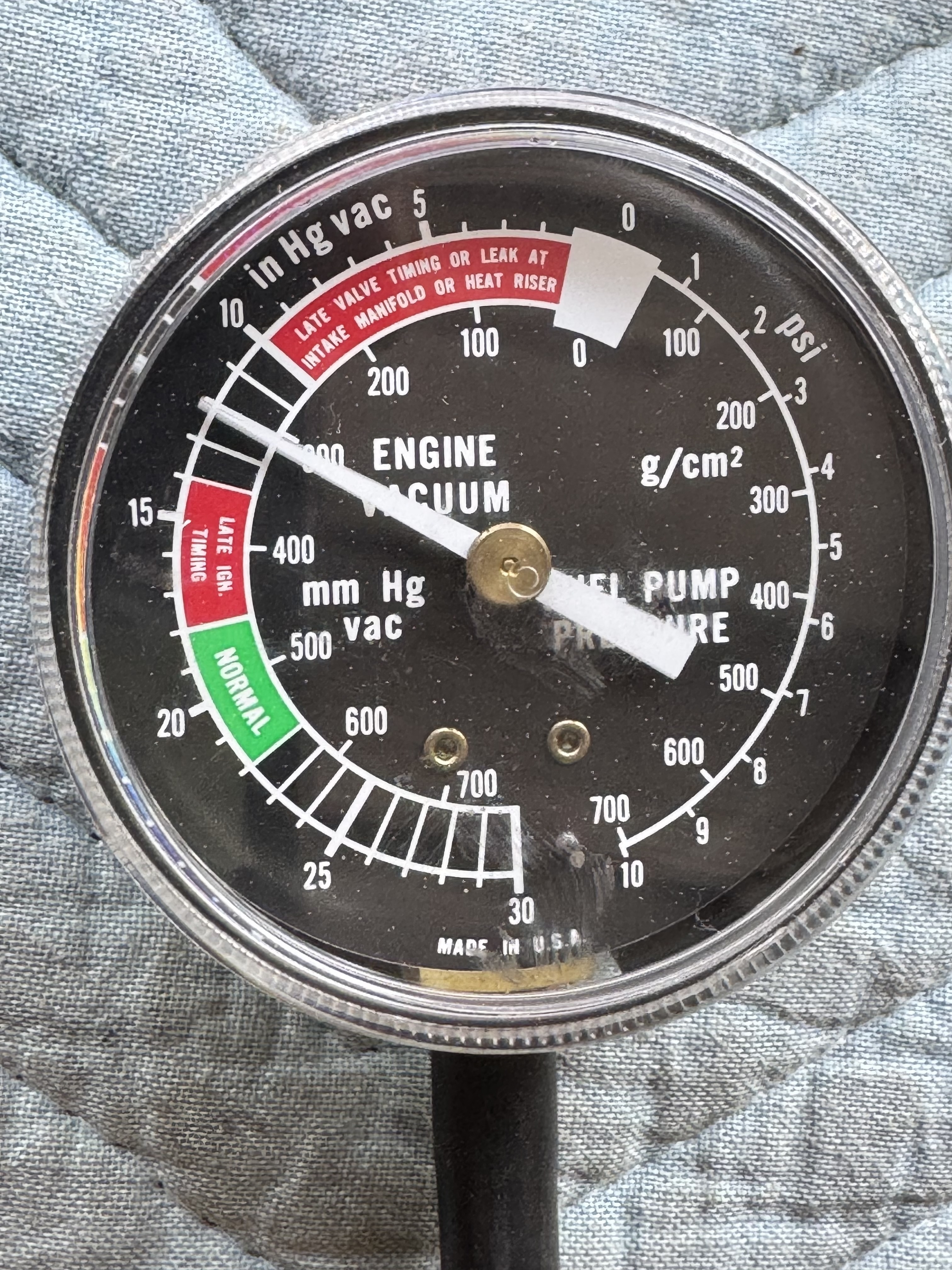

If it isn't pulling enough vacuum it could be your valve job....

I checked the vacuum at idle...and it is pretty bad: https://youtu.be/XOzUYy50ztY
Guess I'm going leak detecting again...maybe I need to check the valve adjustment I did again?
Toward the end of that video, I have the vacuum pump pulling on the MPS, and the idle speed increases significantly (until I hit around 15 inHg, where it dies).

QUOTE(Blue Lightning @ Mar 23 2025, 05:49 PM) *
So AA is back up to the old tricks? (IMG:style_emoticons/default/chair.gif)
Parts should not be mix and match. An 037 is not an 043 which is why it has a different part number.
The 037 is for the 73’. However, the 73 1.7L and the 2.0L use the same ECU and have some “tricks” played with the CHT and the calibration of the MPS to differentiate the calibrations to compensate for the 1.7L to 2.0L displacement change while using the same ECU. Both the MPS and the EcU for 73’ are different than the 76’ setup.
I assume you’re aware of the Brad Anders parts lists and the recommendation not to mix and match.
The MPS you have can be retuned but that isn’t part of what you bargained for. There is some bench calibration that can be done but per the guys (like Emery) that have retuned their MPS, you will really want to tune it on-road with a wide band air fuel meter.
Don’t get me wrong, I don’t think all of your difficulties are related to the MPS.

Let's get that low vacuum figured first. 2 common easy things will directly result in lower vacuum. Over tight valves. Good to check that, did you do the crusty method when you adjusted them?
Second is timing. Which also plays into that poor startup. We could be looking at a combination of the two.
Glad to see how much of an effect the mps had while it was running.
emerygt350
post Mar 24 2025, 06:33 AM
Post #60
Posts: 3,737
Joined: 20-July 21
From: Upstate, NY
Member No.: 25,740

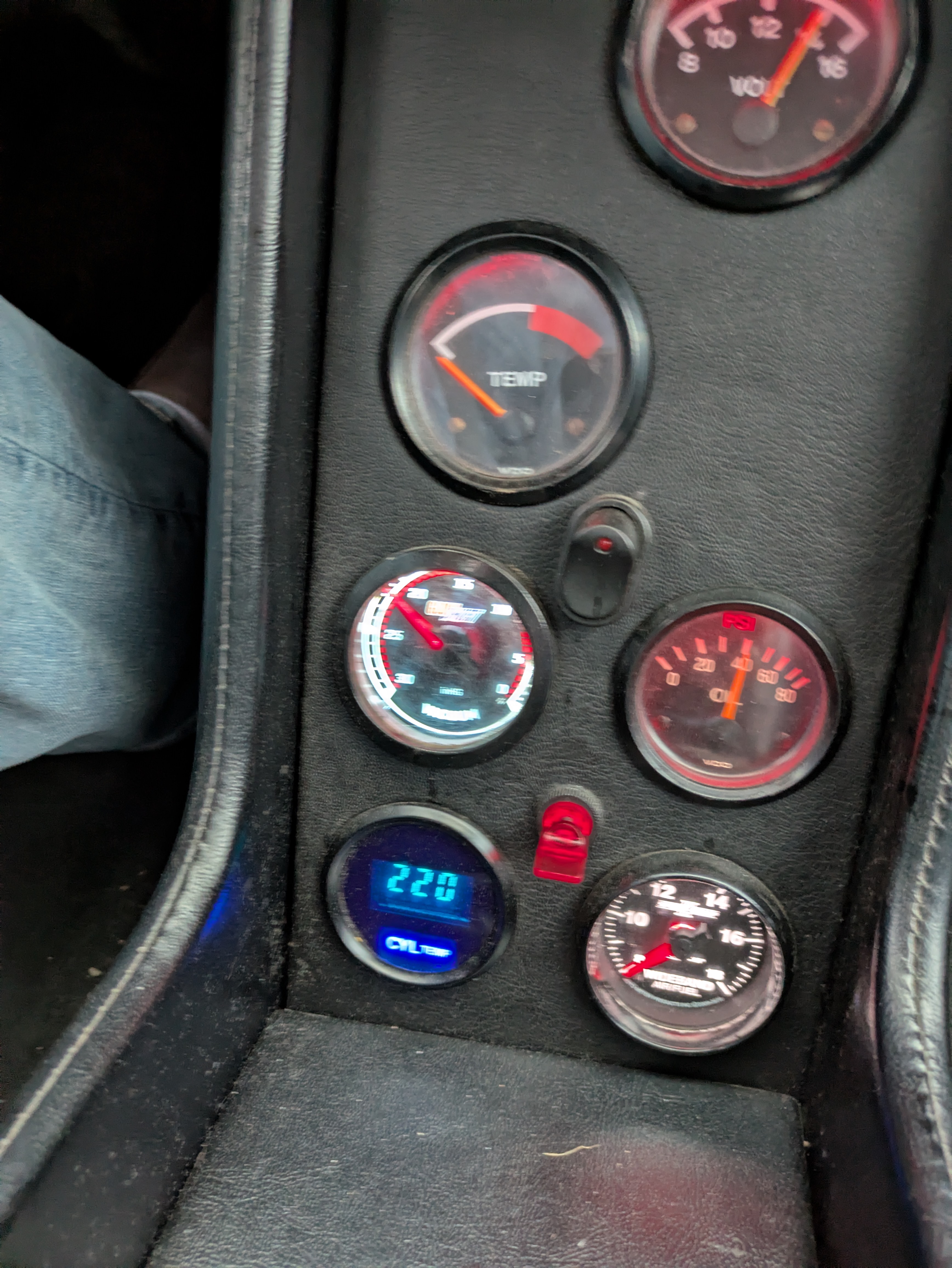

Here is a video of mine at cold start this morning. You can see how the vacuum starts and where it is after a minute and a half. The video starts maybe 5 seconds after I started the car. Didn't think of it till I started otherwise I would have recorded that for you too.
https://www.youtube.com/shorts/-owQvPa68sc
Don't mind the wonky AFR, it takes forever for that thing to kick on.
Here is where all the needles are after my 1 mile commute to work.
