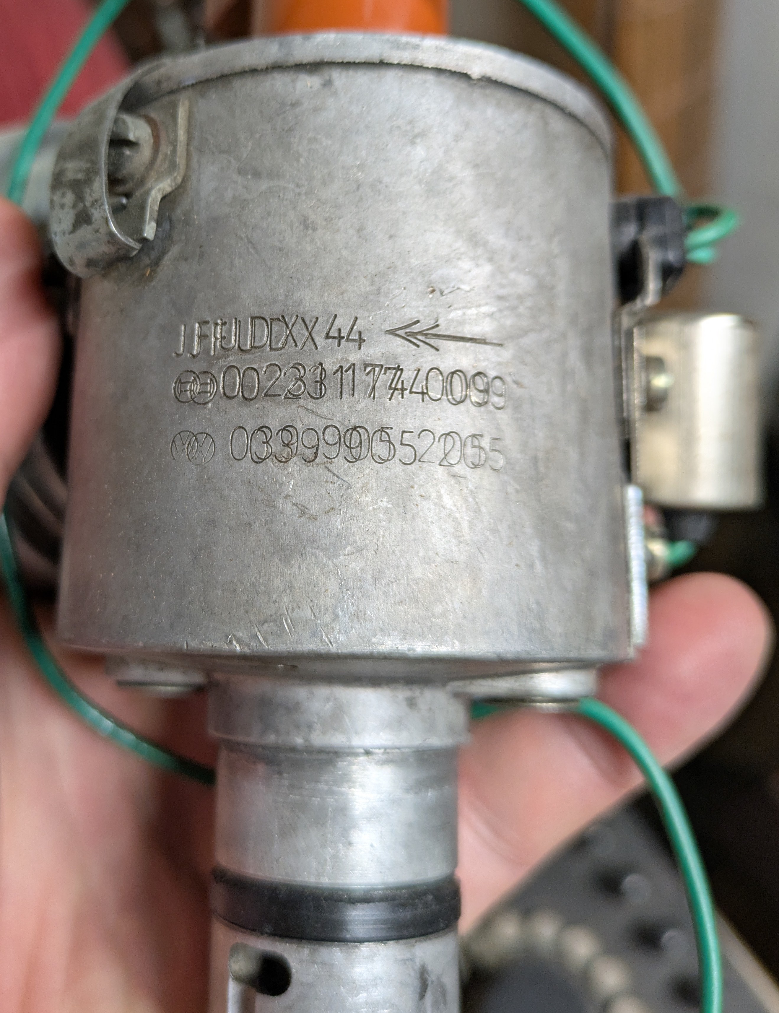

The parts in the engine current are:
Engine: GC (correct for '76 2.0)
ECU: ??? (no sticker...only way I know is to open the case, which I didn't have a reason to do...yet)
Fuel Injectors: 0 280 150 038 (correct for '76 2.0)
CHT: resistance/temp curves are consistent with a 012 (correct for '76 2.0)
Thermotime: ??? (not cold enough out for me probably ever to need)
Deceleration Valve: ???
MPS: 037 (now incorrect)
Distributor: 011 / 205A (for '76 2.0 GA-series engine; correct for GC would be the 021 / 205B)
I've spent time looking at the differences between the 205A and 205B distributors, but have not found anything (this is the best reference I have found for the 205A: https://web.archive.org/web/20031213100259/...h/distrib.html)
I've read some stuff on retuning your MPS, but at some point you should just put in a megasquirt or something that and take advantage of a WB02 sensor and maybe have some closed-loop idle control (IMG:style_emoticons/default/smile.gif)

Don’t sweat the distributor too much - the differences are related to the advance curves and what type of vacuum can they used.
