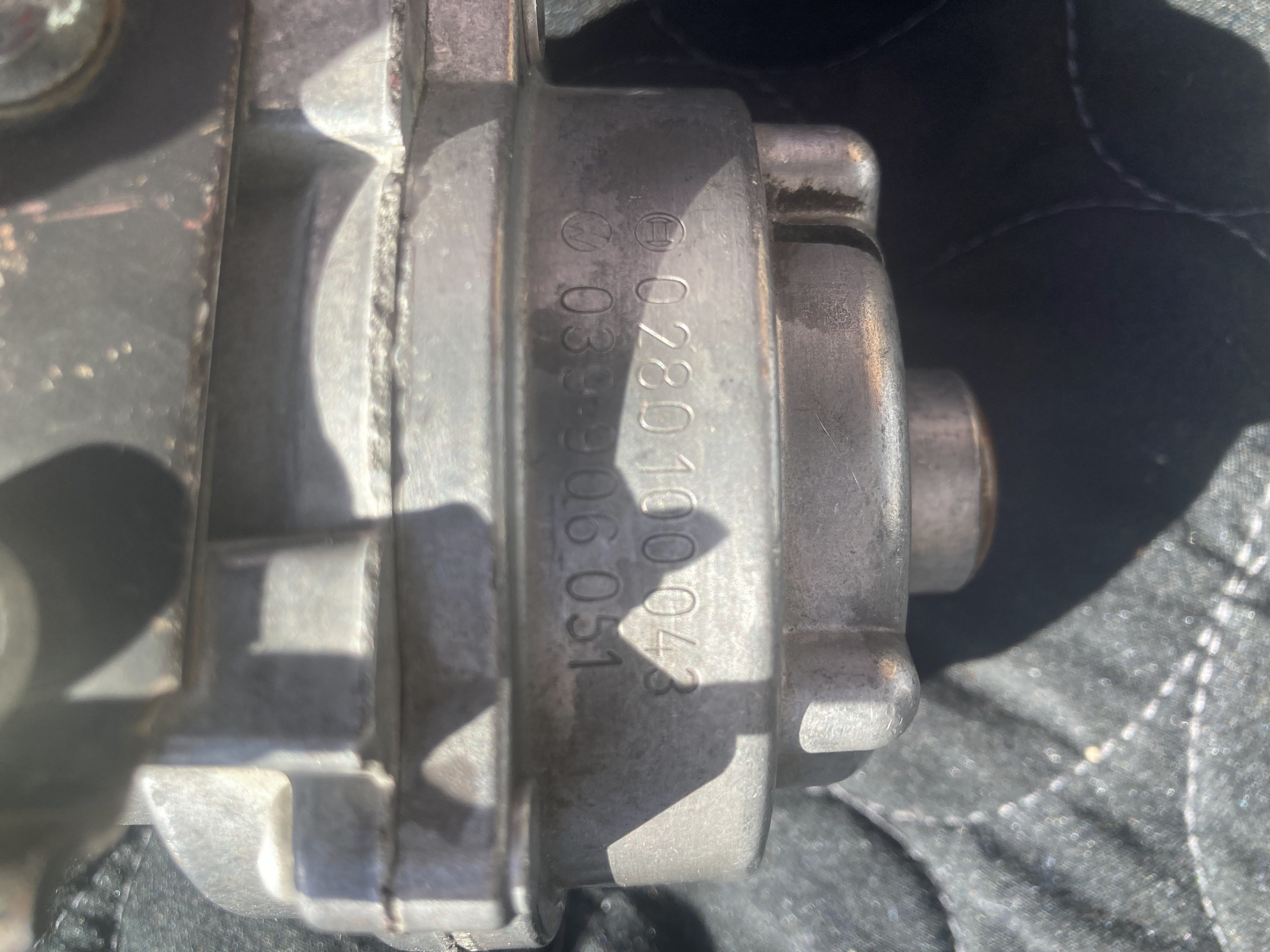

@Blue Lightning
Here are a pictures of again what I think are an original MPS and decel for reference

QUOTE(Ron914 @ Mar 27 2025, 10:40 AM) *
[b]
Thanks, but I think that second one is the fuel pressure regulator?

QUOTE(emerygt350 @ Mar 30 2025, 05:32 PM) *
That oil seemed to heat up pretty quick. Makes me think there is still a timing issue. My oil won't hit 220 unless I am really giving it the beans and it's hot outside. 220 is fine of course. Was it hot down there today?
Is the decel valve back in the mix? That can cause a slow return to idle.
Not particularly warm today (~70F).
Bought a new (used) decel valve, and it is installed. But it is adjusted to very high vacuum so I don't think it is doing anything at this time. It's on the list to play with this, but didn't make it to that today.
Going to try swapping the distributor and the coil to see if that has any effect. But will not be until next weekend (or maybe the weekend after).

Return spring is good right? Throttle moves easily?
