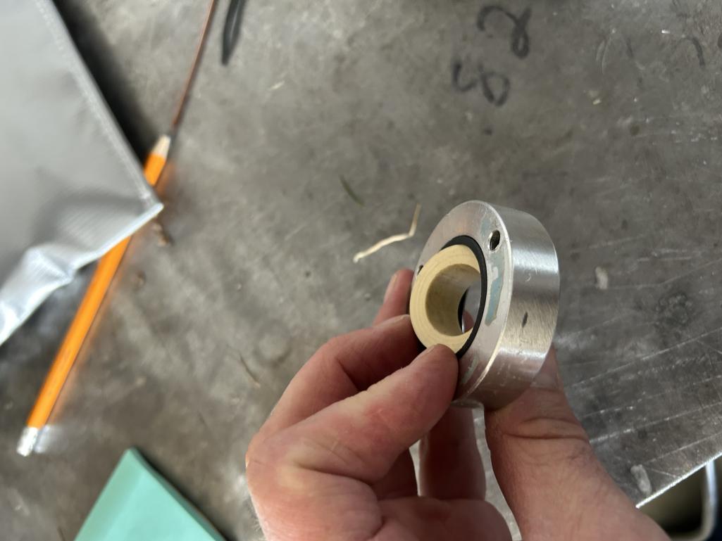

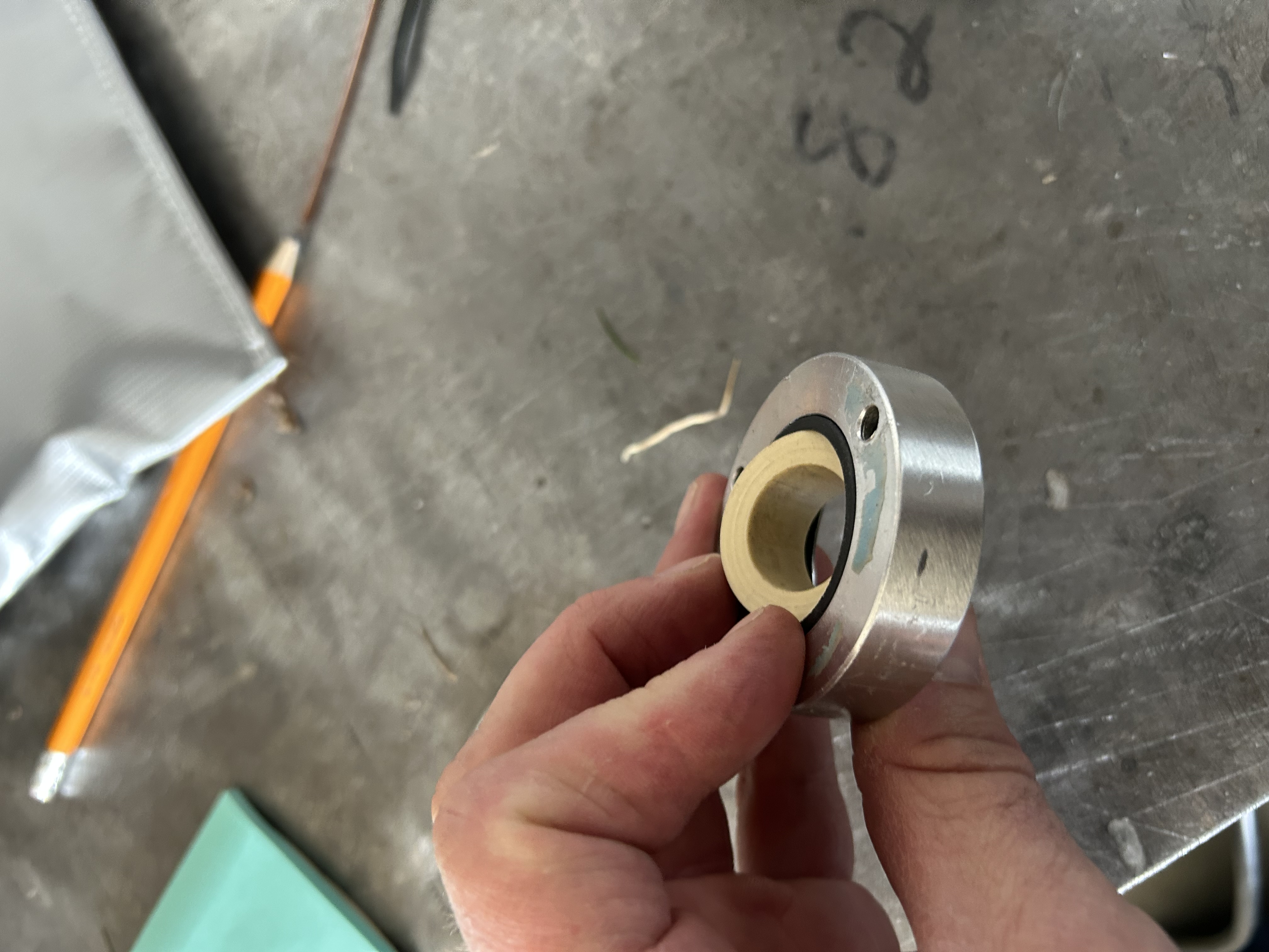

Problem solved. The bushing was installed correctly but was just too thick. Removed .100” of an inch and all set. Works good now. Thanks everyone
914werke
post Apr 13 2025, 04:39 PM
Posts: 11,709
Joined: 22-March 03
From: USofA
Member No.: 453
QUOTE(mb911 @ Apr 13 2025, 11:52 AM) *
Can you show a pic or diagram of where or how to help folks in future?
mb911
post Apr 13 2025, 05:35 PM
Posts: 7,794
Joined: 2-January 09
From: Burlington wi
Member No.: 9,892
QUOTE(914werke @ Apr 13 2025, 02:39 PM) *
I am not sure how to really explain it with more detail. Basically it’s about .575” thick so I brought it down to .475” and all works now. Attached Image
