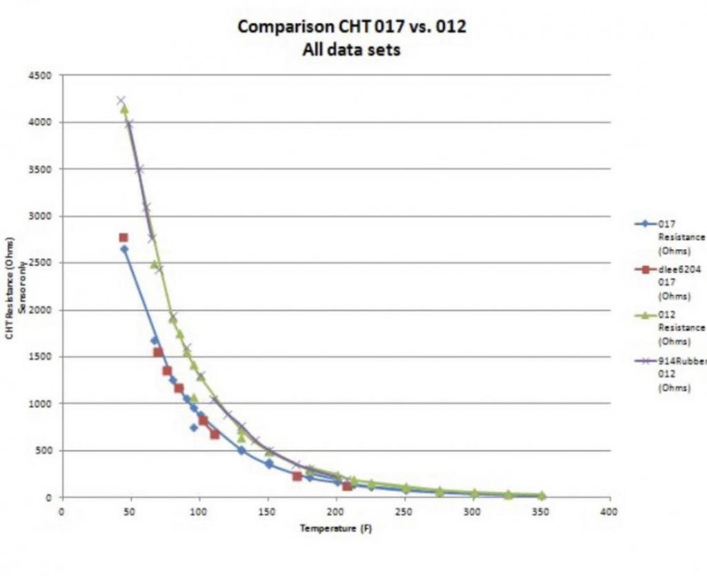

Car is a '73 2.0 with factory D-Jet. I installed new Standard Products FJ67 injectors, and the fuel pressure is 29 psi. There are no leaks in the intake side, and the idle adjustment screw is about 2 turns out (so there's plenty of adjustment available in both directions). The MPS hasn't been messed with, and the ECU looks like the correct unit. All new vacuum lines, fuel lines, pump & filter, and fresh gas. New @JeffBowlsby engine and alternator wiring harnesses.

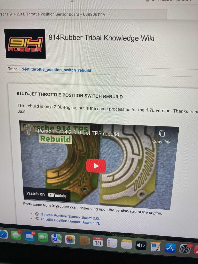

Known issues: it has the wrong CHT sensor (it's the one that's commonly available) and I think the TPS board has worn traces. I finally found the right CHT and ballast resistor, and I also have a 914Rubber replacement TPS board, and I will install both of them when I get a chance. However, I don't think either of those should keep it from idling at a reasonable RPM.

Superhawk996   Known issues: it has the wrong CHT sensor (it...   Apr 18 2025, 07:17 PM

BillC   So, I installed the 017 CHT and 270 ohm ballast re...   Apr 19 2025, 03:58 PM
