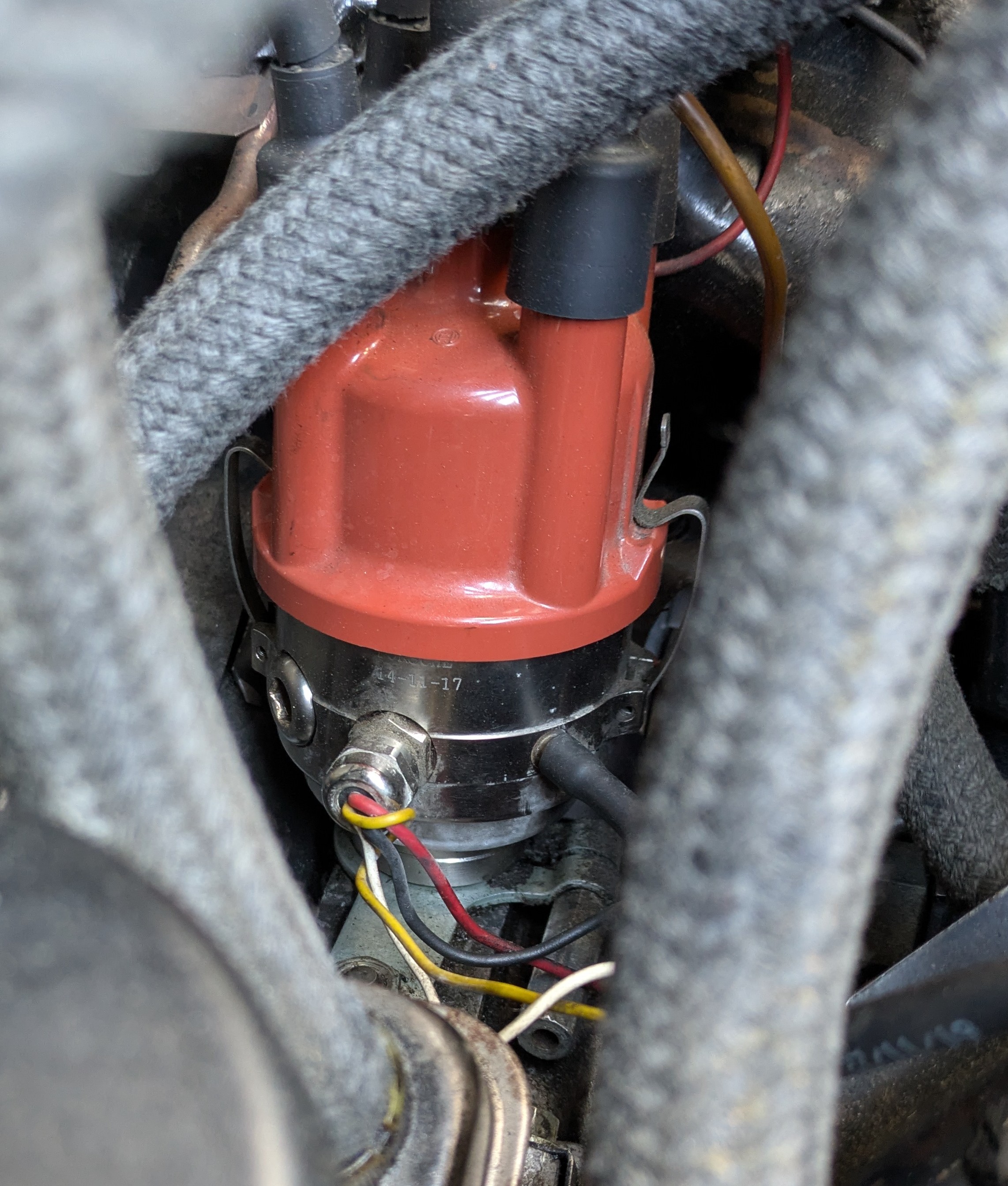

QUOTE(emerygt350 @ May 26 2025, 06:33 AM) *
Put the dizzy on 1 but don't bother hooking up the advance. Disconnect all vacuum hoses and plug them. Put the mighty vac on the mps. Give the mps 17-20 inhg. If the idle is still high, retard the timing and see what happens.
I'll give it a try next time I have a chance. However, it's a pain to change settings on the distributor, since it means pulling it out and then checking/adjusting the advance afterward.
Switching to 1 isn't crucial, just better in case you want advance. You don't want retard. It just doesn't work on the 123. The dizzy is set to turn on at some small level of vacuum where the original was meant to be much more analog.
I have mine set so I can access the pot with the dizzy in the car. I use a little mirror on a stick. Super easy. If your dizzys vacuum port is pointing towards cylinder 1ish you can do it no problem.

QUOTE(emerygt350 @ May 26 2025, 05:46 PM) *
QUOTE(BillC @ May 26 2025, 03:31 PM) *
Okay, I changed the distributor to "1" and plugged all the vacuum ports. And..... no difference. It will still hang up around 1600 RPM and then slowly start drifting down and stalling. I even tried connecting the MityVac to the MPS and setting it to 17" vacuum -- no difference, it will not idle where it should.
Also, drivability is noticeably degraded from when it was on the "A" setting with retard vacuum connected. Not horribly worse, but it just doesn't work quite as well. So, I'm going to set it back to "A" with retard vacuum, and will just live with it until @JamesM finishes that MS system for me.
