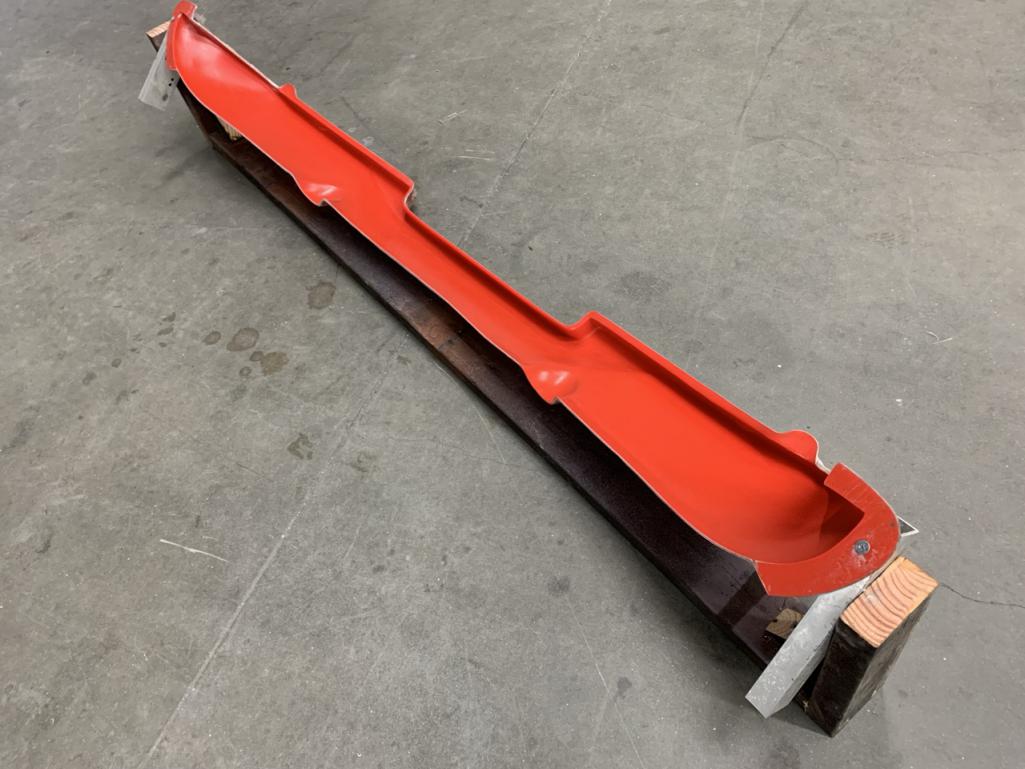

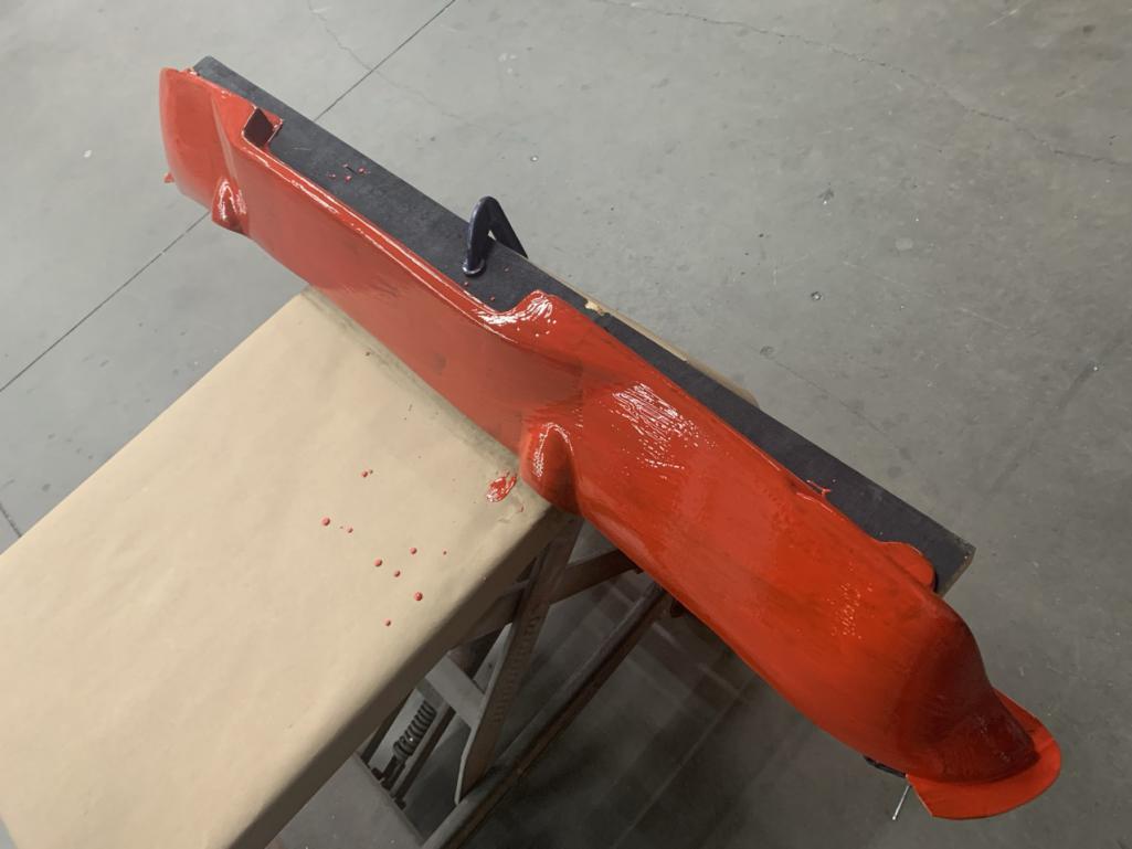

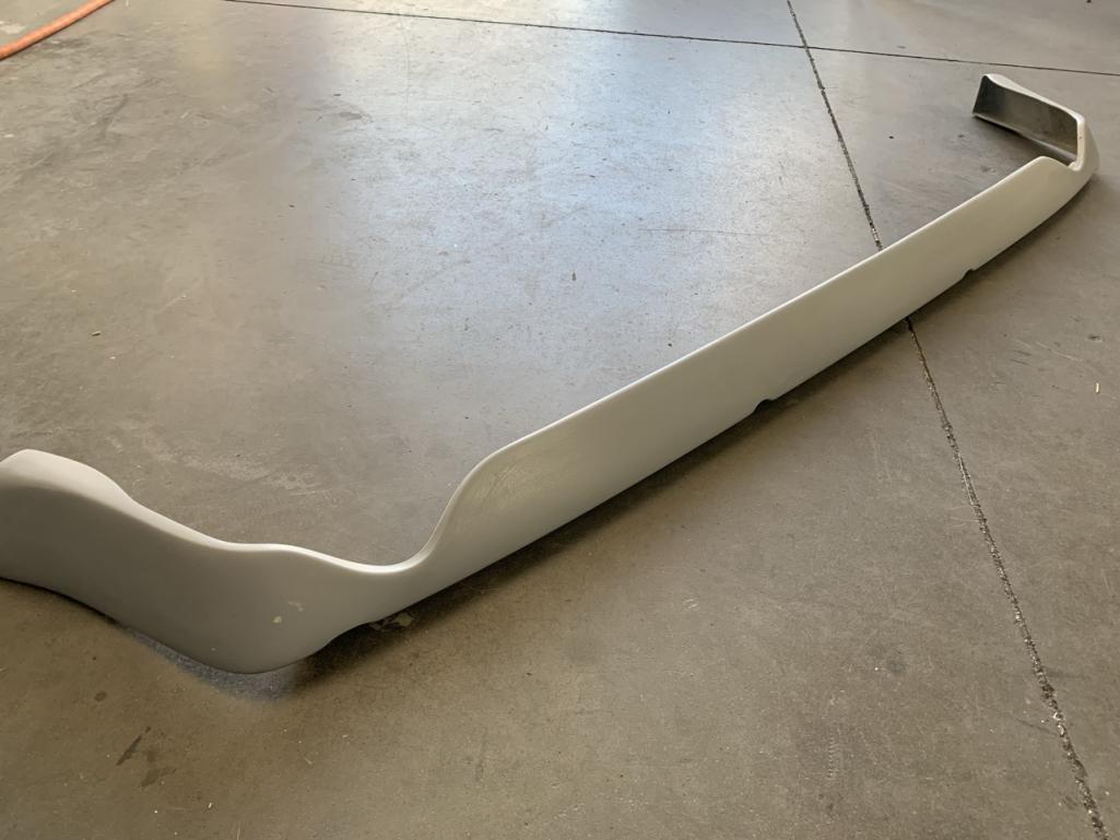

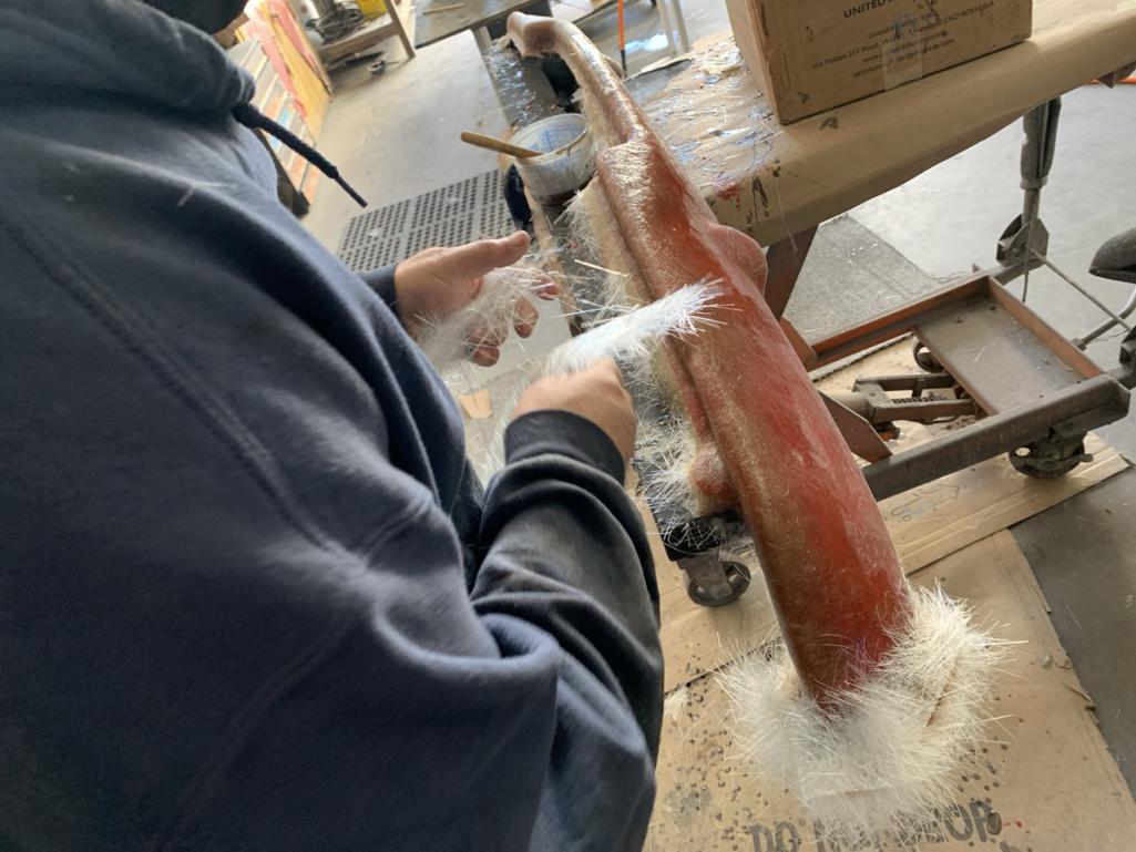

I went a different route than Bens rockers, though have seen these elsewhere and their solid.
If you would like to go fiberglass, I was unhappy with the quality that was out there. We have a fiberglass modeler on-staff, and it took him (a professional) something like 40-60 hours to shape sand and fit mine. See my build thread for more info on the 'how and why'.
Because of that, once finished, we pulled molds of the finished product, PM me if you're interested. I have yet to fully 'put these out there for sale', but the time is right now.

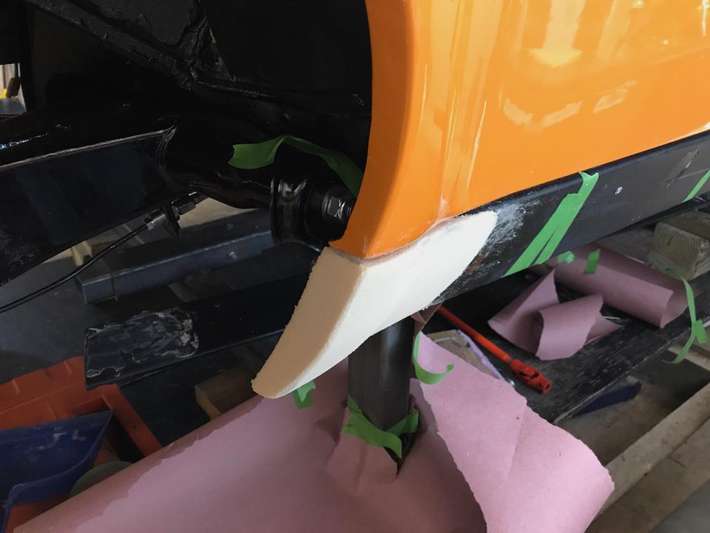

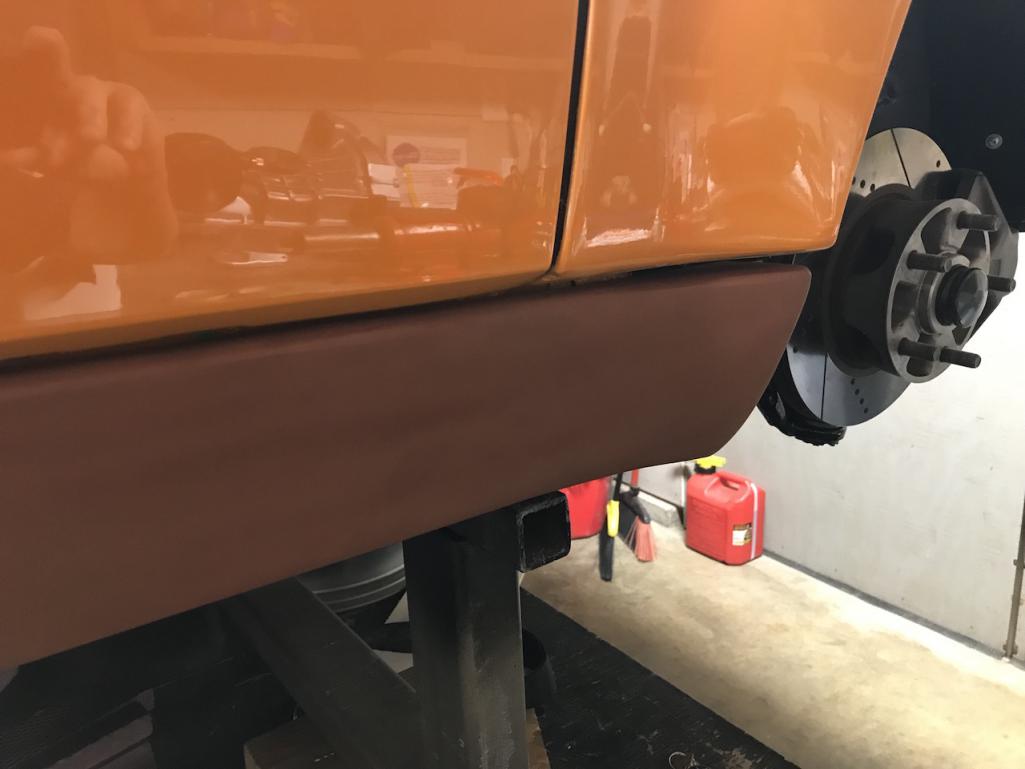

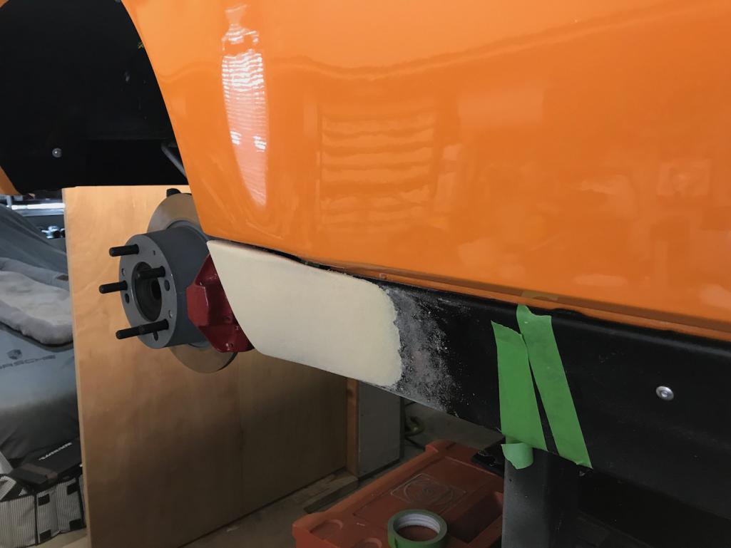

I also went fiberglass on fiberglass rockers. Glue on sculpting foam, sculp to fit and glass over. Sand and paint. Works great because it will match your flares to a tee. MarkAttached Image Attached ImageAttached Image

After my message on this, getting a variety of PM's about rockers and valances. For anyone interested, copying and pasting response here for anyone interested (not trying to spam-post or take-over this thread).
Anyone interested can find most recent photos on my build thread. You will 100% need to fit them to your car as with all pieces. Every car / welder / flair is different, though I can offer a better product that isn't warped. Suggest that these are purchased before fabrication.
Main issue is that it appears other vendors are using a 'chop method' and pulling the parts out quicker - making them less resilient and poorer. My guy, who is a professional, spent alot of time on mine just to get them to a good baseline. Info on this on my build thread starting around page 44-46.
Anyone who is interested or wants to see more photos, email me and I have more photos - too time consuming sharing here - eallenmar@eamandco.com (IMG:style_emoticons/default/bye1.gif)

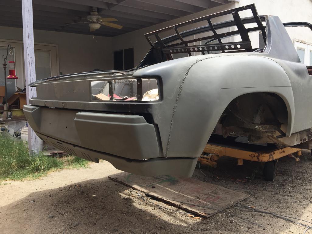

If you are adventurous it really was not that hard to flare the stock valance. Once the flare is installed you can make a template right off the bottom of the flare for the new top plate for the valance that has the right shape. I went slow

QUOTE(Shivers @ Apr 27 2025, 11:09 AM) *
@cosm3os
Is that some sort of cutout / detail I see in the center of the valence? Love it.

QUOTE(RiqueMar @ Apr 27 2025, 12:57 PM) *
@cosm3os
Yes. The plan is a recovery point.

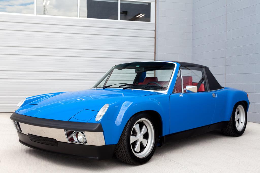

Not a GT replica valence but designed for flared cars. I personally think this is a very nice valence integration, although never seen on a factory car. The devil is in the detail. The lack of gap between the bottom of the bumper and the valence adds to the clean finish.

Isn’t that the Patrick Motorsports front valance?
Montreal914
post Apr 28 2025, 08:22 AM
Posts: 2,213
Joined: 8-August 10
From: Claremont, CA
Member No.: 12,023
Yes it is. It bolts to the underside of the bumper.
I have one in my rafters and was thinking to actually modify the flared ends to fit a narrow body car. Way too many projects on my plate... (IMG:style_emoticons/default/rolleyes.gif)
