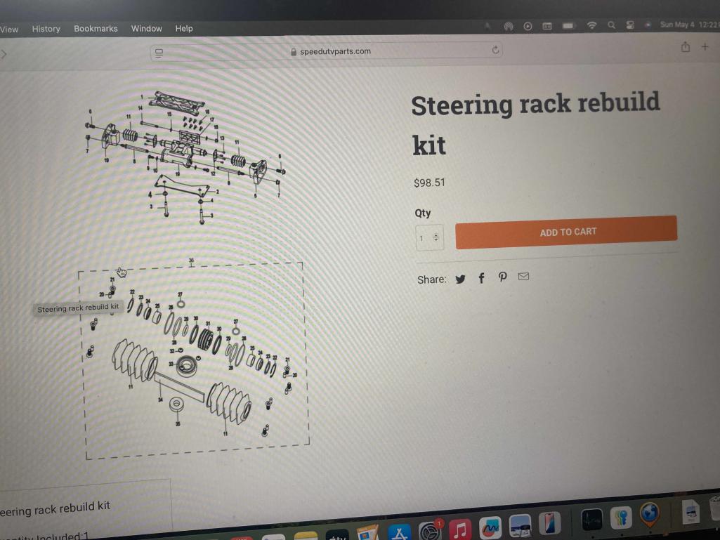

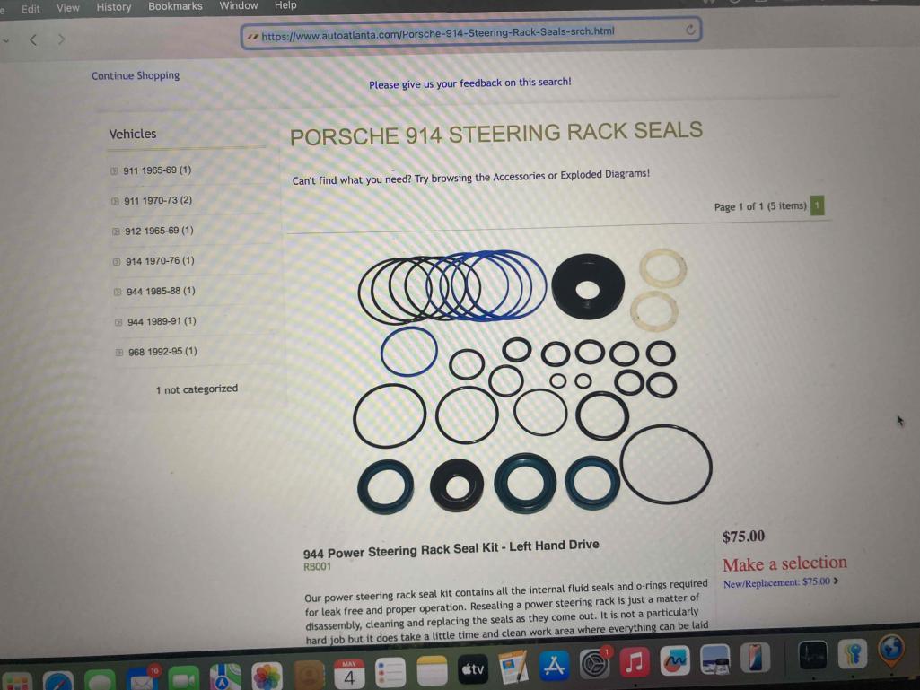

I was able to locate a couple of possible sources ,Pelican , Auto Atlanta but these just seem to be seal replacement .
Also this one I found on Goggle search but not sure until I contact them if it fits for a 914.
Pelican also has a tech article that states its not that hard and a brief review looks like he might be using 911 parts ?

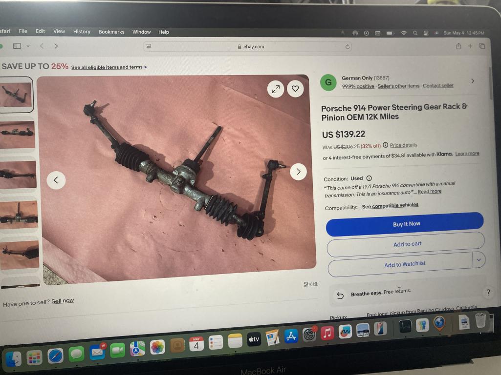

I just purchased this ,hope it wasn't a bad purchase . Juist did a bit of research I should have done first and this will not fit my car .Hopefully Ebay/seller will allow me to cancel this .

QUOTE(Ron914 @ May 4 2025, 03:48 PM) *
Why won’t it fit your car?

QUOTE(mepstein @ May 4 2025, 03:02 PM) *
It came off a 71 car , when I checked fit against my 76 car it said will not fit .

QUOTE(Ron914 @ May 4 2025, 04:59 PM) *
I'm no steering rack expert but I've always understood that all the racks will fit any year. I would do some more research before you give up on that rack. That being said, it's not a particularly great price for an unknown rack.

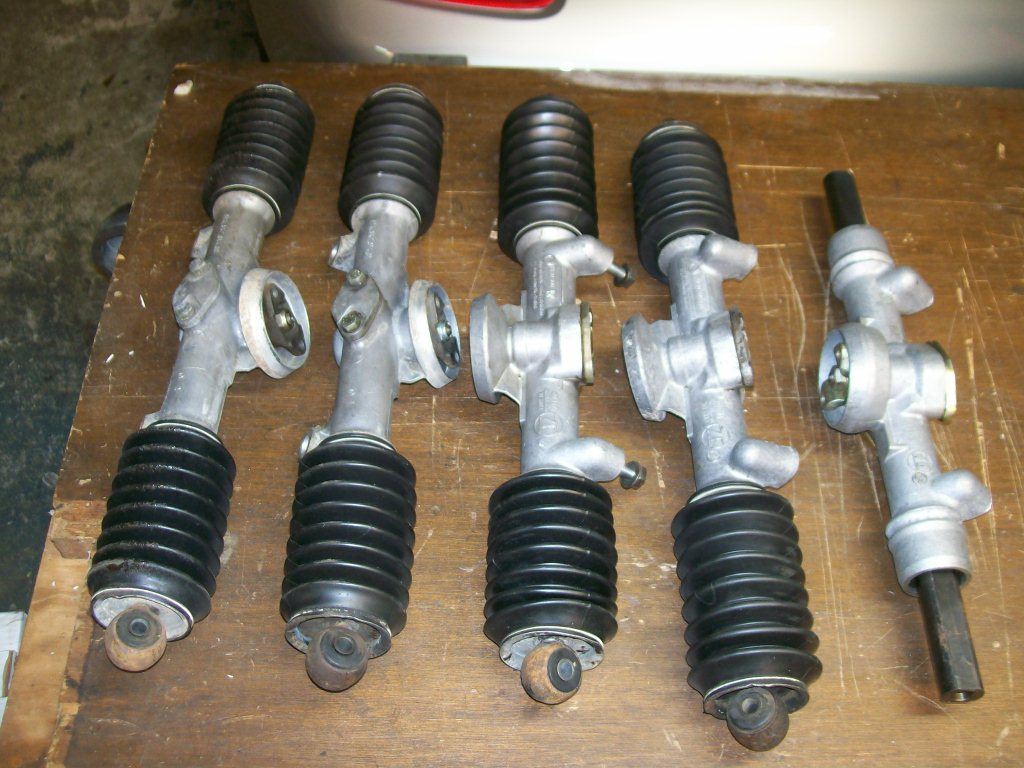

I have two 914 steering racks and two 911 racks . Ther 911 ones have "ZF" on the casting and what looks like an adjustable pressure spring on one side . All measuring points and mounting points are the same. I also have a rebuilt one new . All are for sale if needed. I'll post pictures tomorrow. AlAttached Image Attached Image

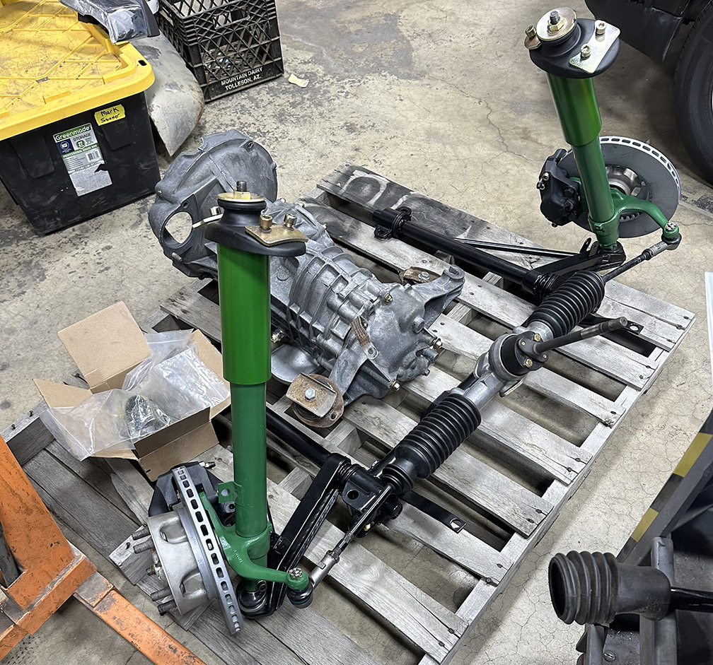

I've used 911 racks in a couple of cars waiting that's different is the length on the shaft under steering wheel one is too long. Can't remember which one but the racks fit. Picture is of the 85 Carrera rack I bought back in 2010 that we put in Marks Sonners 1974 car we call blue boy. 2270 Raby eng rebuilt by me and mark car finished by PMB Performance
