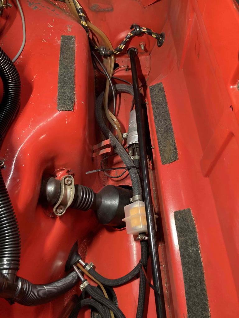

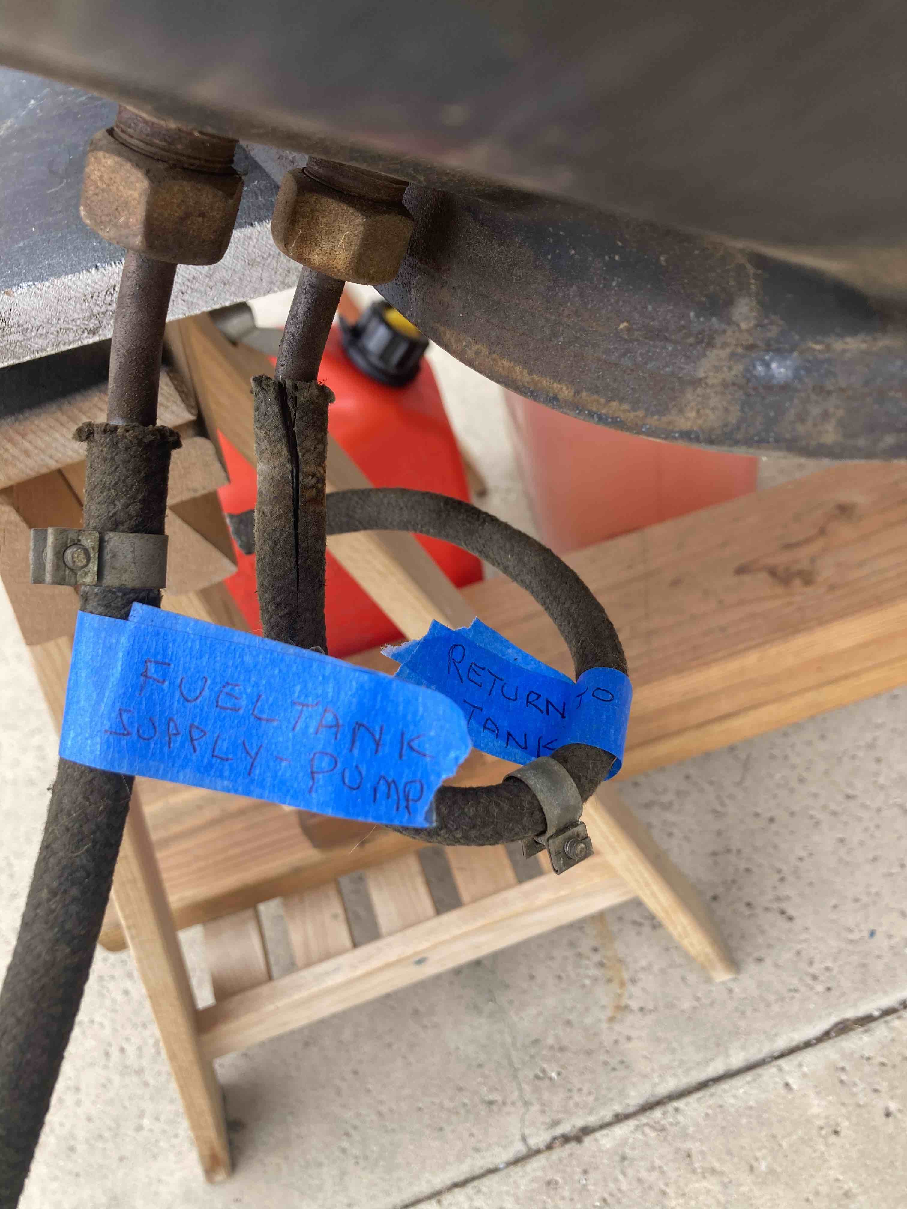

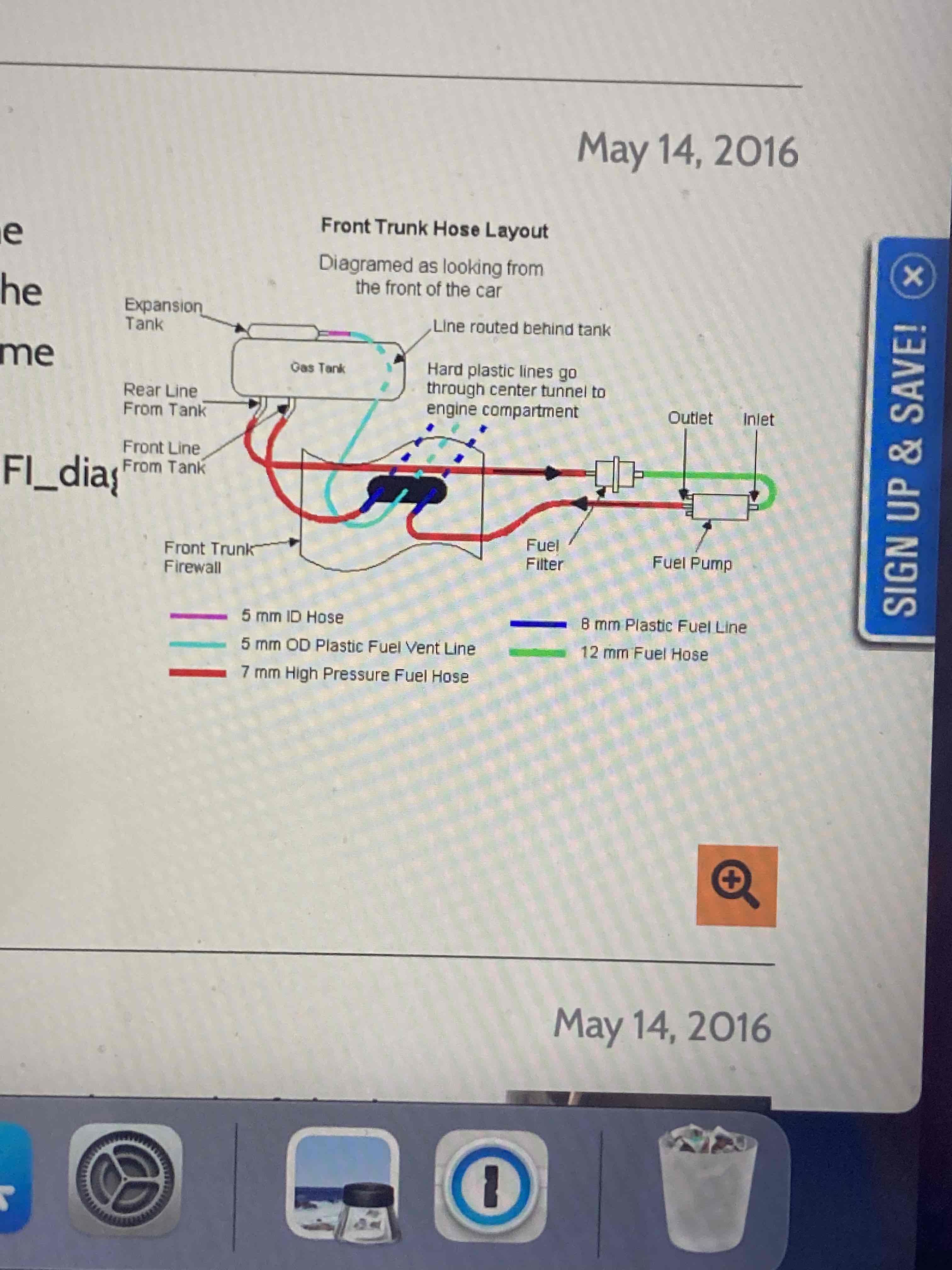

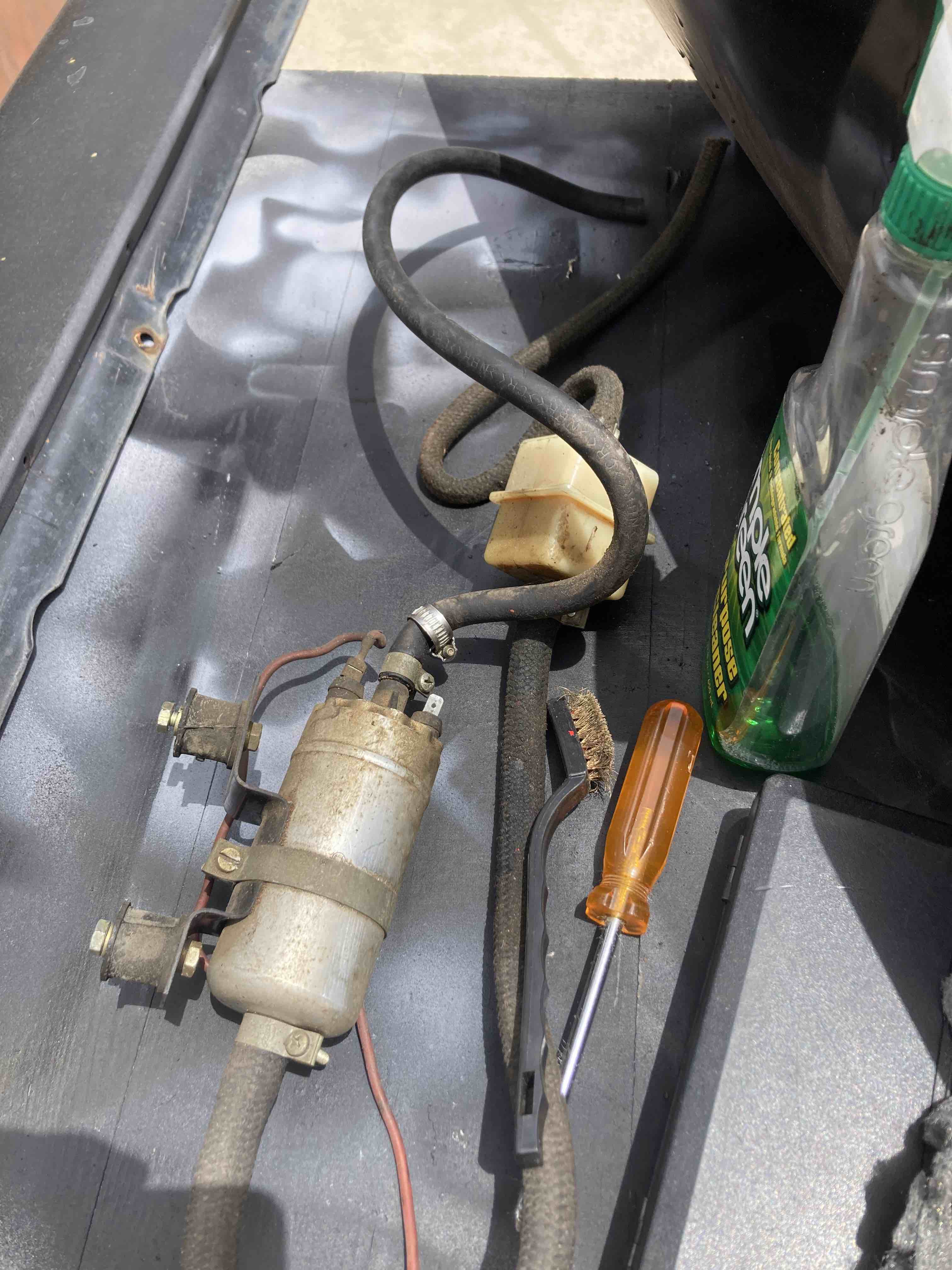

@NARP74
One of the first jobs I did was replace my old plastic lines with SS ones along with everything else associated for fuel.
The original filter has an 8 & 12 mm fitting this is because the supply coming from the tank is 8 and the inlet on the original pump is 12mm . Here are some photos that might help also I cut the hard to remove fuel lines with a razor knife to remove ,makes it a lot easier .New fuel line is not cheap and after market pump fittings are different than original .

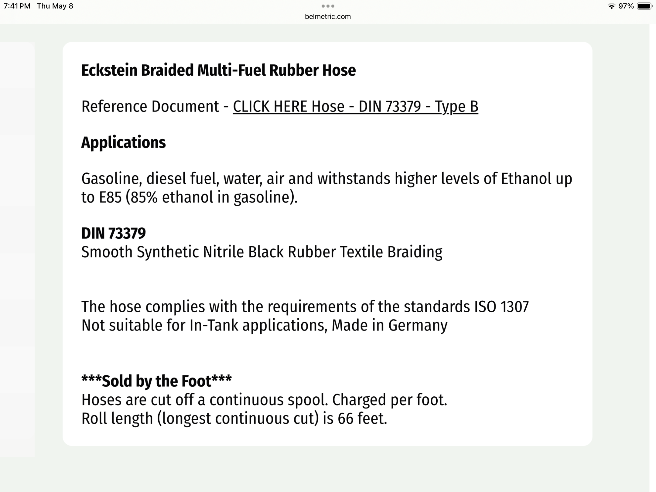

Get rid of those cloth covered lines. Use a quality fuel hose and its a job you only have to do every several years. The cloth lines need to be replaced far more frequently.

I am replacing all the lines bit by bit with the Belmetric real metric lines. The pics are not from my car...

I have to say, I'm not a fan of the Belmetric fuel lines.
I bought some, and eventually gave them away. There was no way to tell if they were ethanol tolerant or not. In theory they are, but....
Fire sucks. Ant those lines will need to be replaced often if you use ethanol laced fuel.
