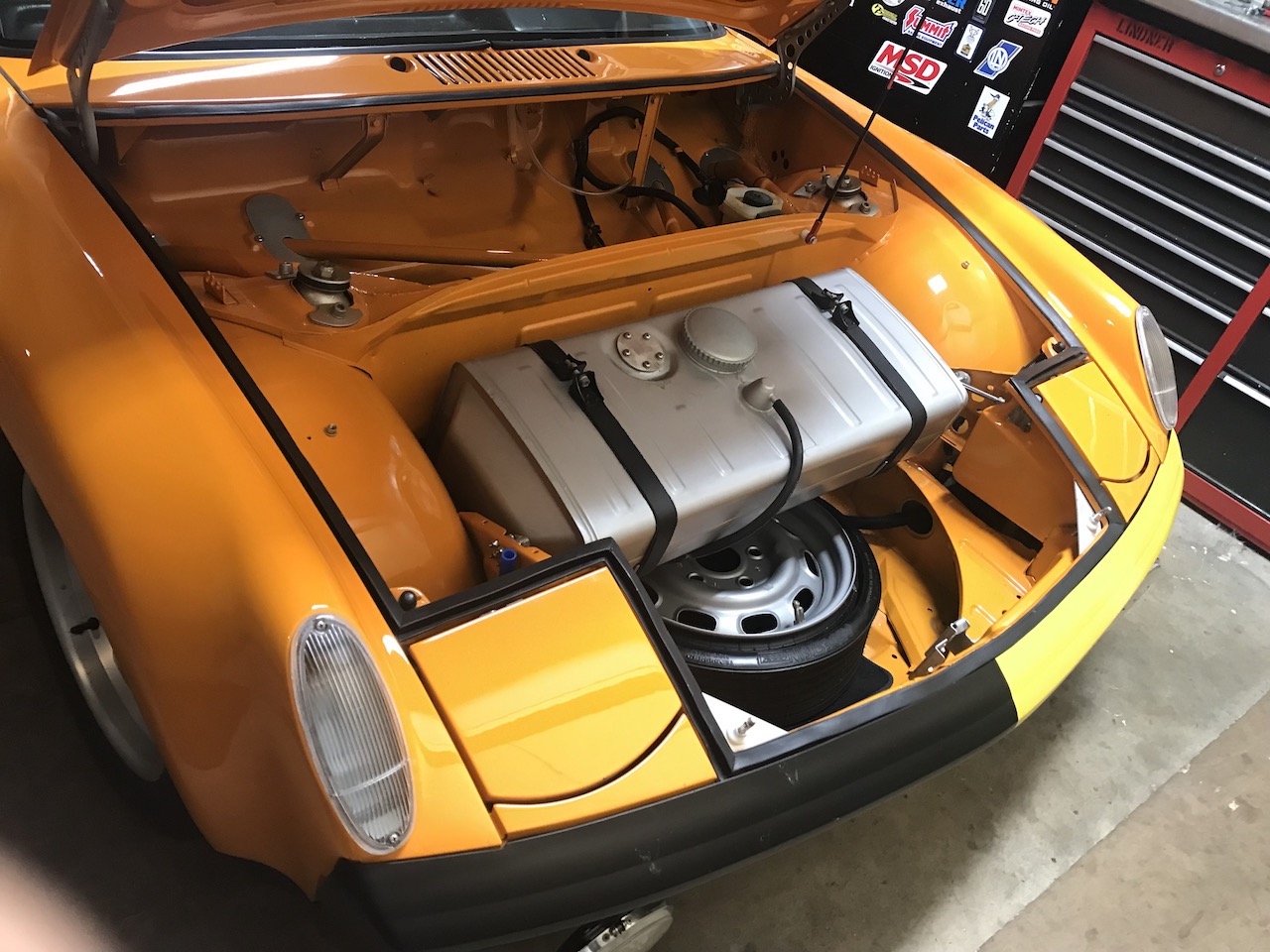

I also run 7 x 15 fronts with spacer and 8 x 15 rear. With a 15 space saver just in case.Attached Image

QUOTE(mlindner @ May 18 2025, 12:32 PM) *
Why do you have a 356 fuel tank in your 914??????

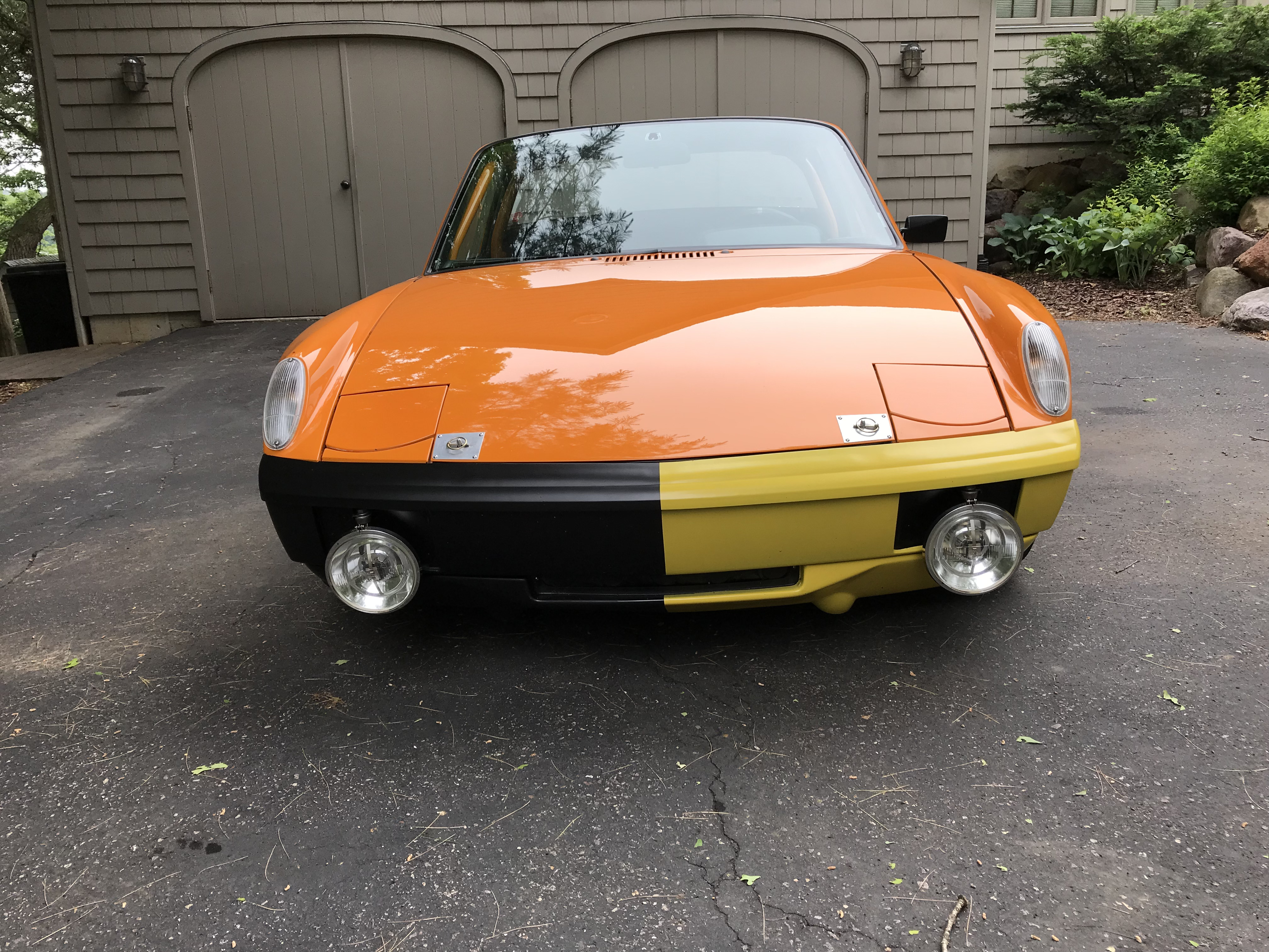

sixnotfour
post May 18 2025, 02:27 PM
Post #35
Posts: 11,153
Joined: 12-September 04
Member No.: 2,744
Show Us how those headlights work .... interested.

QUOTE(ClayPerrine @ May 18 2025, 02:55 PM) *
Hi Clay, 30 years ago when some of the work on my old 74 914 I was planing on a fuel cell and do more track time. Six years ago when the 914 came out of a 29 year nap the fuel cell.....full racing was out. So, you can see the extended cage to the suspension points and the forward placement of a gas tank was needed....356. Best, Mark

QUOTE(sixnotfour @ May 18 2025, 03:27 PM) *
Well, they don't.......30 years ago to much weight. so the front driving lights work but I am adding the Cibie Oscar hood lights this spring. I like to fabricate. Best, MarkAttached Image
