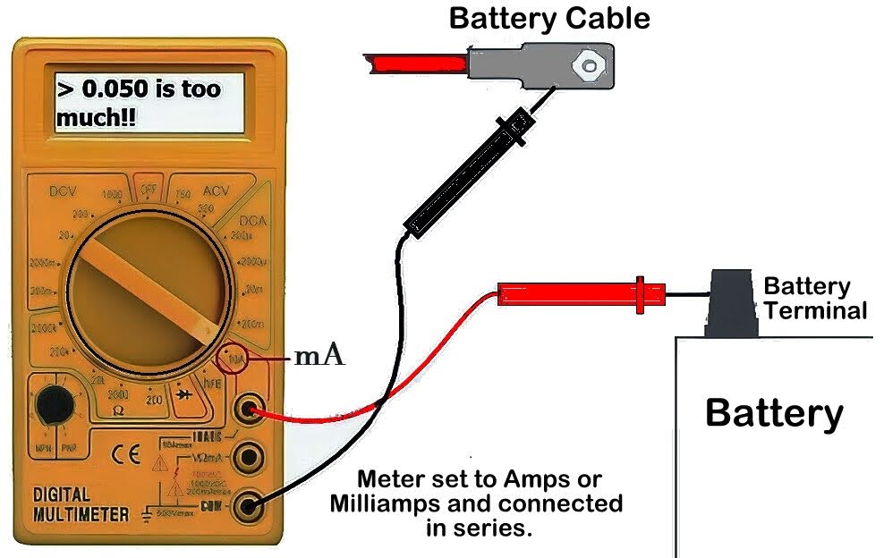

Any multimeter should be able to run this test and within a few minutes, you'll likely find a culprit when you start pulling fuses and relays. One at a time and replacing each one back in turn of course:

I was very excited to try RootWerks approach since I've had a parasitic loss that has been frustrating me for a quite awhile.
My meter is digital and does not have a mA setting, so I set it on 40 amps since the amps would be well under that. I carefully removed all fuses and relays one at a time and got a consistent reading of .75 amps. Disconnecting the red wires was pretty much the same, although it did get down to .5 amps.
So... since disconnecting things never made a difference, where does that leave me as far as finding this? I'm frustrated.

Oh boy, well, there's the starter and alternator. The heavy wires directly from battery to each. Unlikely, but could be one of them.
Did you pull the Voltage Regulator?
Other than components, could be a direct short in a wire which can be time consuming to locate.
Using a meter capable of measuring 40A to try to find milliamps of parasitic draw isn’t likely to be successful. Would depend on the specifications of the meter of course.
Get an appropriate DMM with 10A range and a 400-600 millliamp range.

Nope. Didn't think of the VR. I'll find a meter with the mA setting and try again. Thanks!
