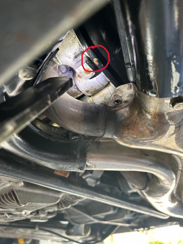

So I started the car yesterday. Ran it for a few minutes and then brought it on the lift and took a look to find the leak(s). For now, I really feel it is coming from the valve cover gaskets. I was actually able to see oil dripping from there so I will try to get this to seal first and then retest everything.
Should I get a new gasket or I can reuse the one that is there if it is still in adequate condition. I used Victor Reinz gasket.

I don't know what material the Reinz gaskets are made from, but I’ve reused the cork gaskets many times without issue.
Maybe the cover is just upside down? (VW logo should be upside down).

Gasket is made out of cork and was brand new when installed so unless I see major damages, I will reuse it.
I knew about the logo needing to be installed upside-down and I tried to respect this, but the logo on my cover is pretty hard to see. I will take a good look at it when doing the work.
