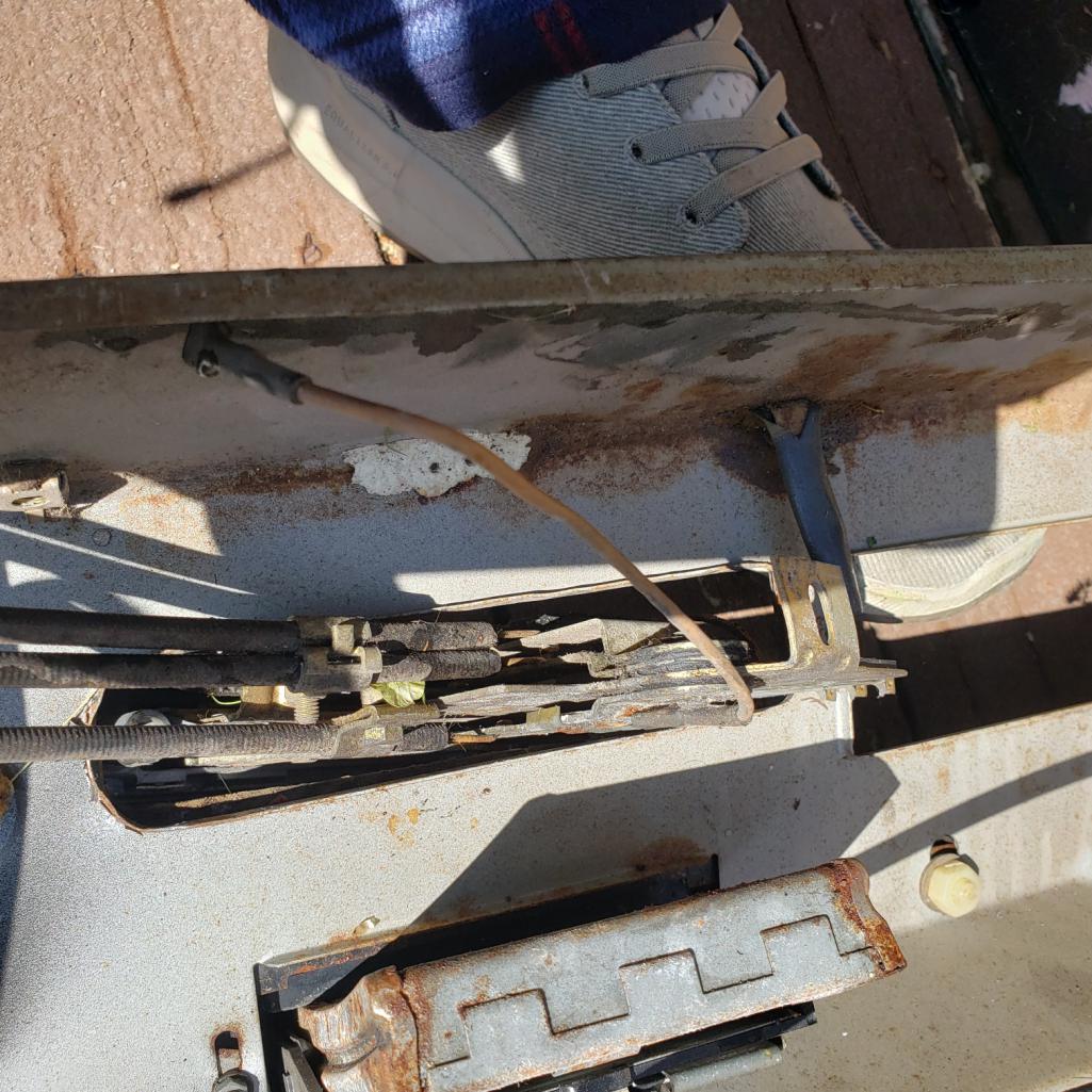

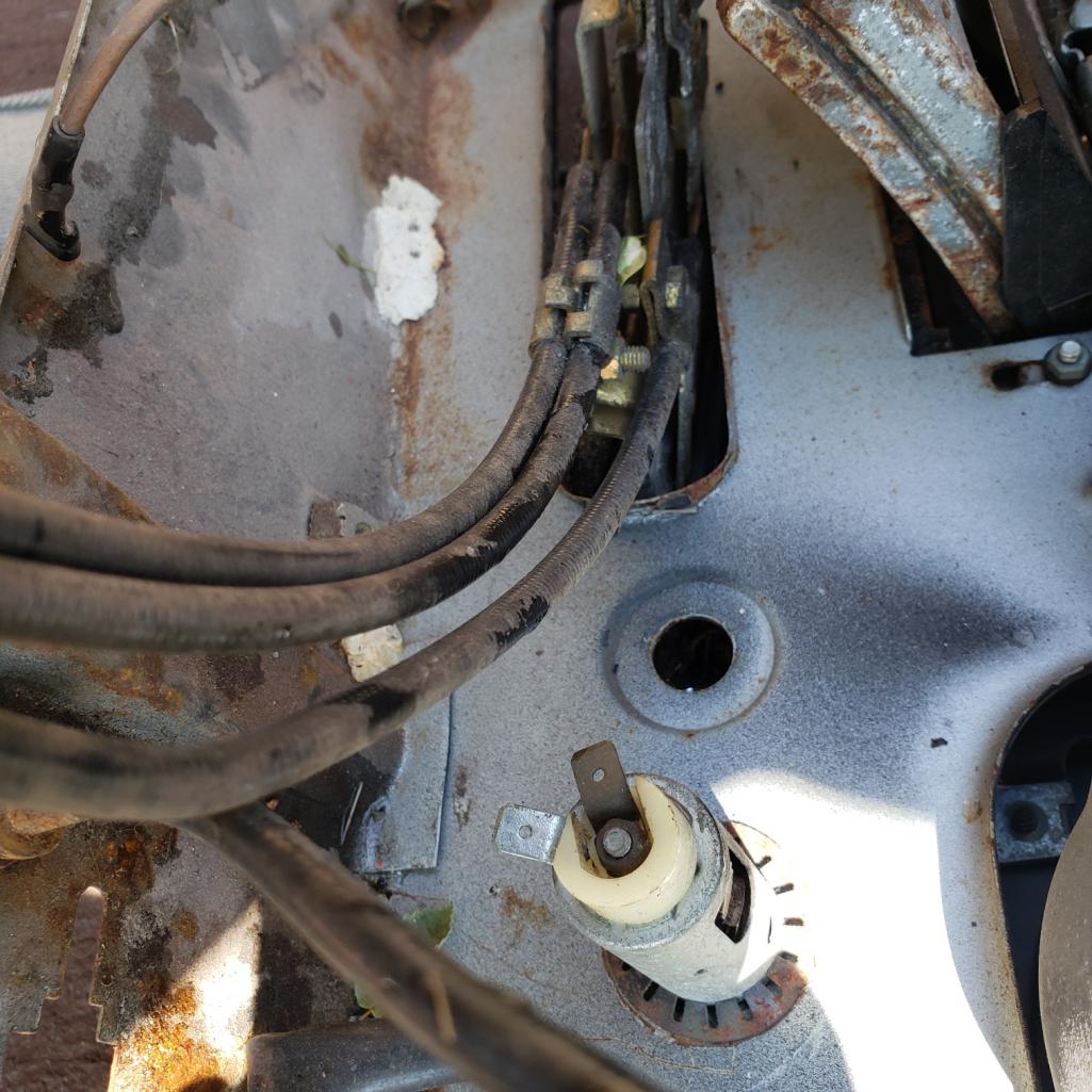

I want to pull the fresh air vent control out. I have all three boudin cables loose. Even so, the vent controls is not coming out. The right end hits the opening edge.???

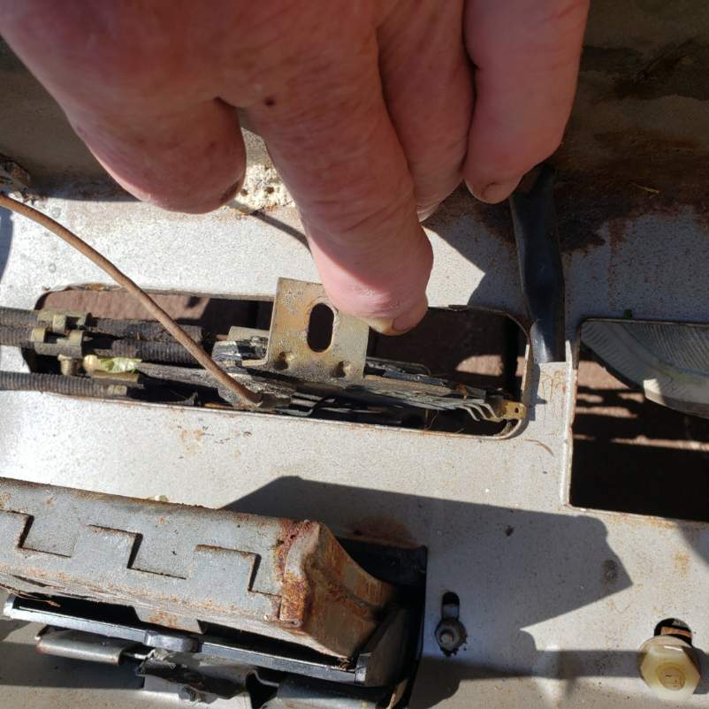

@jim_hoyland
tip right side out
slide to the right ...so the wire terminals clear, left side.. it has to tip out on right side to clear the light socket, then it will move more right
then will maybe come out... You can see someone been in there and bent the opening (common)
