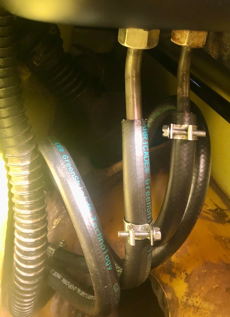

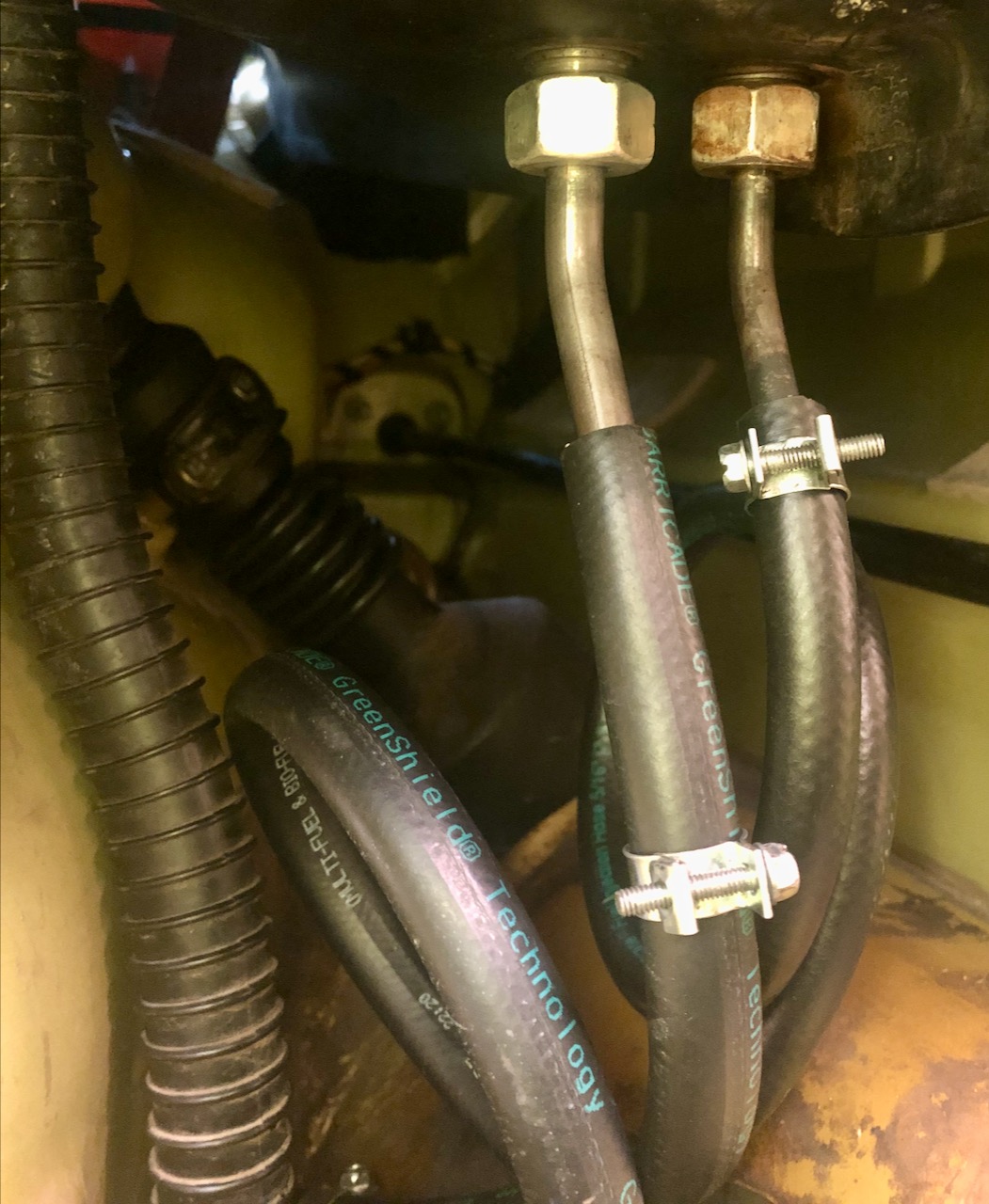

> Is this enough twist under the tank?
s13u74cr4
post May 18 2025, 04:30 PM
Posts: 26
Joined: 2-September 23
From: PNW
Member No.: 27,558
Post pulling the tank and redoing the two lines, one was kinked by the PO and loose, I now see how difficult it is to NOT kink it. Had tightened the clamps and immediately upon getting it in realized that would not flow. Should the loop go into that larger hole or will what I have here be okay? I have 2' of both hoses.

That hose is very stiff. Using a tight radius can cause issues. Keep an eye on the bend and make sure it is not restricted.

Rather than doing a full loop twist the hose full circle so it spirals. With 22" lenght you can
Lift the tank high enough to access the tank nipples.

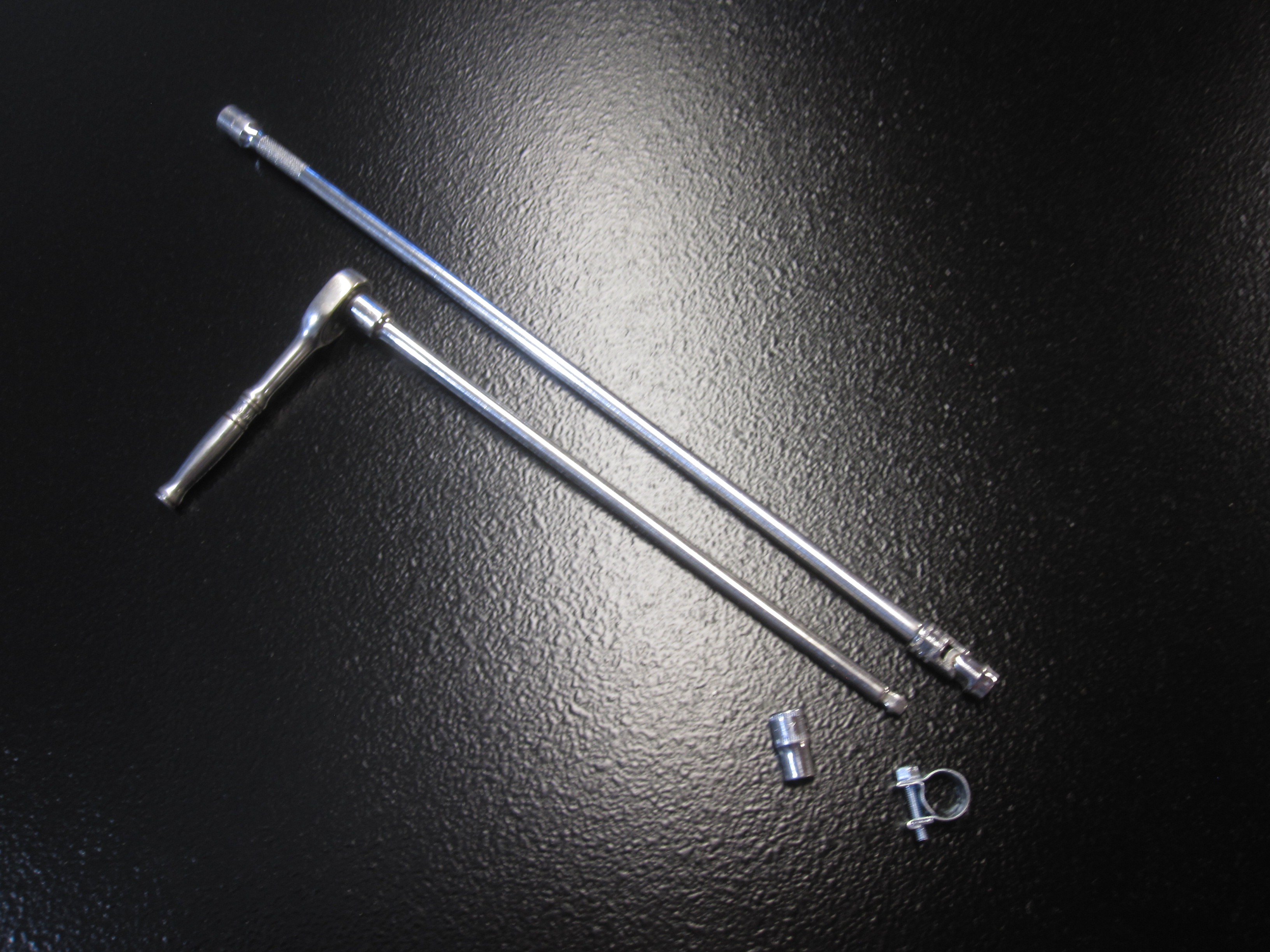

With your clamps a 12" 1/4" drive extension and a universal socket is your friend.
Or a wobble extension

Much more difficult than I would have imagined. Good thing I have long arms!
The Haynes manual, only picture I have found, shows them looped through that opening in the middle. Is that correct? Makes the physics of the twists easier for sure just seems odd.

I wrapped wire plastic protective sleeve around the fuel lines to prevent them from getting kinked under the gas tank.

QUOTE(s13u74cr4 @ May 26 2025, 01:05 PM) *
No need to make them too long ,even the best hose will start to fold over on the loops like yours has ,I pulled my tank to do a front pump change mounted on my alloy crossbar using Carter LP carb pump, lifted the tank up to measure the new hose length @ the minimum needed to avoid twisted kinked hose, think I did about 12'' of hose .
Rory nailed it with the means of loosening the clamps when your hoses are longer you can prop it up and reach up there ,real easy,cheers.
