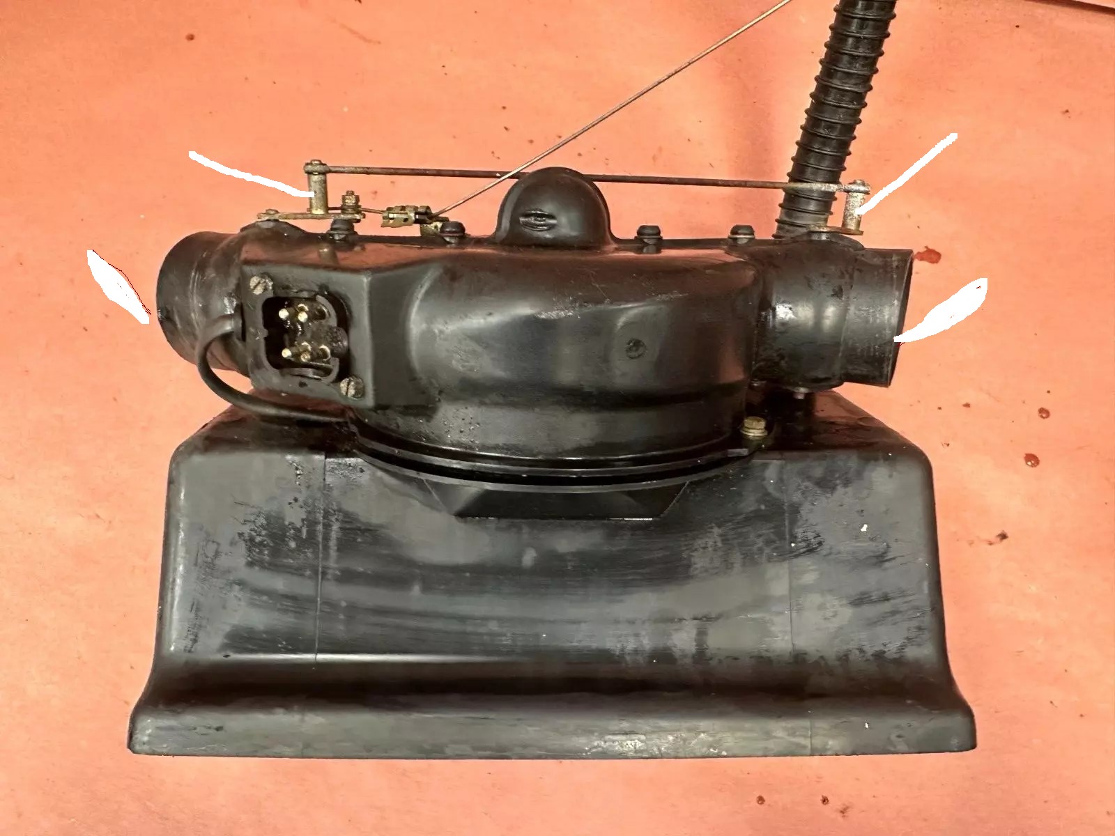

The flappers Should be closed when the red lever on heater controls is all the way to drive side....
I had the air box out awhile ago and when I got ready to reinstall I (thought) that I set the rod underneath so that they closed and opened on both side at the same time.
HA HA on me.
One side closes and the other opens. HUMMMM no wonder I get blasted by heat no matter when the dang slider is.
How to I adjust this with the cable? or that damn rod?
that is a pic I grabbed from the interweb, Mine is in the car.
Help Please
feeling not so Hndyhrr right now.
Thanks

The heat flapper boxes work as they are suppose to.
i guess my question is the flapper things inside the the air box. those should both turn in the same direction, either both open or both closed. Mine .... one side open on side closed.

QUOTE(hndyhrr @ May 19 2025, 08:09 PM) *

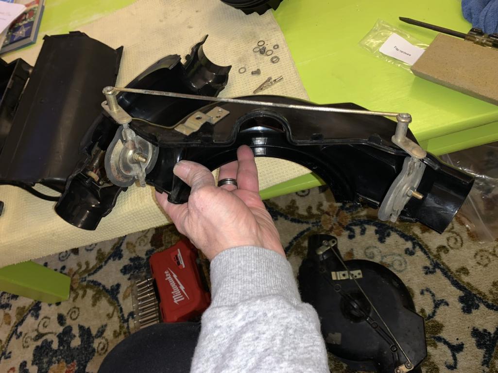

They should both be open and close at the same time
Someone has jacked with your box
Fixing in car (IMG:style_emoticons/default/confused24.gif) - never tried it and access is tight and visibility is terrible. I personally don’t think it can be done in car.
One of the flapper door levers is 180 out. Been years since I’ve had mine apart for a complete rebuild. If I recall you have to split the fan housing to be able to get the levers in the same orientation
Not my photo but hopefully helps you see what needs to be done. Attached Image
