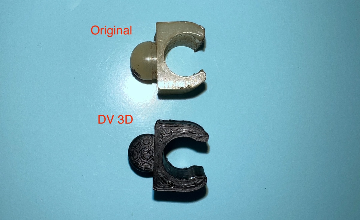

DennisV
post Jun 6 2025, 07:53 AM
Post #27
Posts: 867
Joined: 8-August 20
From: Santa Rosa, CA
Member No.: 24,575
QUOTE(Cfletch @ May 27 2025, 10:51 AM) *
Not aware of the clips and will look into them. Any photos handy illustrating where they are located on the body would be appreciated- Thanks!
I bought used VW clips off Samba and they were identical. If you get in a jam, let me know I can 3D print serviceable ones.
Cfletch
post Jun 6 2025, 10:08 AM
Post #28
Posts: 231
Joined: 30-January 14
From: Santa Barbara
Member No.: 16,941
QUOTE(DennisV @ Jun 6 2025, 06:53 AM) *
I have some coming in the mail from some VW place in SoCal, if they end up not working I will message you for the printed ones. Thank you!

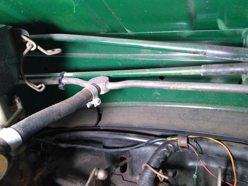

fixer34
post Jun 6 2025, 06:34 PM
Post #29
Posts: 1,399
Joined: 16-September 14
From: Chicago area
Member No.: 17,908
This shows one of the mounting clip holes, but I took the easy way when replacing the hoses way back.
