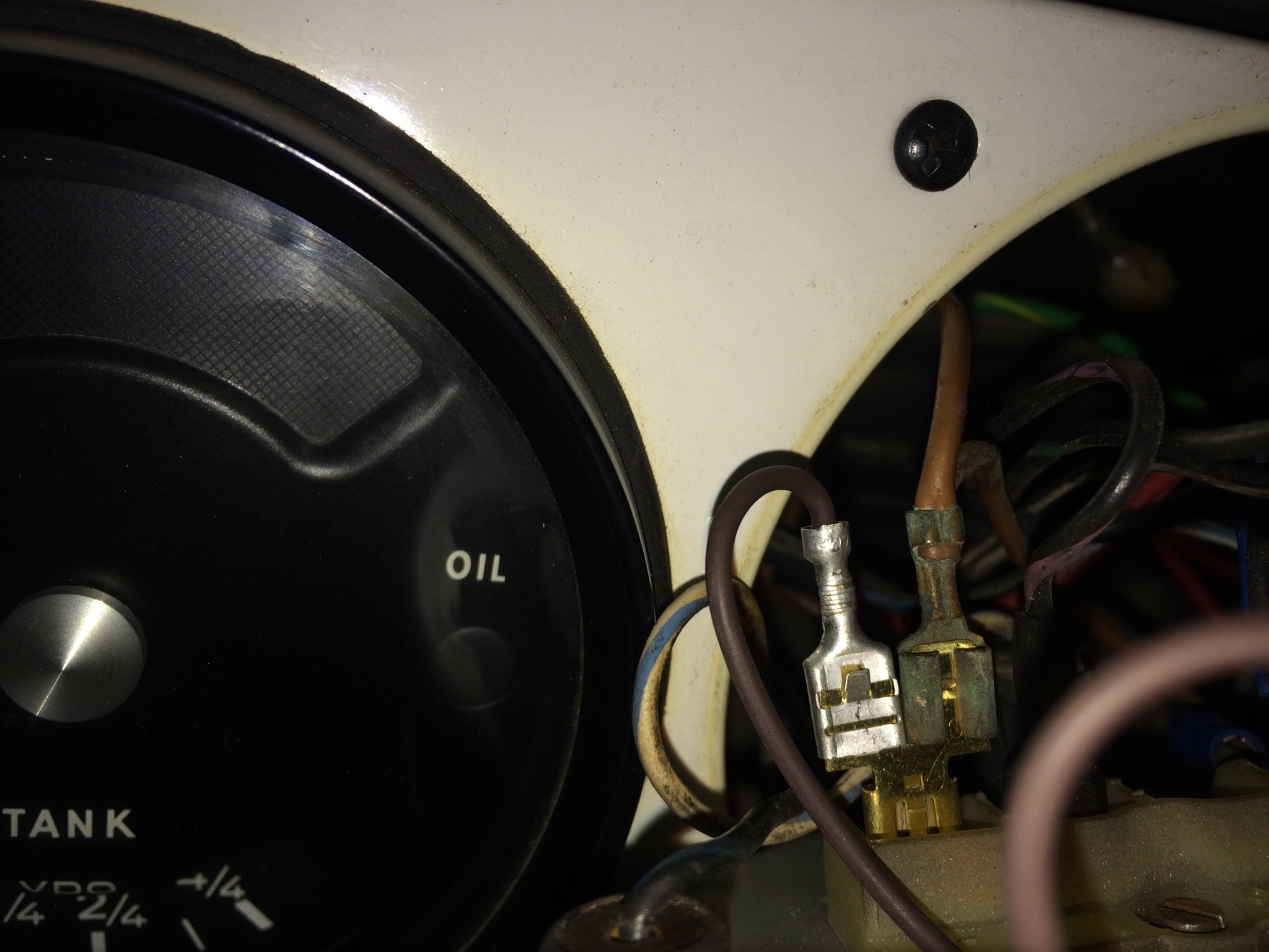

jUST A wag check that the brown wire is connect to the gauge case wich is ground

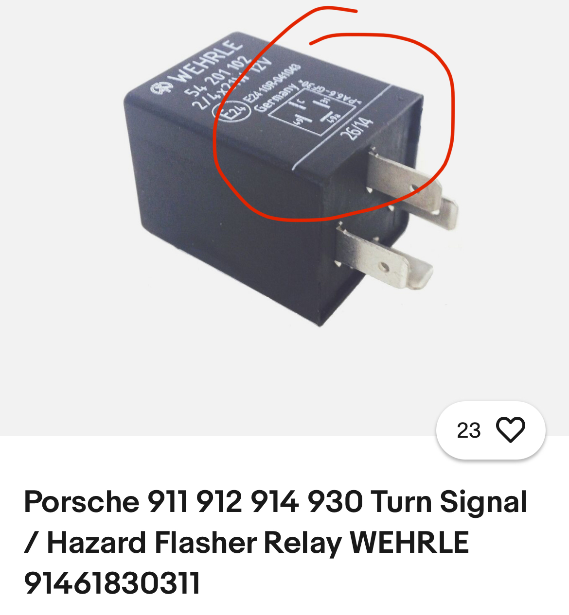

QUOTE(GeorgeKopf @ May 28 2025, 10:46 AM) *
Do you know which connector on the unit represents which wire on the diagram?
Also, both relays are probably 50 years old. Do they naturally go bad over time?
Germans are very good about putting terminal numbers on parts; either on housing or molded in by the terminals themselves
Relays are pretty robust devices - would be somewhat unusual to have two that are failed the same way but technically not impossible.
If your theory were true you could measure relay terminals with DMM and see if you have continuity between terminals “49” and “k” per schematic in post 3
Terminal k that is on schematic may show up on flasher relay as “c”
Likewise - follow Spoke’s advice as quick method as another valid way to help troubleshoot if the problem is coming from

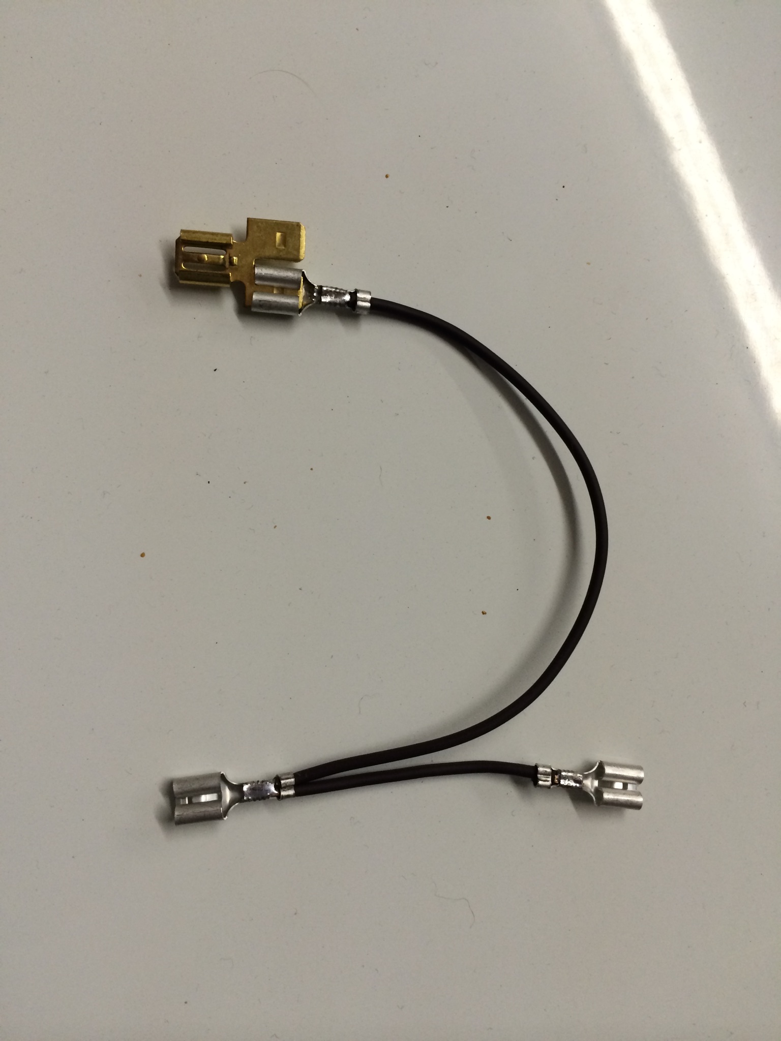

I would expect the indicators to be off with the relay removed. Quite honestly, I'd bypass the K/C/C2 pin on the relay and just ground the common connection of the indicators to the tach ground. I did this on my '71. I'm still using the OEM flasher with all LEDs with no issues.
If you do change to external LEDs the function of K/C/C2 is lost. K/C/C2 is active in the relays as a safety feature to alert the driver of a burned exterior turnsignal bulb. If a bulb is burned out, the relay will not power K/C/C2 during flashing and both indicators will flash together indicating a burned bulb.
An easy workaround which I did on my 914 is to remove the common wire at the indicators and tape them off. Then make a pigtail like shown below. The piggyback connector goes under the tach ground (brown wire) and the 2 female spades go to each indicator. The indicators will flash opposite (L on for right turnsignal; R on for lefts). This is easily fixed by pulling the entire light assembly out and put it in the opposite hole.
Here's spades for the mod. This is the ground piggyback connector. You need 1 of these.
Piggyback Spade
This is for the bulb spades. You'll need 2.
Female Spade

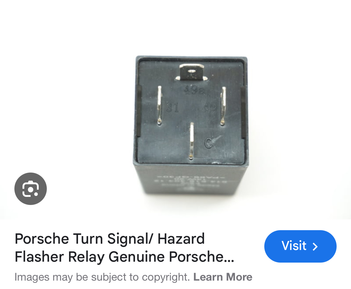

My flasher relay is only labeled:
....49
49a....C
....31.......(see below)
......................................Relay #1................................Relay #2
Between 31 and 49a:..there is no continuity..................there is no continuity
Between 31 and 49:....resistance is 812 ohms...............there is no continuity
Between 31 and C:.....resistance is 876 ohms..............there is no continuity
Between 49a and 49:..there is no continuity..................there is no continuity
between 49a and C:....there is no continuity..................there is no continuity
Between 49 and C:......resistance is 850 ohms...............resistance is 48 ohms
Lastly, I poked and prodded all the little switches in the mechanisms and some of the above numbers changed significantly.
Thanks.
George

I’d agree - short of trying to revive those, or to set up a complete bench test inclusive of incandescent lamp loads I’d order a new one.
....49
49a....C
....31.......
This is the same pinout as EP26. EP36 is the same minus the C pin.
Out of the box for EP26 the C pin is open and does nothing. I resell EP26 with the C pin connected to ground for separate L and R. For the single L/R indicator cars, the C pin is connected to 49 via the internal relay when active.
As mentioned before, the K/C2/C pin only has value for all incandescent turnsignals when it operates properly. If one installs LED turnsignals, the pin is worthless. Also over the years, the efficiency of the coil decreases (the large gauge coil in the picture) for K/C/C2 to the point where an indicator may flash once then both flash together.
Unless you really want the alert feature of the K/C2/C pin for burned bulbs, life is simplified by grounding the common connection of the indicators or installing EP26 with K/C2/C pin grounded internally.
