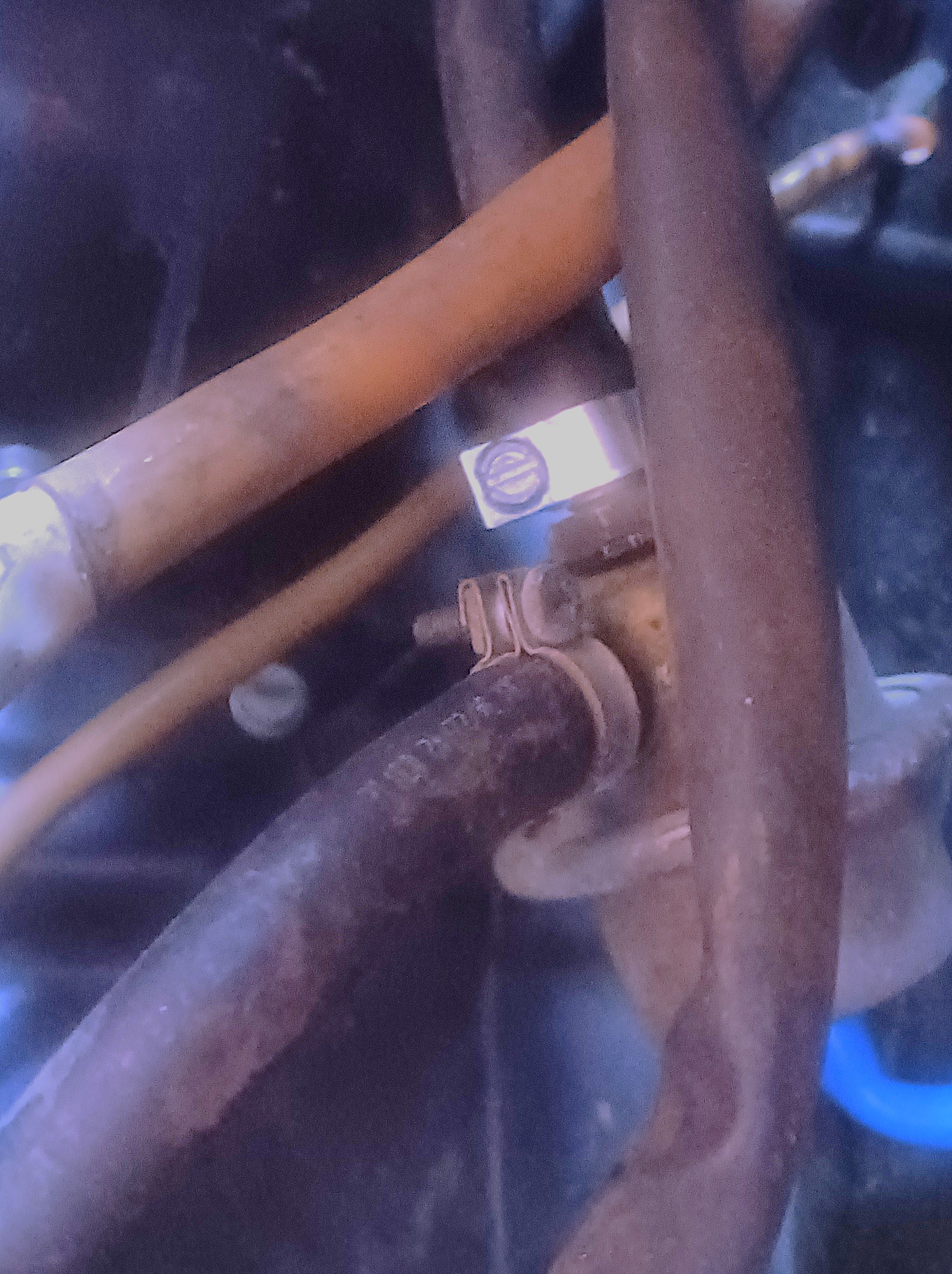

Finally have the vacuum lines sorted out and installed a new battery. Started right up, idled well and most importantly, it started right up after it was fully warmed up.
Took it for a test drive and it ran pretty well...until I started smelling gas! Luckily I was only a few blocks away and was able to limp it home. It ended up being the easiest FI fix, ever! The PO simply forgot to put a hose clamp on the fuel pressure regulator and the hose popped of. New hose clamp and a few minutes to install. Pic below.

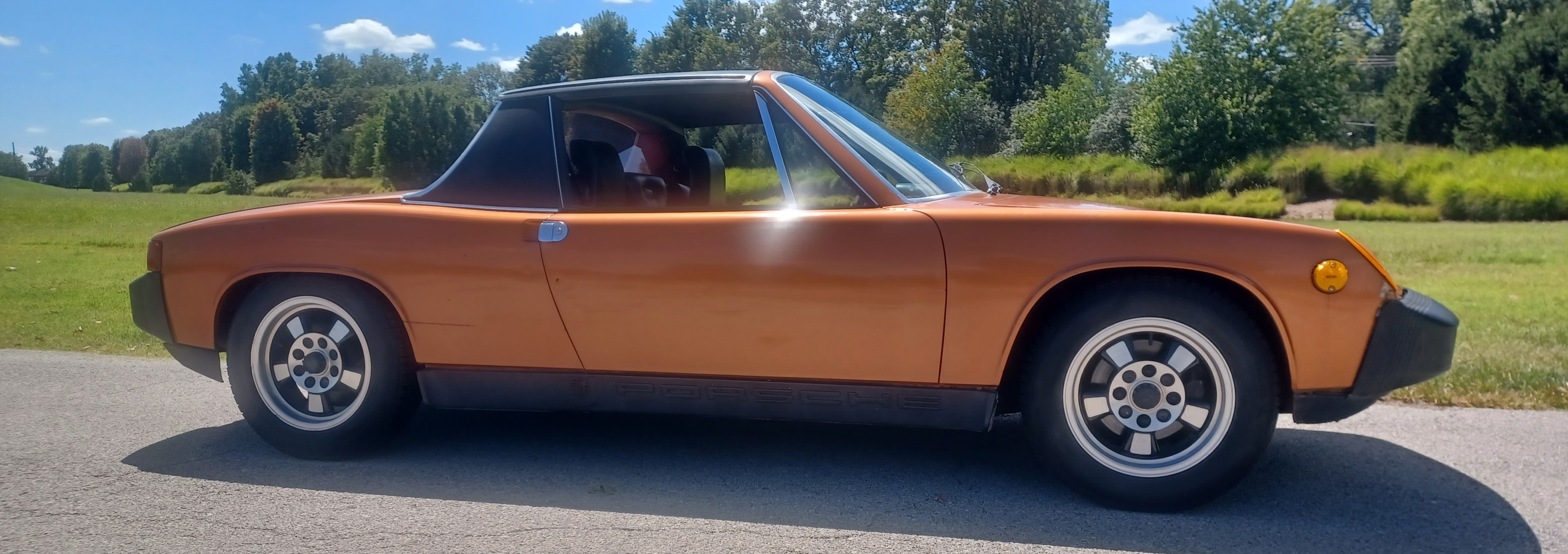

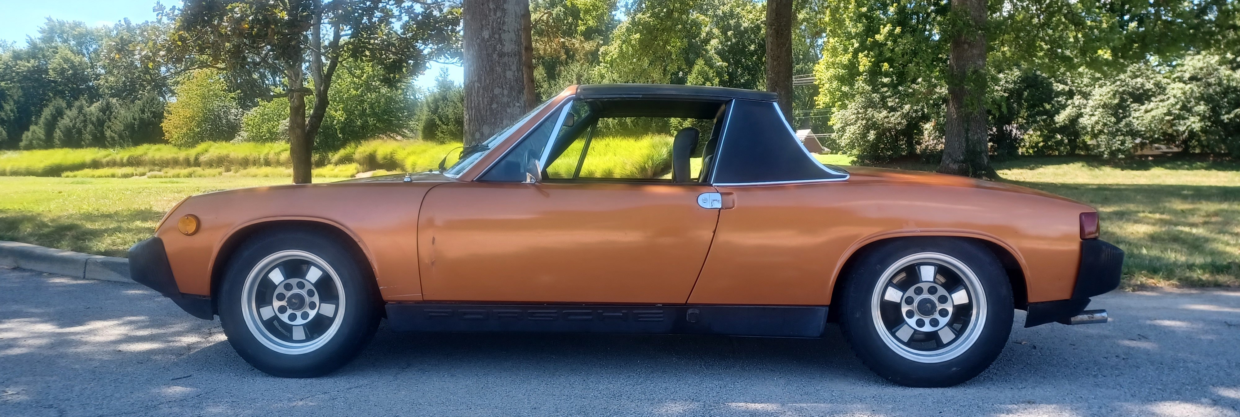

Snapped a few pics while out, which makes it look waaay better than the 10 footer paint on it should look!
